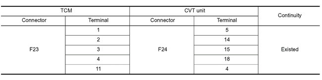

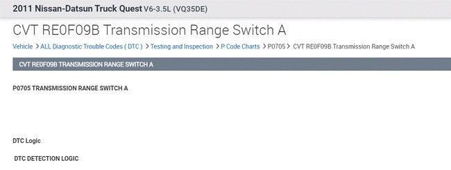

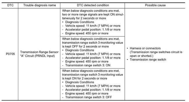

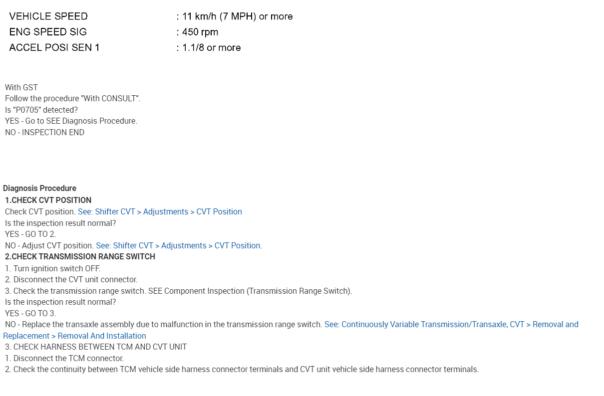

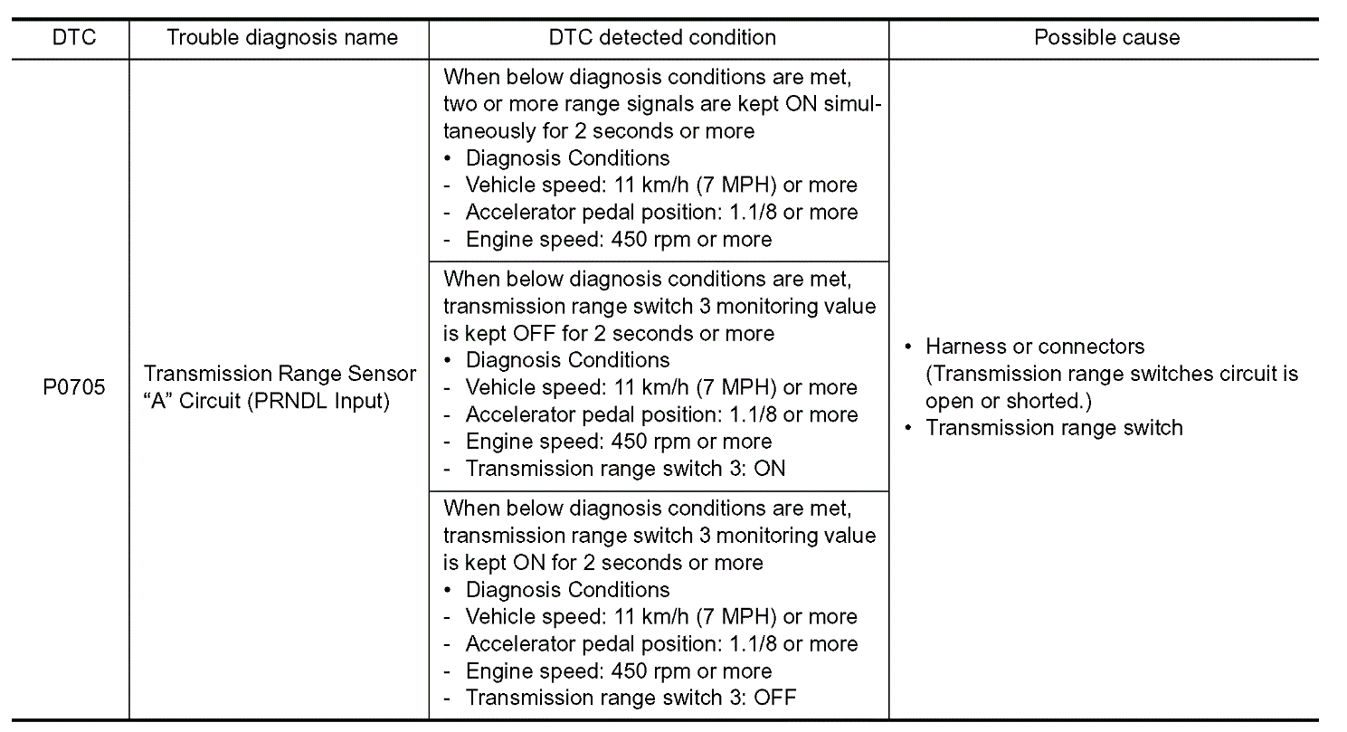

This code tells me the transmission range sensor is not working properly. The only problem i am having is that i have called everywhere and this part is not listed for the vehicle listed above. I just needed to know if i should call it something else or if I'm looking for the wrong part.
Thank you
Jun 6, 2022 at 7:57 AM
  • 110,244 POSTS

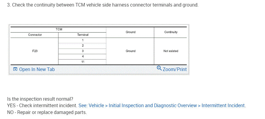

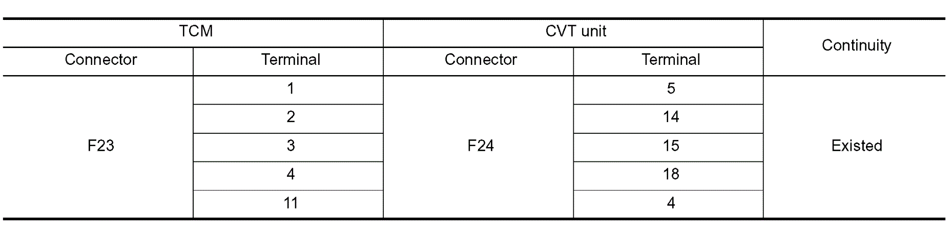

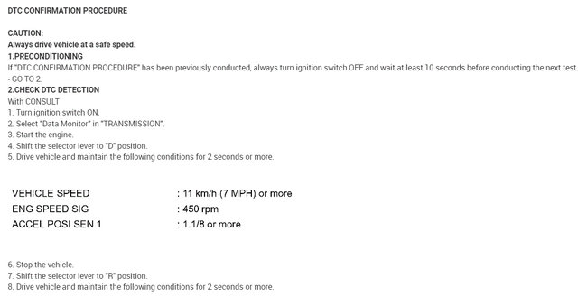

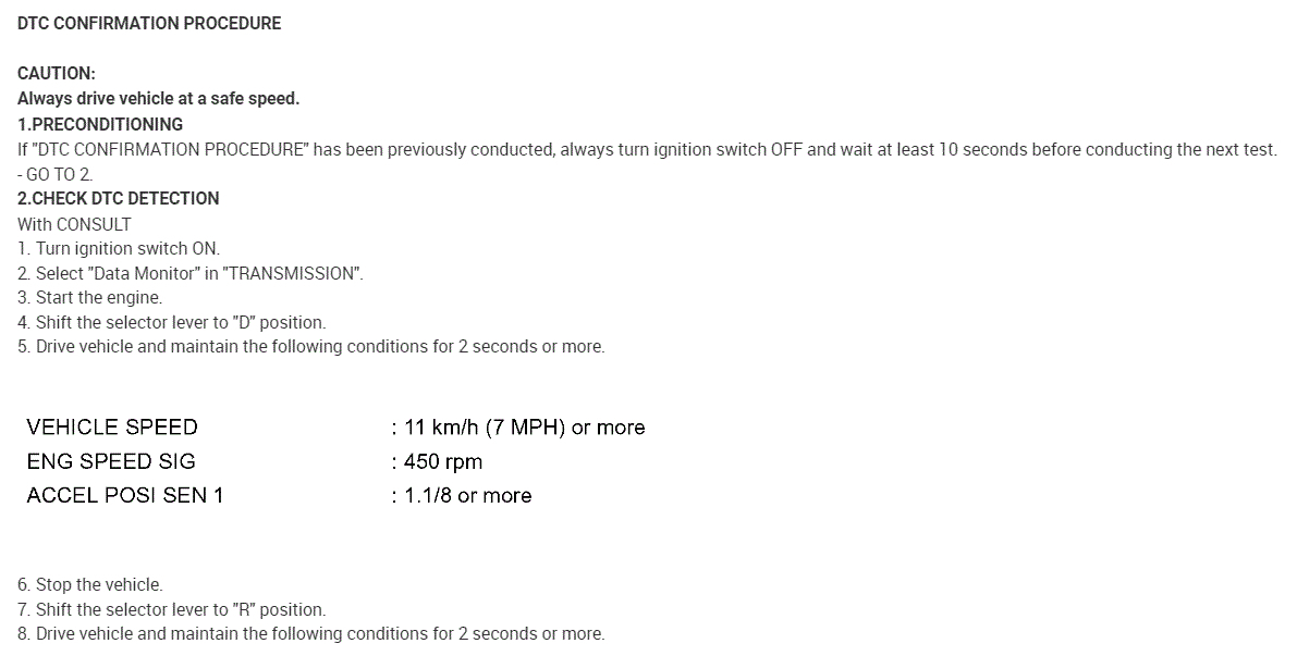

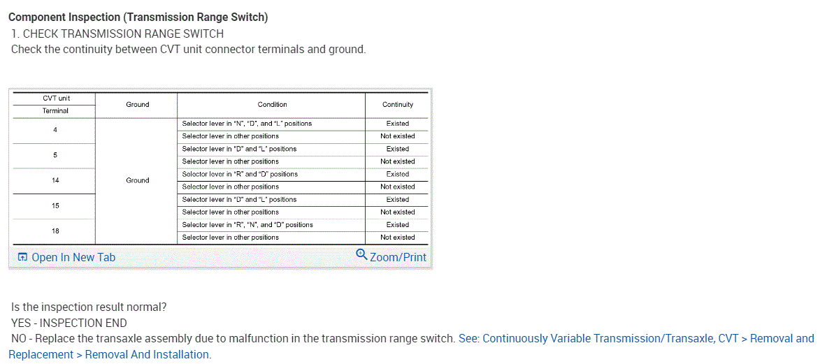

What you are calling it is correct. However, this isn't a traditional range switch. In this case, the transmission range switch is included in the control valve assembly. It's internal and can't be replaced separately.
Here is what I suggest. I attached the diagnostics below for the switch. Take a look through them and let me know if you are comfortable performing them. If you are, please do so.
