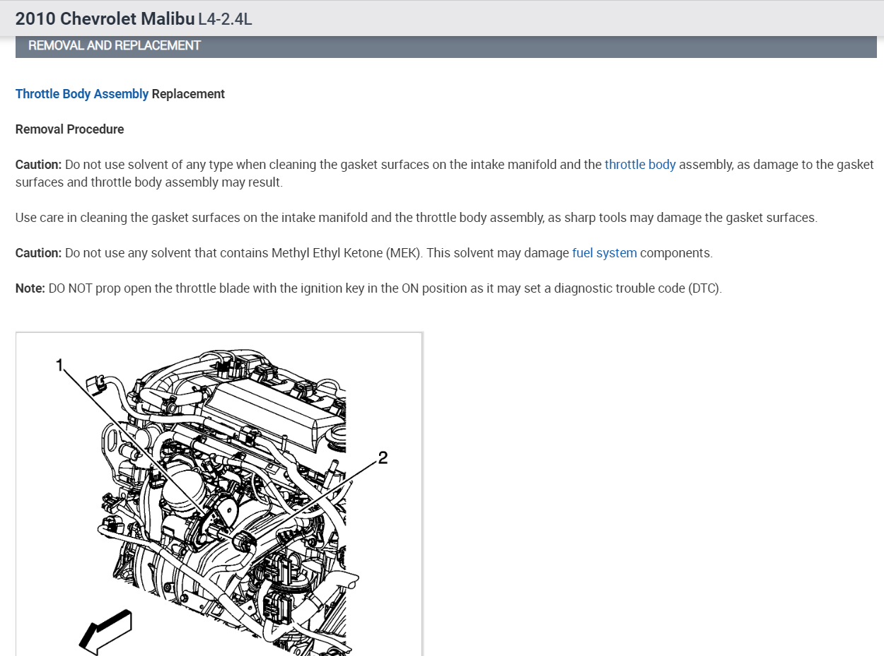

I'm getting code p0507 and p0014. Which i have visually inspected the hoses for any leak, but can't find anything. but the other thing that my car is doing is the idle is higher than normal around 3,000 RPMs.
Oct 3, 2022 at 4:57 AM
CHAVITO21
It started doing it right after i changed the throttle body. i disconnected the battery for at least 30 minutes. i did a different test where i let the car idle for 3 minutes and cut it off wait 60 seconds then started back again for 3 minutes. still doing the same thing.
Oct 3, 2022 at 5:06 AM
  • 55,399 POSTS

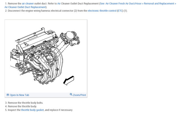

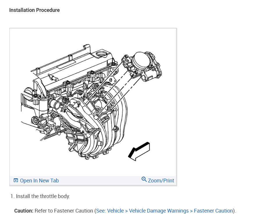

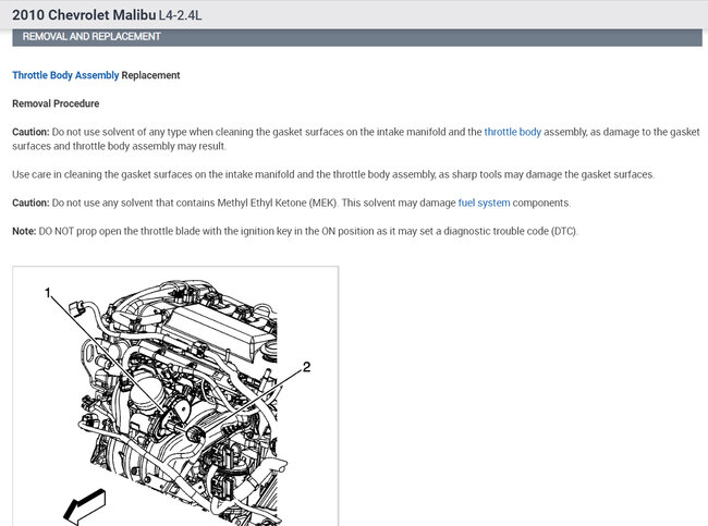

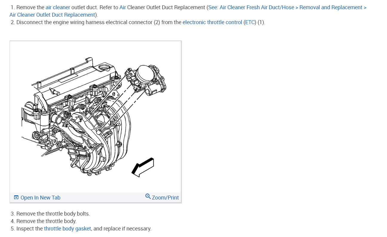

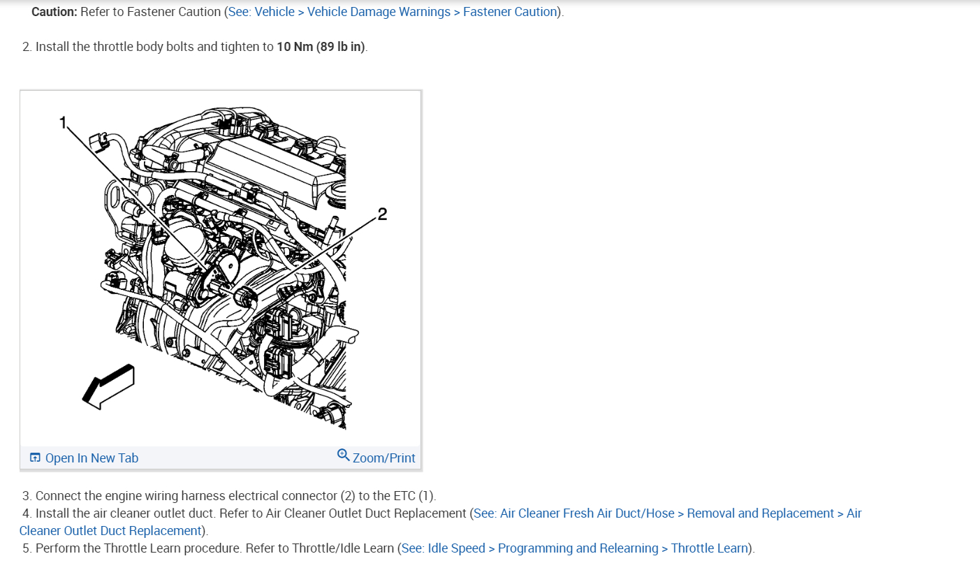

I see, thanks for the clarification, I would disconnect the battery overnight to reset the system here are the instructions on how to change out the throttle body in the images below. Also, you can try a hard reboot which is done by removing the negative side of the battery, with the cable loose from the negative side of the battery, hold it to the positive terminal for 1 minute this will discharge the memory capacitors in the BCM and PCM allowing the system to reboot.

Check out the images (below). Let us know what happens and please upload pictures or videos of the problem.
