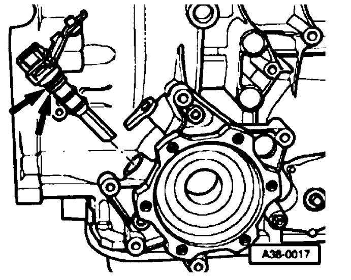

My vehicle listed above has one code which is P0501. I understand right around my car year they switched vehicle speed sensors. My question' is, since it was scanned my Audi gave code p0501 so should the sensor you get to behind the driver front tire where transmission meets axle correct? My car currently does not have sensor Installed there. Could somebody just have removed it. Or even with the above code, could my car sensor be integrated with the transmission. So not same sensor entirely. Thank you and sorry if I confused with my wording.
Jun 21, 2023 at 5:10 AM
  • 110,236 POSTS

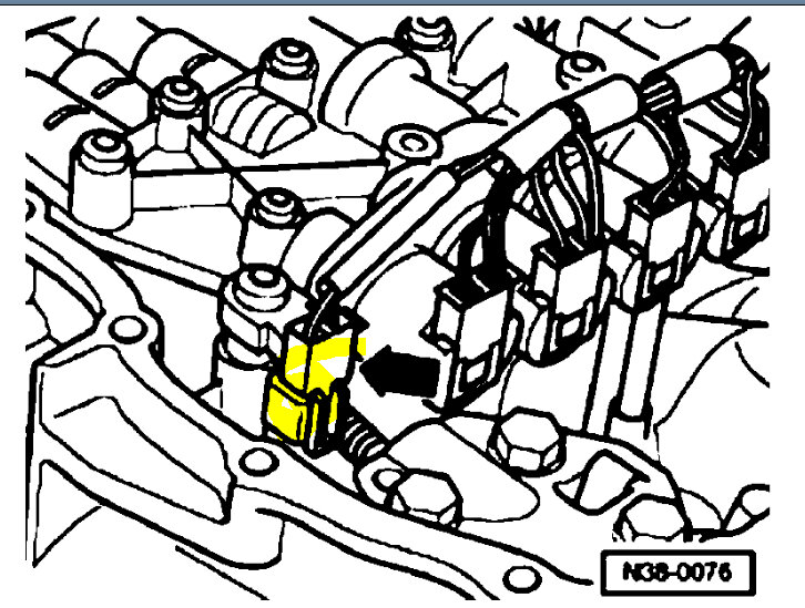

There are two different speed sensors. One is on the outside of the transmission near the axle. See pic 1. There is also one in the transmission that requires the removal of the transmission oil pan.
So, are you having issues with the speedometer or transmission shifting or both? I ask because the code leads me to both sensors.

It sounds like the external sensor, but if your vehicle doesn't have one there, then it is the internal one.

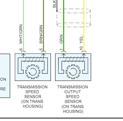

Is it possible there is supposed to be a sensor there and that's why the car gave that code? Should I install the sensor that I bought. I can't see a wiring harness that would go to it though currently, but I did notice an empty space for a connector in line with other connectors right below the coolant res. Could that maybe be where the "missing" wiring harness belongs?
Thank you, Starsha
Jun 26, 2023 at 4:38 PM
  • 110,236 POSTS
Anything is possible but it is unlikely that the sensor fell out of the transmission.
I attached a pic below with the sensors. Do the wire colors match what you are seeing?
See pic below.
