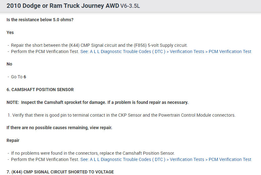

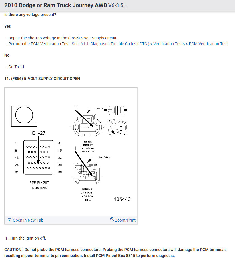

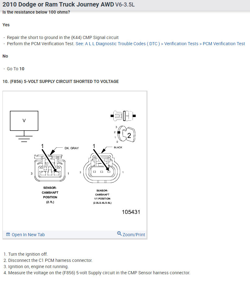

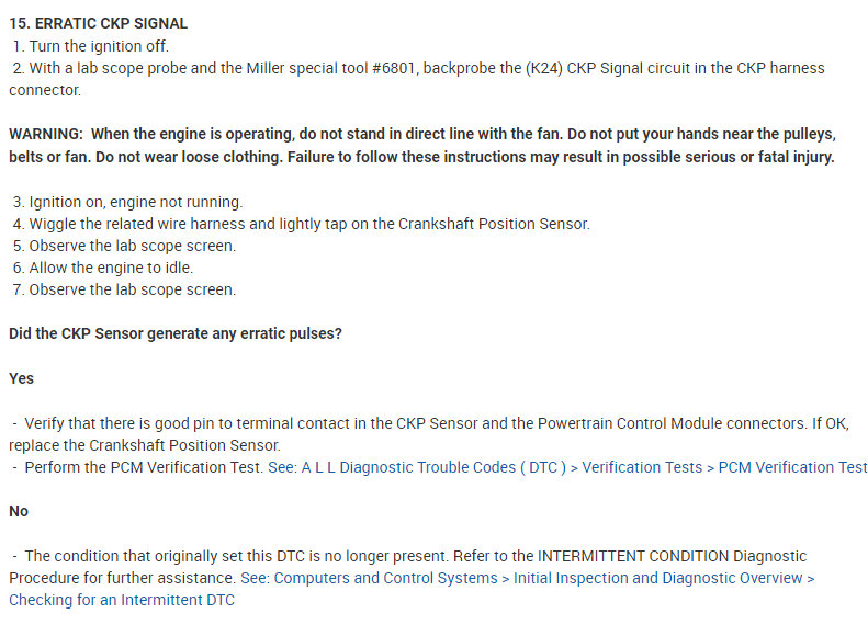

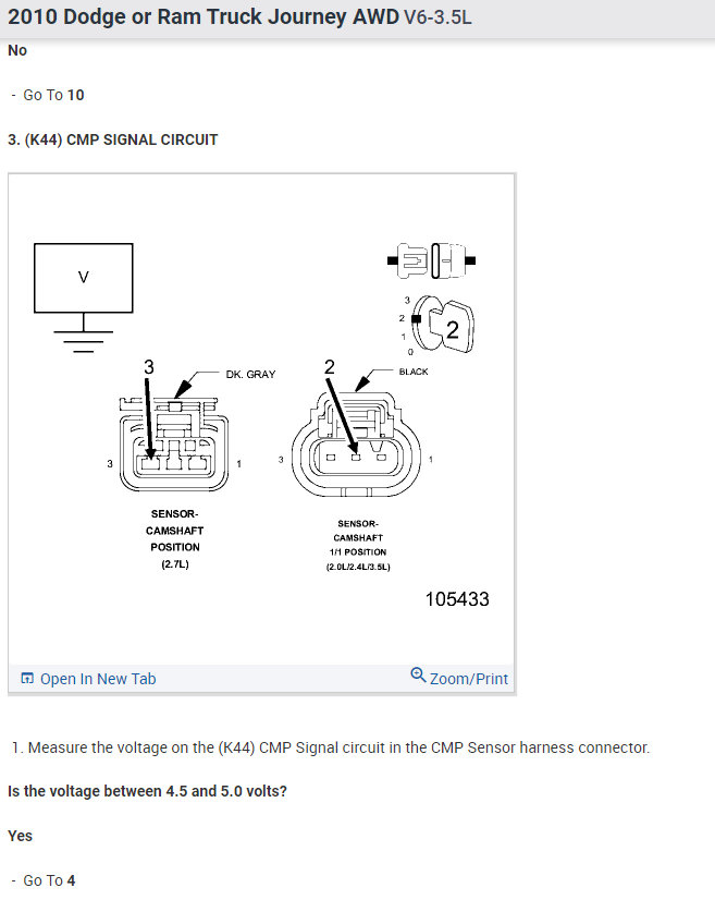

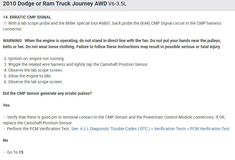

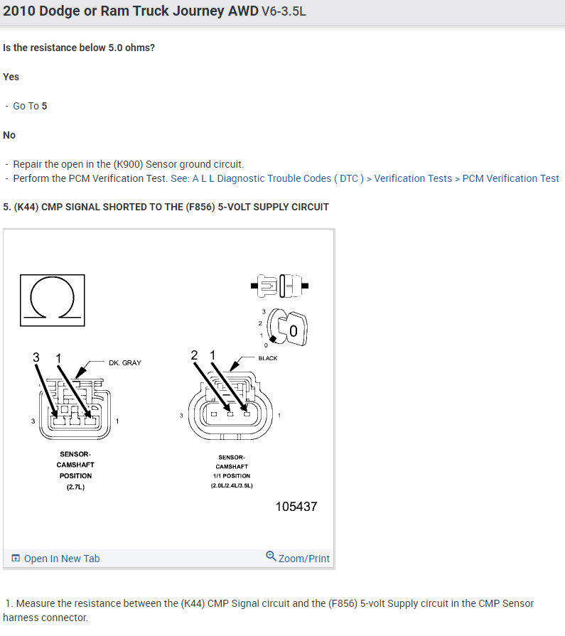

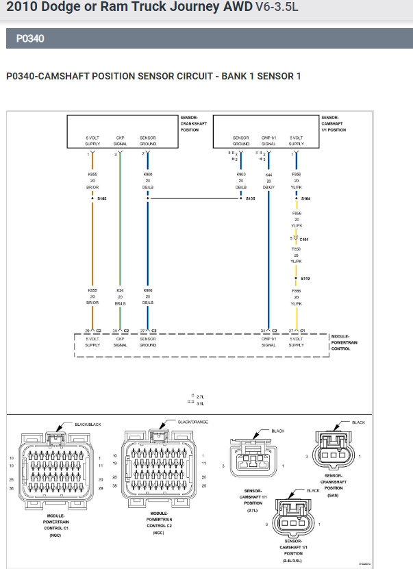

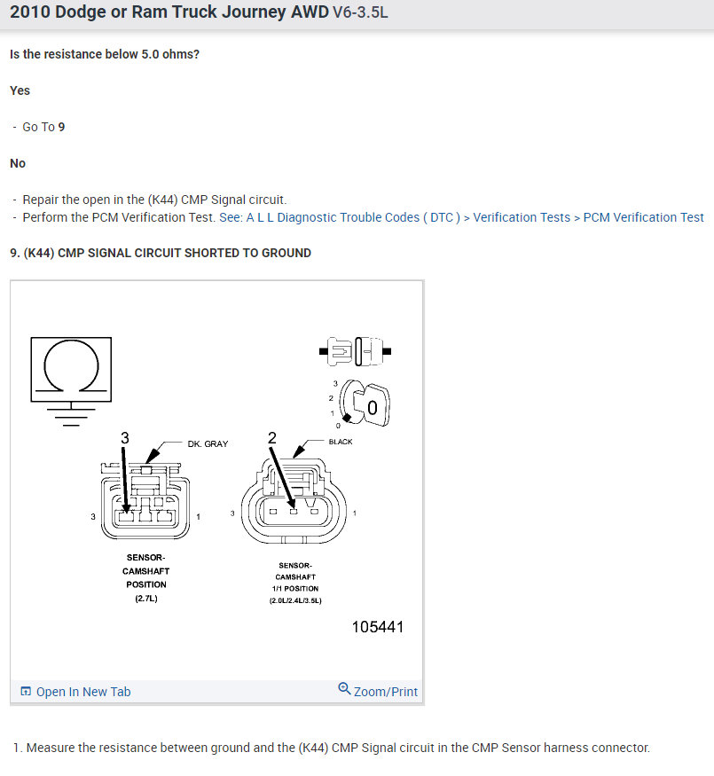

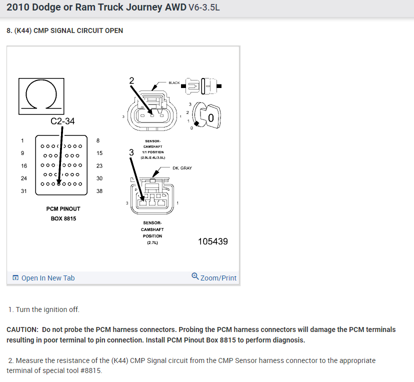

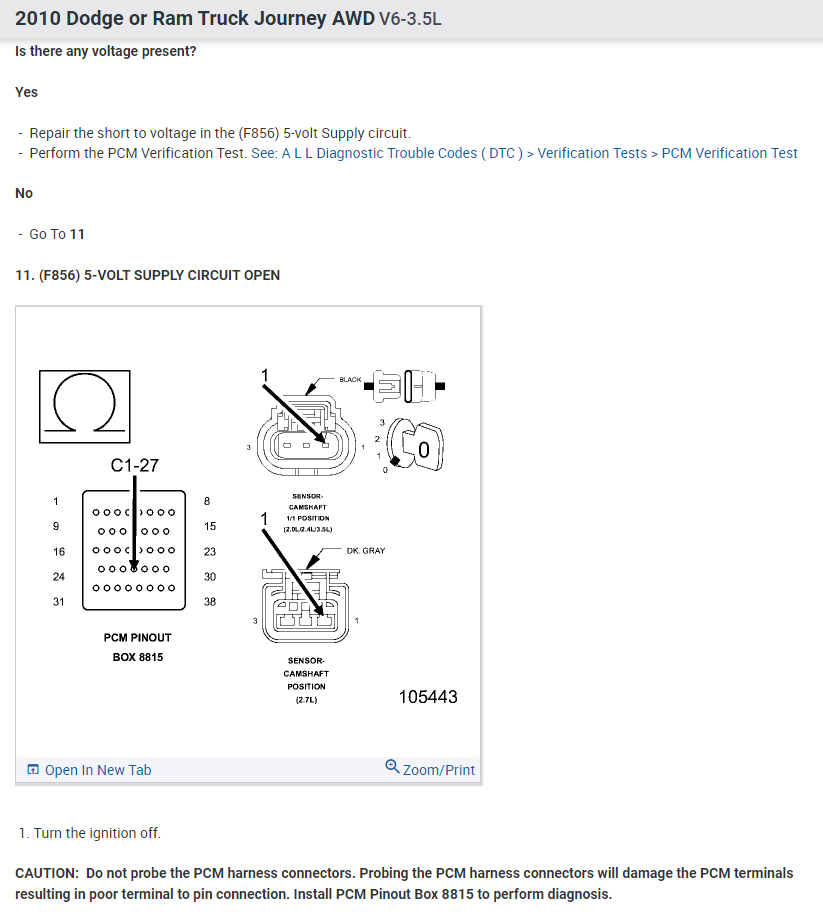

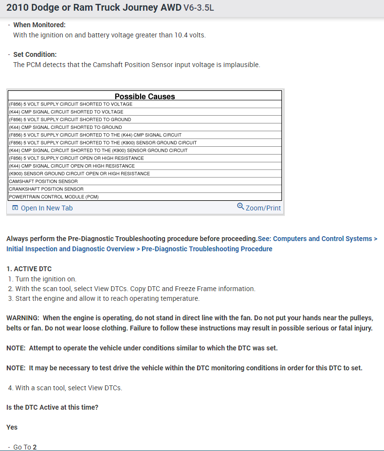

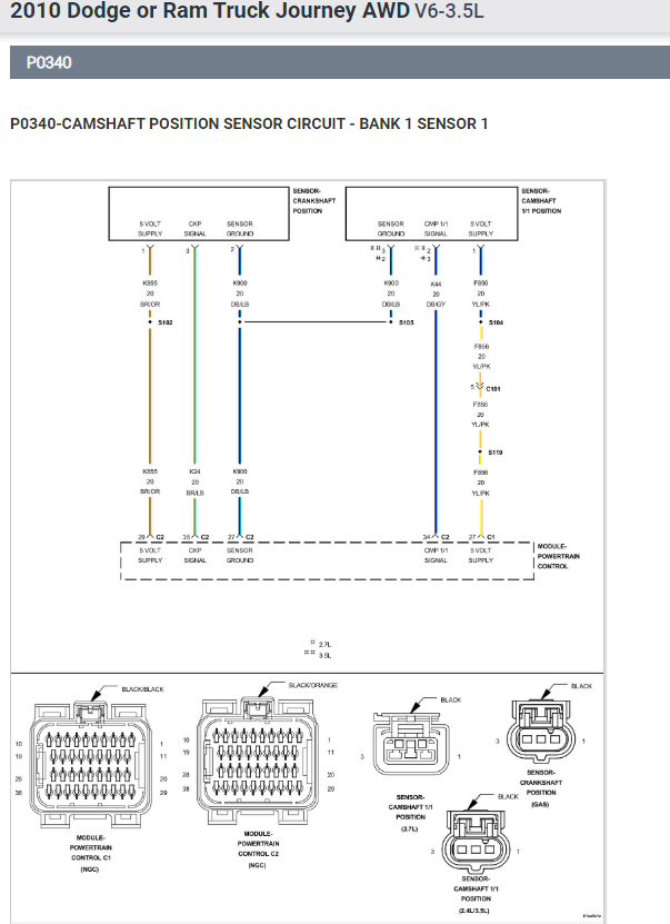

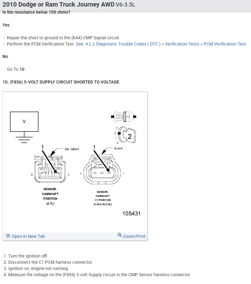

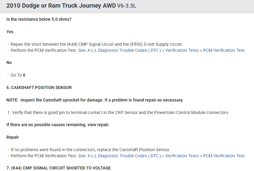

Gives this code (p0340). I replaced this cam sensor twice along with the crank sensor. still no start it just shut off on us driving. i don’t have spark or fuel going to engine. fuel pump kicks on and it just cranks. i rewired to the cam sensor as well, still nothing. Please help
Aug 11, 2021 at 12:32 PM
SQM
  • 6,383 POSTS

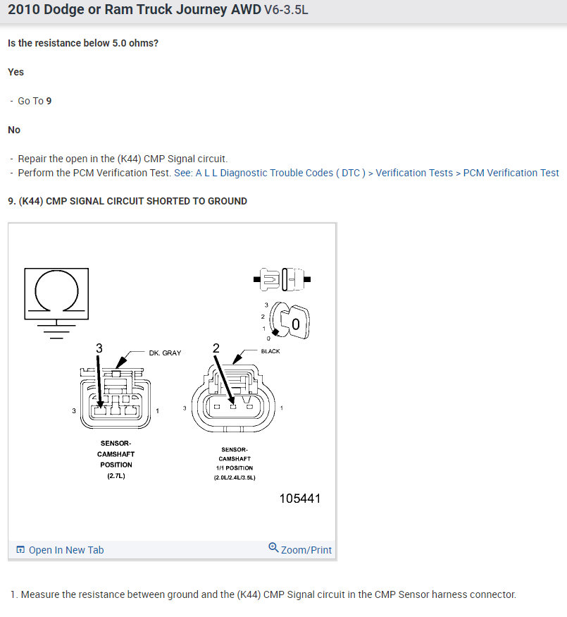

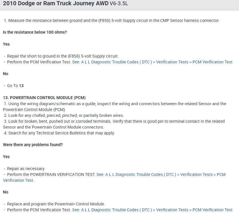

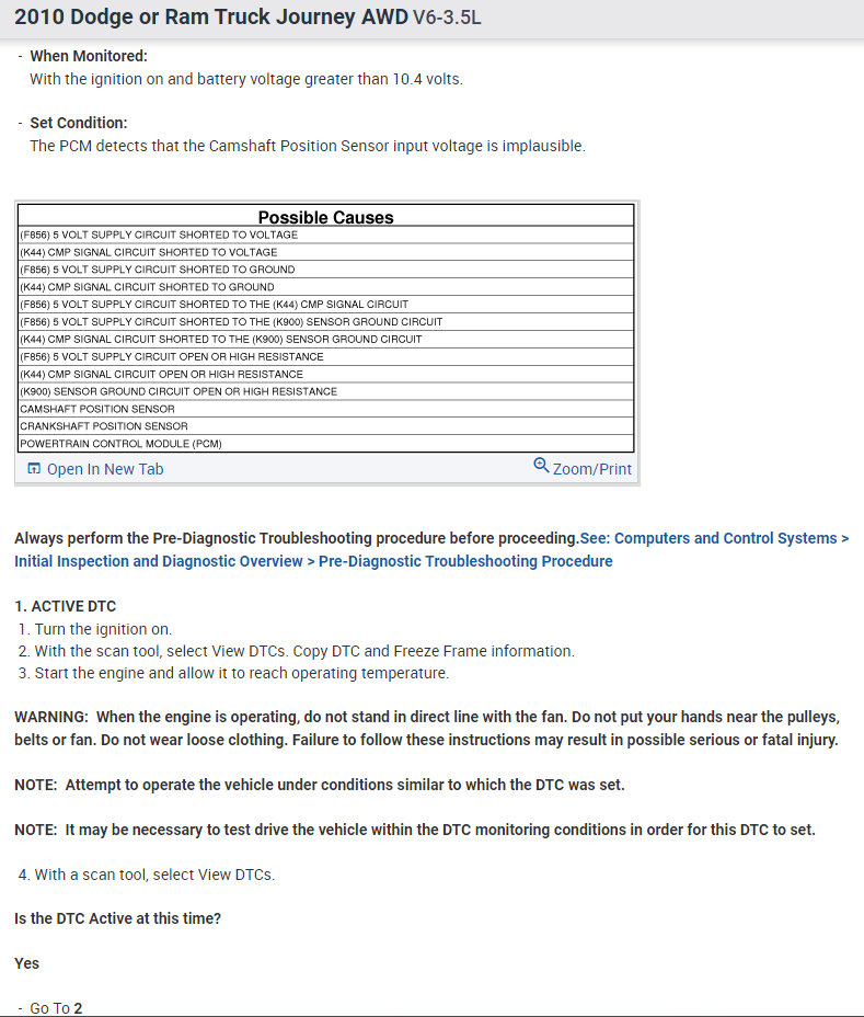

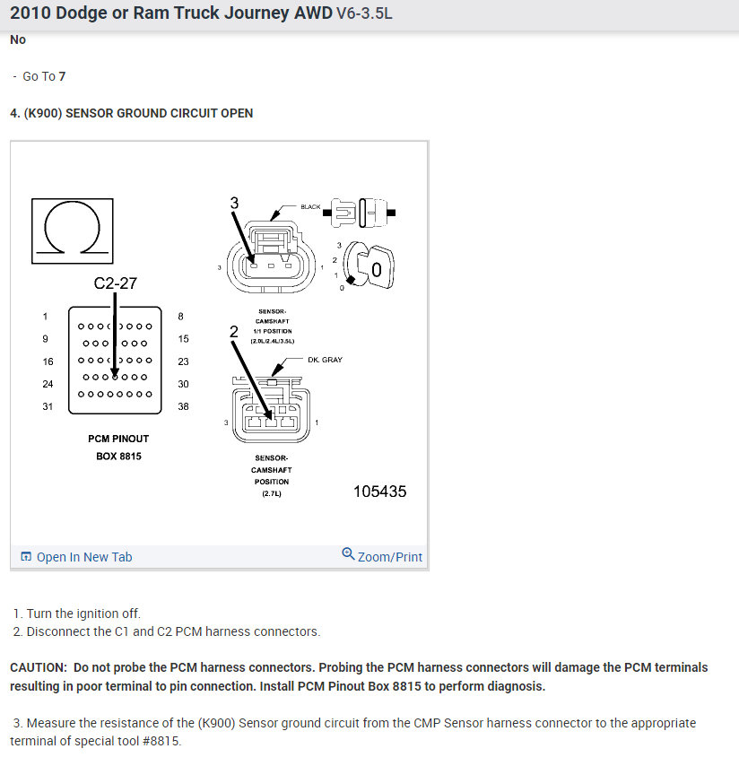

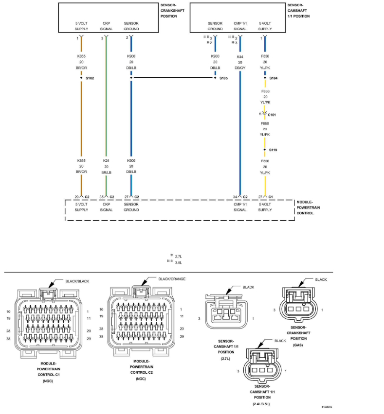

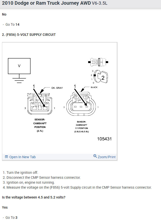

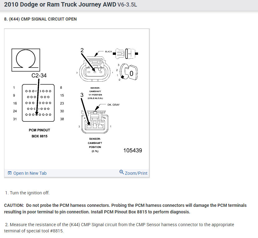

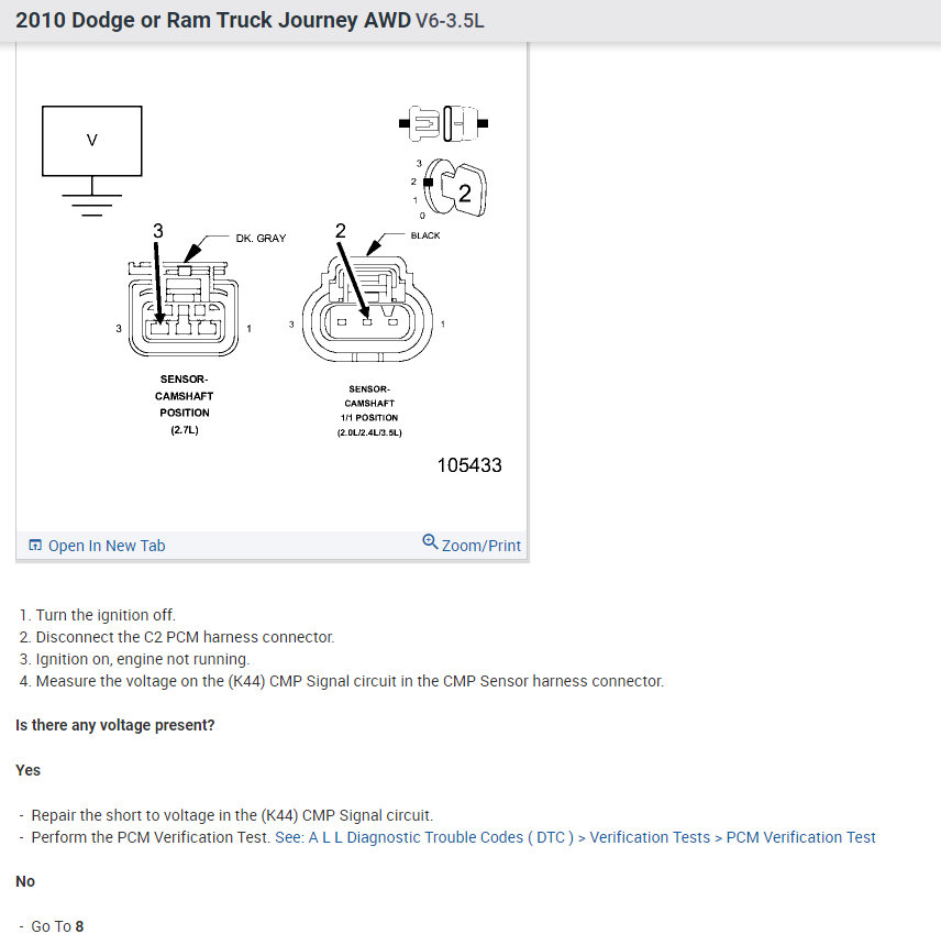

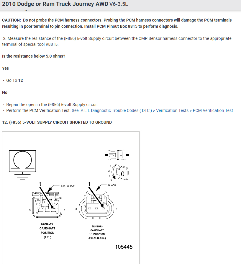

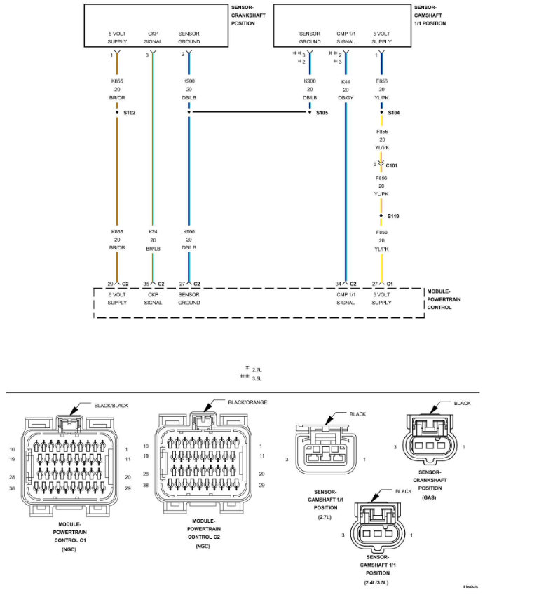

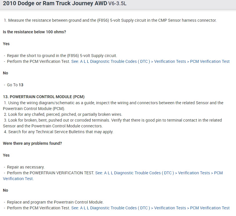

Since you have already replaced the component and still having the same issue, the problem might be wiring or another component that might be triggering that code.
I have attached the step by step diagnostics for the P0340 code.
You might have to go thru the steps to determine why you are having the issue.
You will need a multimeter to perform these steps. It will walk you thru the correct resistance and voltage for the harness.
