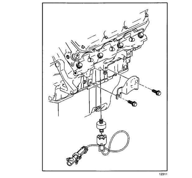

Replacing knock sensor is this a hard repair? Can I do this myself with basic tools? And if not how much around would it be at a shop to have this repair done? Thanks for your time.

the knock sensor is a common failure. this needs to be confirmed before assuming it is the issue.
I attached a description and procedure for replacing it if it is the failure. you need an advanced scan tool to monitor the action of the sensor.
as far as price, the labor is 2 hours at a shop plus the cost of the part. I would also replace the pig tail as well as that is always recommended.

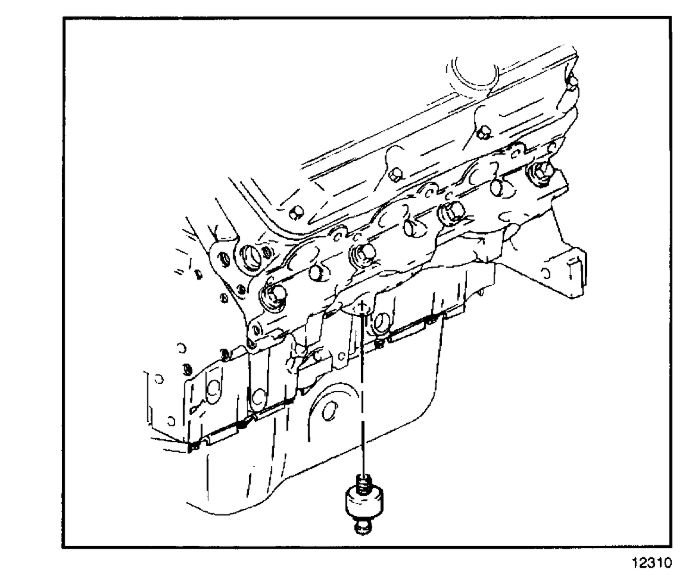

procedure
REMOVAL PROCEDURE
CAUTION: Hot engine coolant may cause severe burns. Although the cooling system has been drained, coolant still remains in the engine water jacket. This coolant will drain with the removal of the knock sensor.
imageZoom/Print
1. Turn OFF the ignition.
2. Raise the vehicle. Refer to Lifting and Jacking the Vehicle.
3. Remove the splash shield.
4. Drain the cooling system. Refer to Draining and Filling Cooling System in Cooling System.
imageZoom/Print
5. Remove the knock sensor heat shield mounting bolt located under the freeze plug (or block heater if equipped).
6. Disconnect the knock sensor wiring harness connector from the knock sensor.
7. Remove the knock sensor from the engine block.
