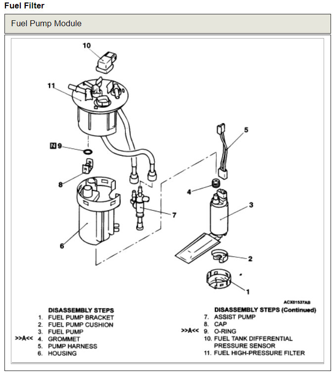

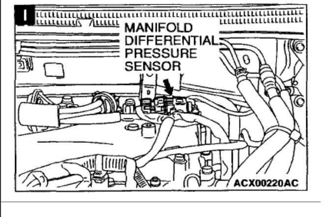

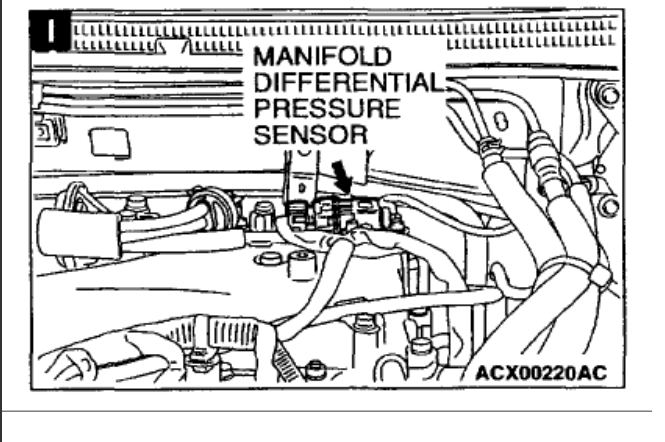

  • 55,414 POSTS
You need to use OEM plugs anything else and the car will misfire also. I would try a different MAP because they can be off a little causing a lean mixture and misfire. Also, I have seen the strainer plug up on the fuel pump causing low fuel delivery. Here are diagrams so you can see what I am talking about.
