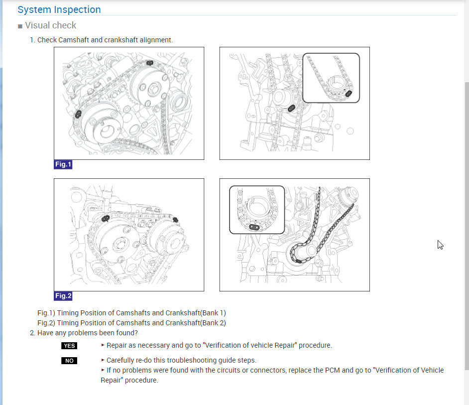

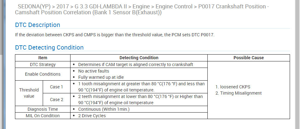

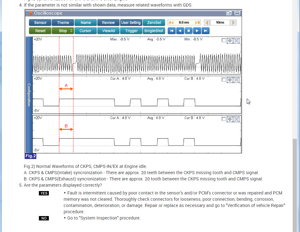

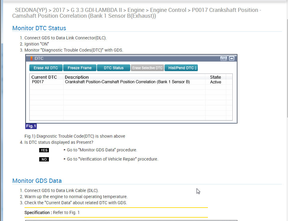

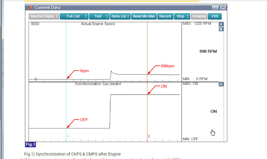

You have what is called variable valve timing system. Meaning the PCM will actually change the cam timing to adjust for best operating parameters.
https://www.2carpros.com/articles/how-camshaft-variable-valve-timing-works
If there was sludge in the engine then that means the oil has not been changed frequently enough and it begins to turn into sludge.
Unfortunately there is no effective way to flush the oil to ensure the sludge gets out of the actuator that actually moves the cam so more then likely it will need to be replaced.
However, I included the testing for this code. I would suggest we actually run through the testing to prove this out. I am not sure why the dealer did not do this but that is what we need to do.
Let us know if you have questions. Thanks
