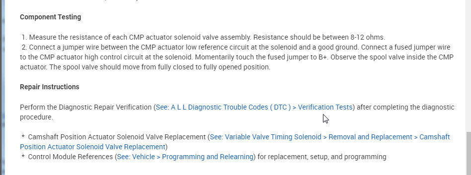

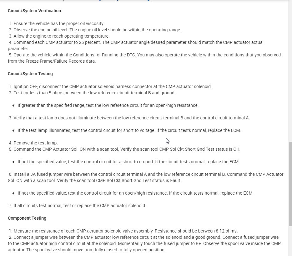

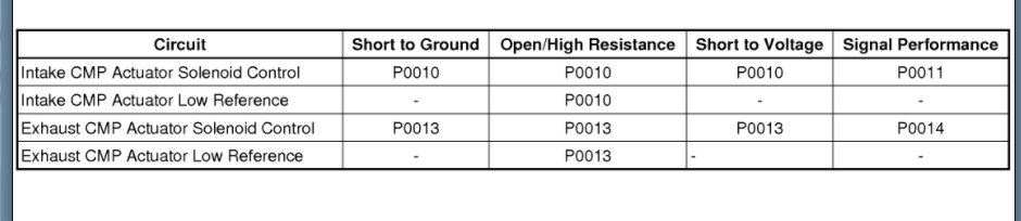

I've tested both the intake solenoid and the exhaust solenoid for the camshaft but i'm not entirely sure what the OHM's are supposed to read for my particular make and model.
I have a replacement for the camshaft sensor bank 1. But I was just informed that there are two camshaft sensors. I guess I am unsure if I should change them both or just one at a time? And which one is which?
Oct 1, 2020 at 8:43 AM

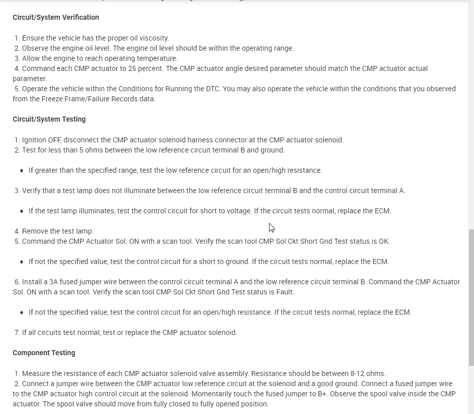

I am attaching the testing for these codes. Basically it is the solenoid that is most likely the issue and not the sensor. The actuator resistance needs to be between 8-12 ohms. Run through the testing and let me know what questions you have. Thanks
