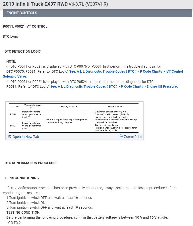

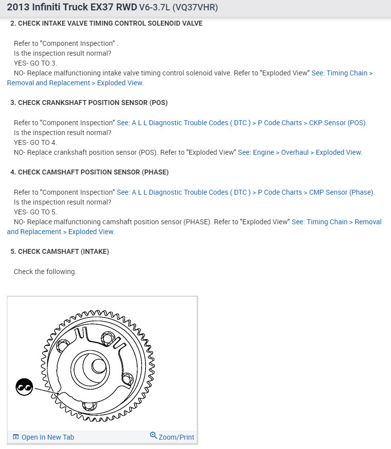

I inadvertently let the car get low on oil, the code P0011 came on, car lacked power, and jumped and jerked, I changed the oil and reset code, it came back, running bad again, I replaced VVT and reset, it came back, running bad, did hard reset, it came back and running bad. If I reset the code car runs fine until I turn it off then, the code comes back and runs bad. Not sure what to check next.

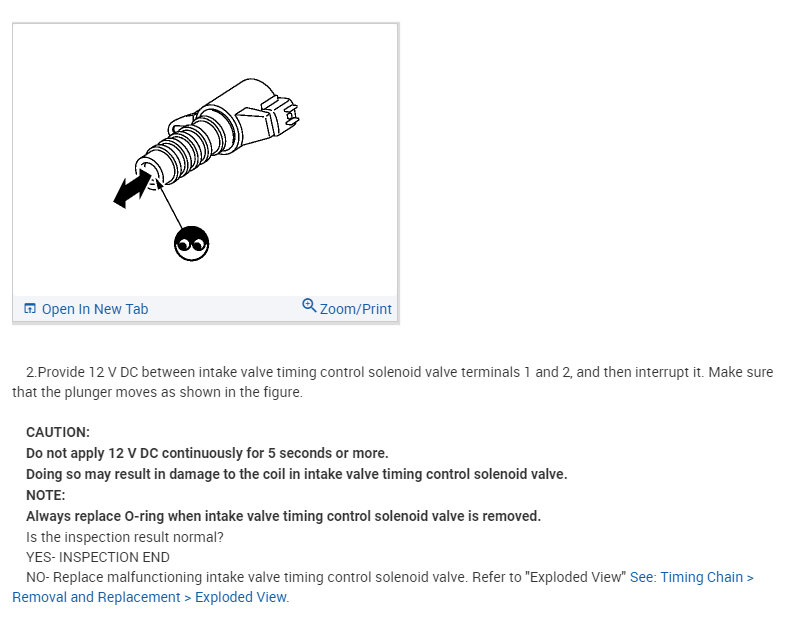

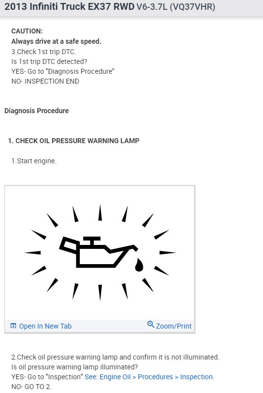

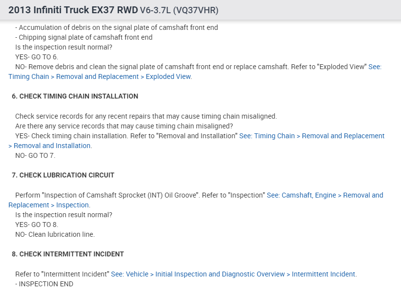

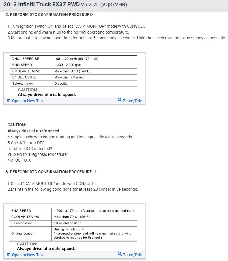

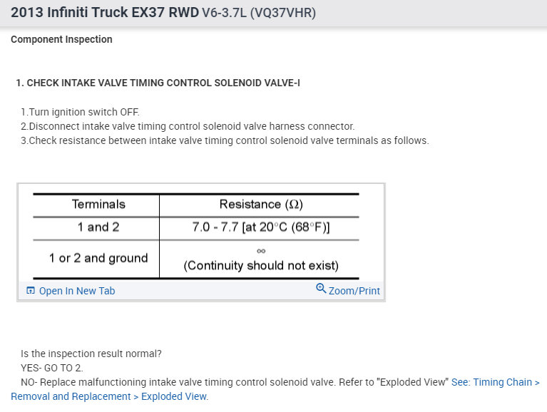

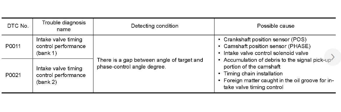

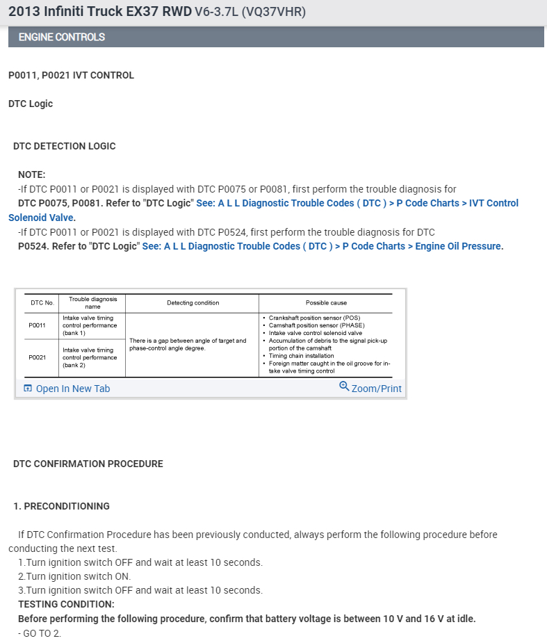

The code P0011 can get triggered for a number of reasons.
It could be due to faulty crank or camshaft position sensor, Intake control solenoid valve. It can also get triggered due to debris being stuck on the signal pickup portion of the camshaft.
The best course of action would be to take a look at the different components to determine the fault.

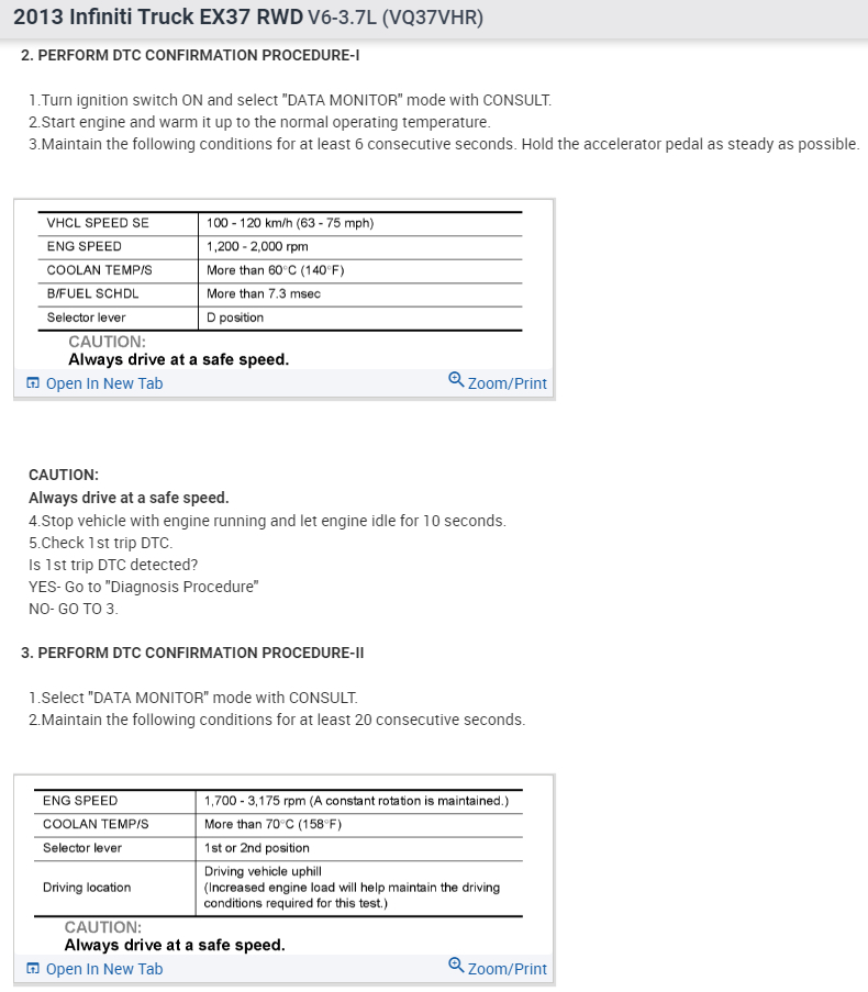

I have attached below the diagnostic steps for this code.
Follow those steps and it should help you isolate the issue.
Please let me know what you find or if you have any questions.
