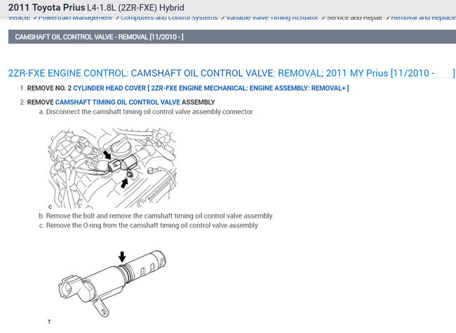

P0010 Symptom Descriptor Camshaft Position A Actuator Circuit (Bank 1) Probable Causes Camshaft Timing Oil Control Valve (OCV) Engine Control Module (ECM) Open or Short in Camshaft Timing Oil Control Valve (OCV) Assembly Circuit. So, what happens on these is little metal flakes and gunk can plug up the oil control valve to the camshaft. Here is the valve location so you can remove it to check it out. Check the images below and let me know what you find please.

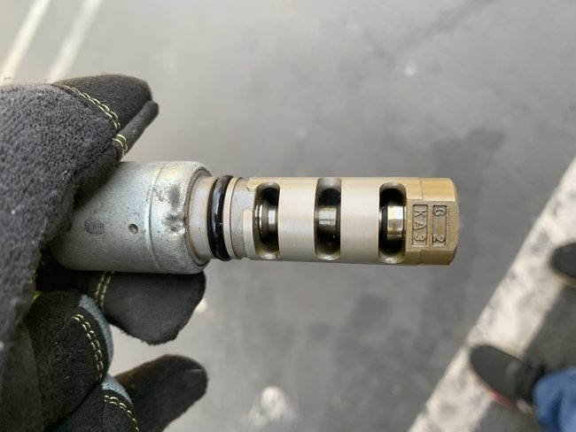

Hey ken! Thank you so much for your help, I already took it out and got some valve cleaner and cleaned it out. Unfortunately, the problem seems to persist.

The valve could be bad and just not working, does the engine have clean fresh oil and filter?
