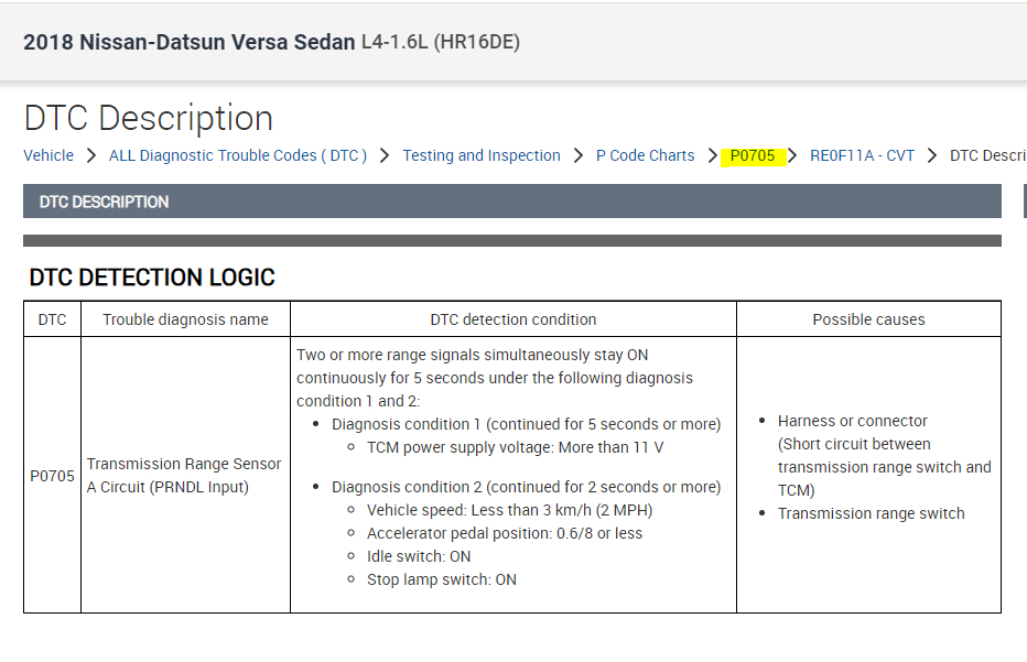

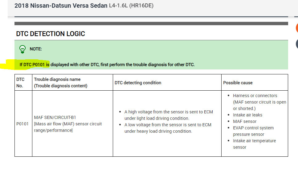

Codes P0101 and P0705?
2018 NISSAN VERSA
95,540 MILES • 1.6L • 4 CYL • 2WD • AUTOMATIC
RONALD DEVOLD
  • 134 POSTS
Codes P0101 and P0705, help!
Feb 16, 2024 at 8:24 AM
  • 110,240 POSTS
These appear to be related to two different things. I attached a general description if each one below so you can review them.
I need to know what symptoms are being experienced. Also, I need to know if this is a Versa sedan or Note
