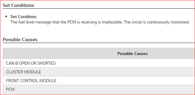

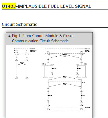

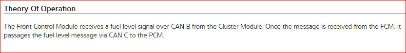

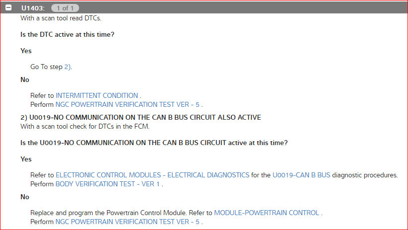

Code comes up U1403. What is it and how do I fix it?
Oct 6, 2018 at 2:12 AM
DANNY L
  • 5,648 POSTS
Hello, I am Danny.
The code is showing an implausible fuel level. Is your car's gas gauge inaccurate/not working? I have attached a few pictures showing diagnostic steps. You will need to use a keep code reader/scanner than can show fuel system data. Hope this helps and feel free to ask any questions if needed.Thanks for using 2CarPros.
