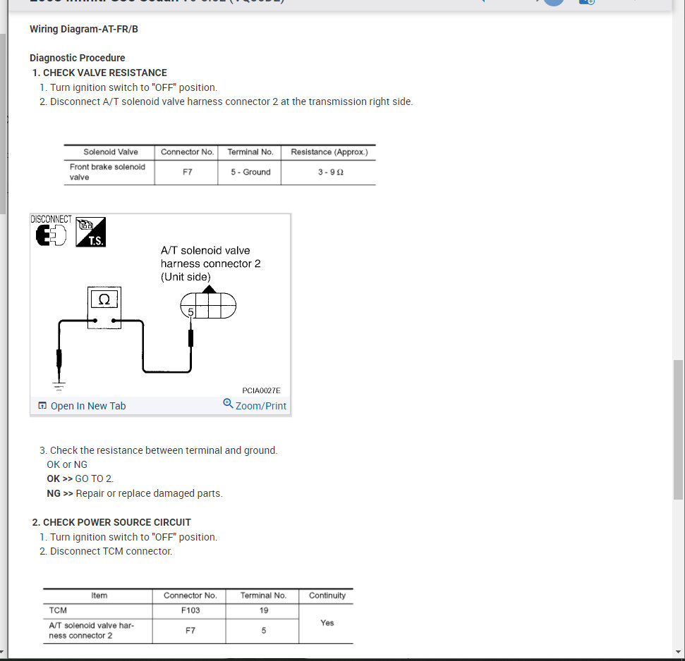

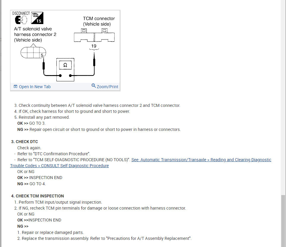

I was driving stopped at a light went to step on the gas and it went very slow, i took foot off gas pedal then pressed it again to go and felt it go into gear and drove. The check engine light is on. I took it to AutoZone and said code p1757. Can someone help explain what it means please?
Jun 9, 2021 at 10:29 PM

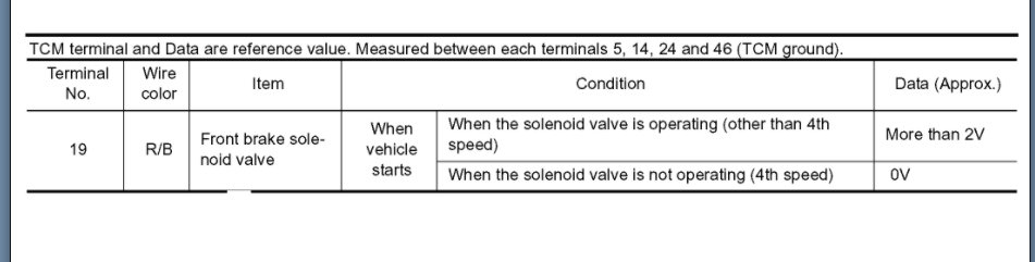

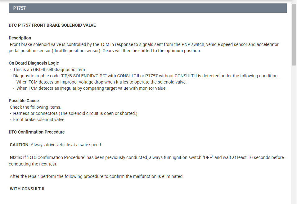

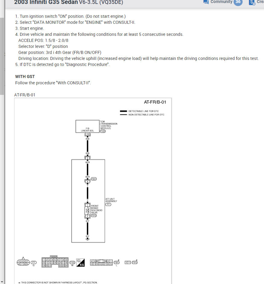

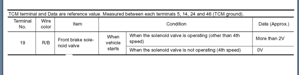

This solenoid helps optimize the shifting to the best gear to match driver needs and maximize fuel economy.

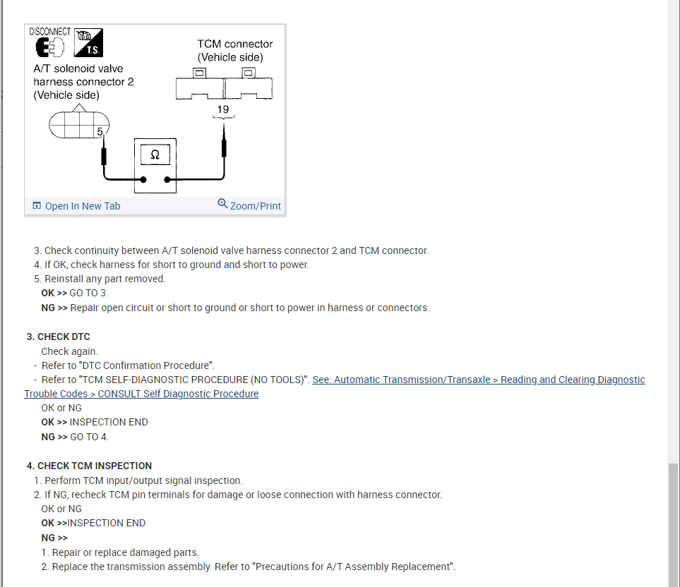

This will cause the issues you are seeing so we need to run through the testing below to determine what the issue is. It could be a harness/wiring issue or even the TCM so we need to narrow this down.
Here is a guide that will help with this testing:
Please run through this testing and let us know what questions you have.
