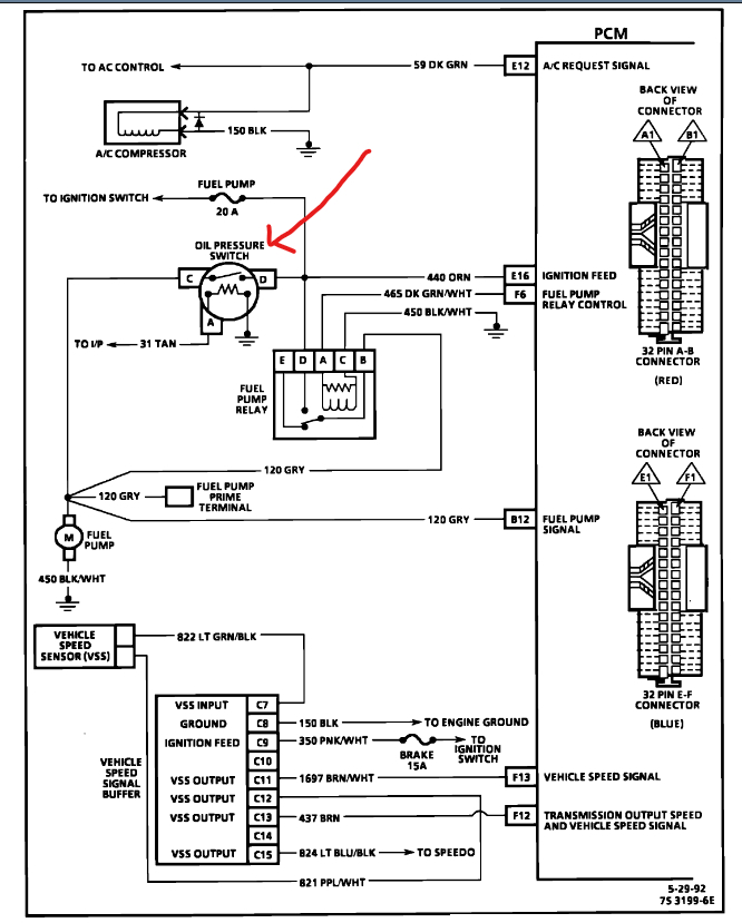

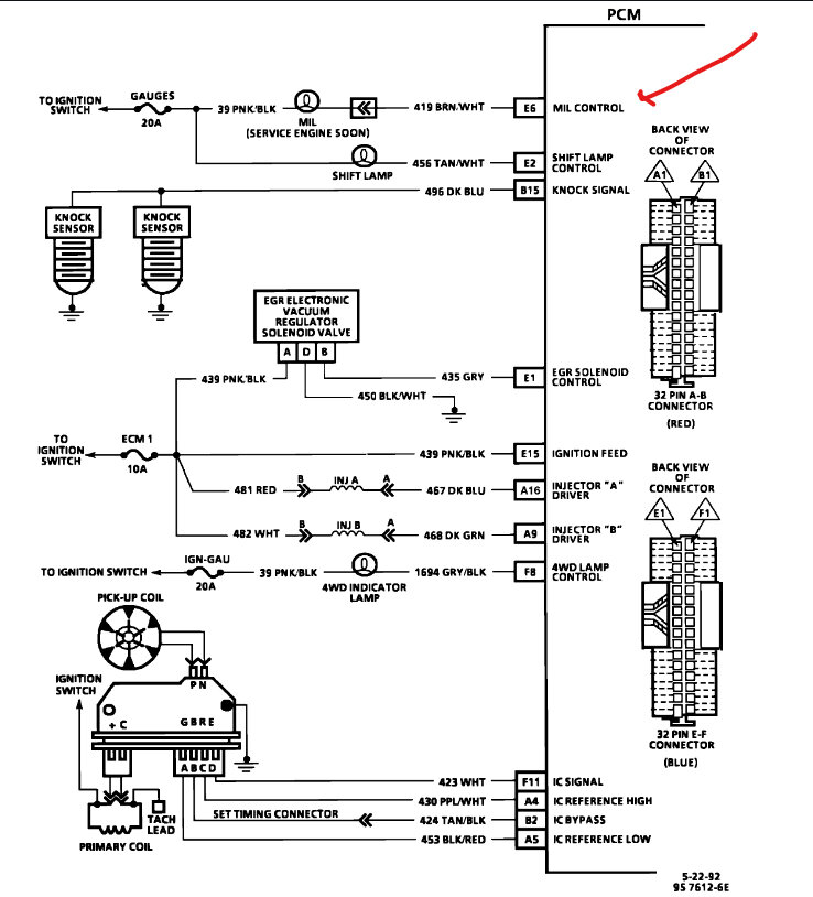

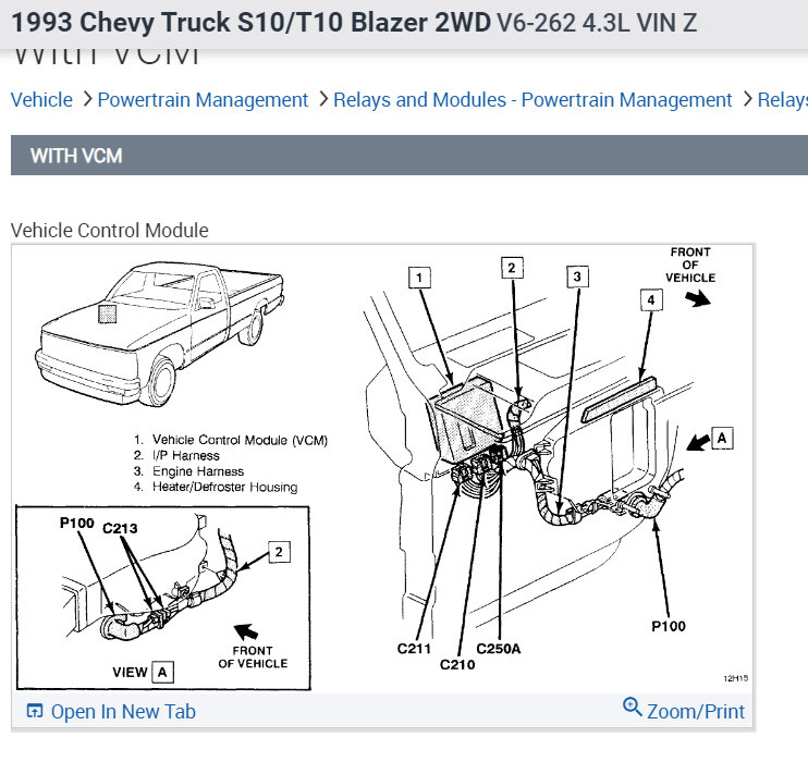

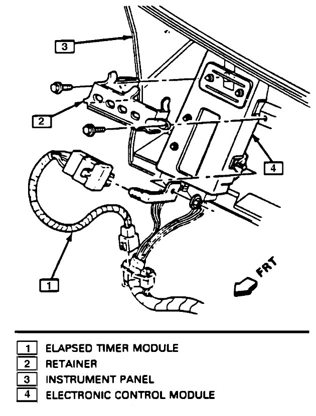

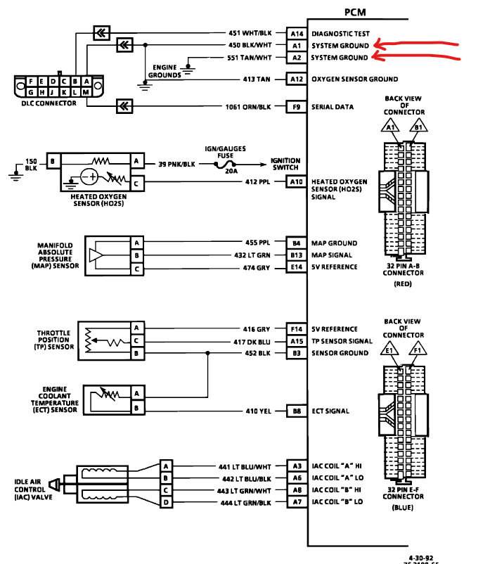

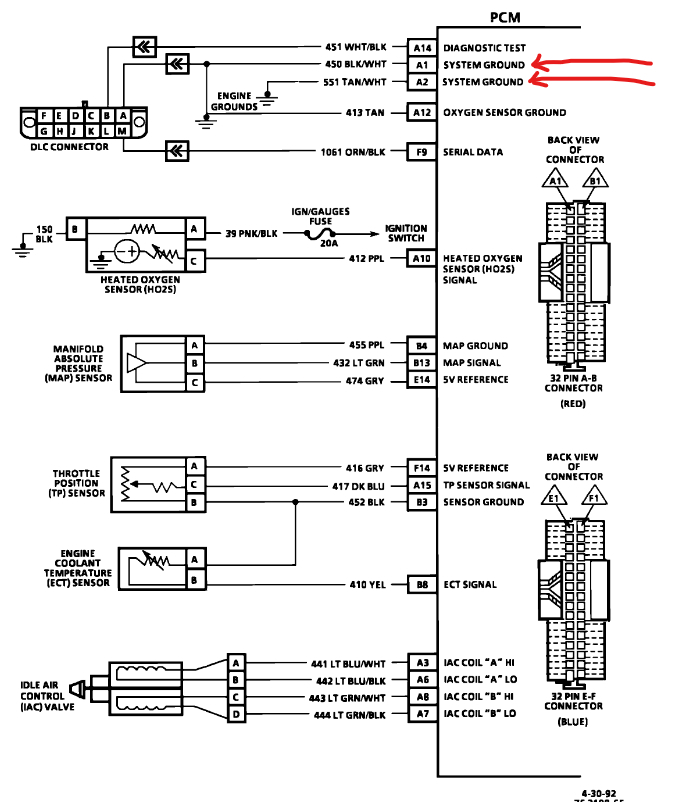

The fact that you hit a bump and it acts up sounds like a bad ground or power lead to the PCM.

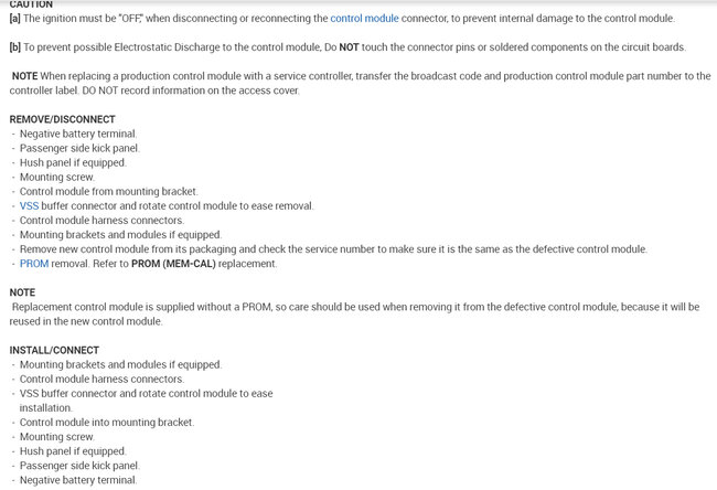

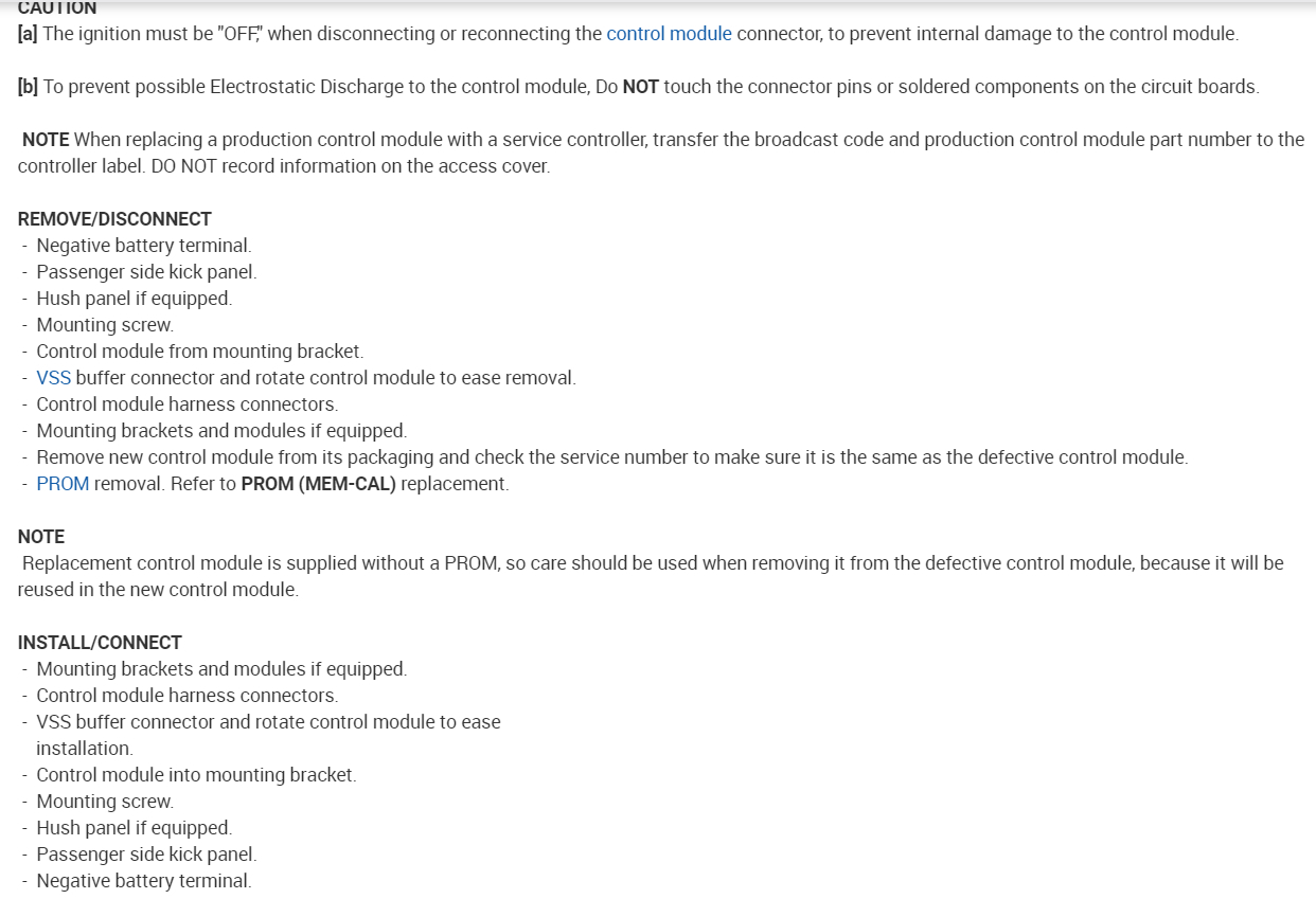

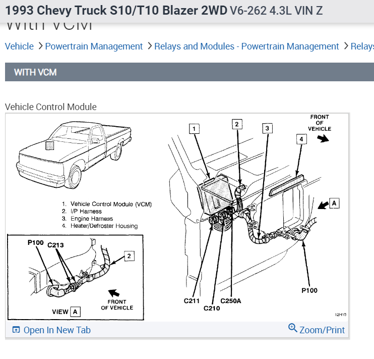

Here are the wiring diagrams and a guide to help you test the connections and grounds:
You might have a bad PCM as well if the grounds and powers are good. With the engine running try tapping on the PCM and if the engine stalls or stumbles it is bad. Check out the images (below). Please let us know how it goes.
