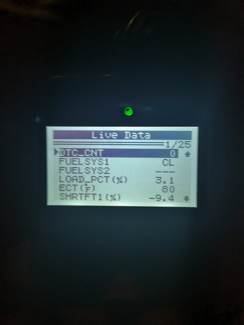

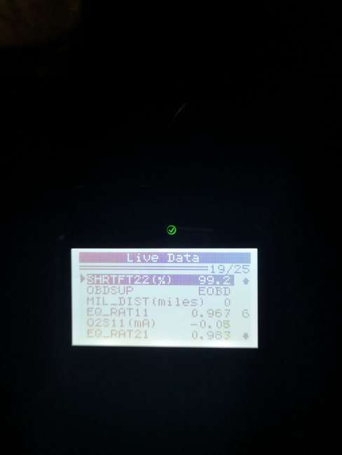

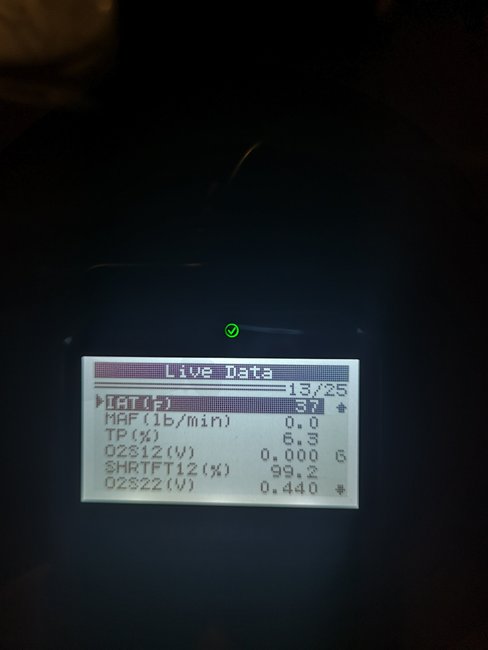

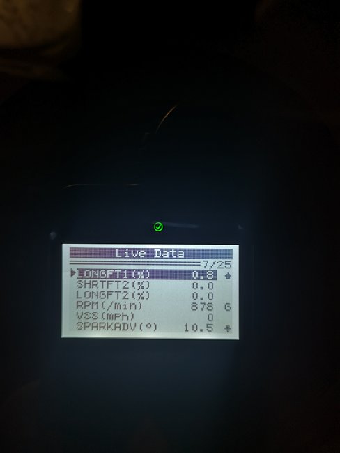

GARYMCC
  • 9 POSTS
Is that what you wanted to see?
Feb 26, 2020 at 4:13 AM
  • 110,244 POSTS
Yes, that's what I needed. The STFT of 99 indicates the computer is adding fuel. This happens when there isn't enough fuel to the engine and too much air. Usually, this is the result of a vacuum leak, low fuel pressure, damaged regulator, bad O2 sensor, which yours looks okay, a cracked exhaust manifold, dirty or damaged fuel injector and so on.
With all of that, have you checked fuel pressure? Also, are there any exhaust leaks?
Feb 26, 2020 at 9:51 AM
