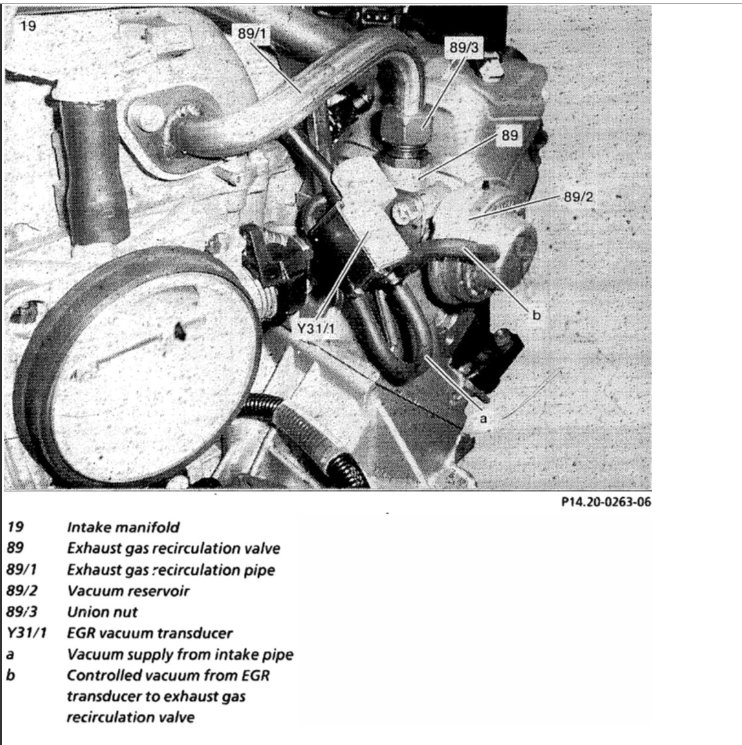

Do you have a video for removal and cleaning of EGR related issues?
Thanks.
May 8, 2018 at 3:20 AM
  • 55,399 POSTS
We do not have a video, but I did find this diagrams showing the EGR and how to remove it. To clean it use carburetor cleaner, coat hanger and shop towels.
Here is a video on how to test the valve:
https://youtu.be/DqUCbbKdWf4
