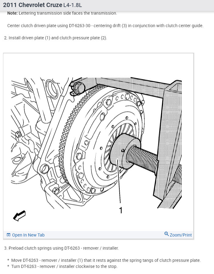

I've watched your video on YouTube several times. How to Replace a Clutch and Throw Out Bearing Front Wheel Drive Vehicle | Step by Step! (Chevrolet Sonic). How much different is the process on the car listed above LS?
I have determined that my clutch needs to be replaced and I am currently finding all the parts.

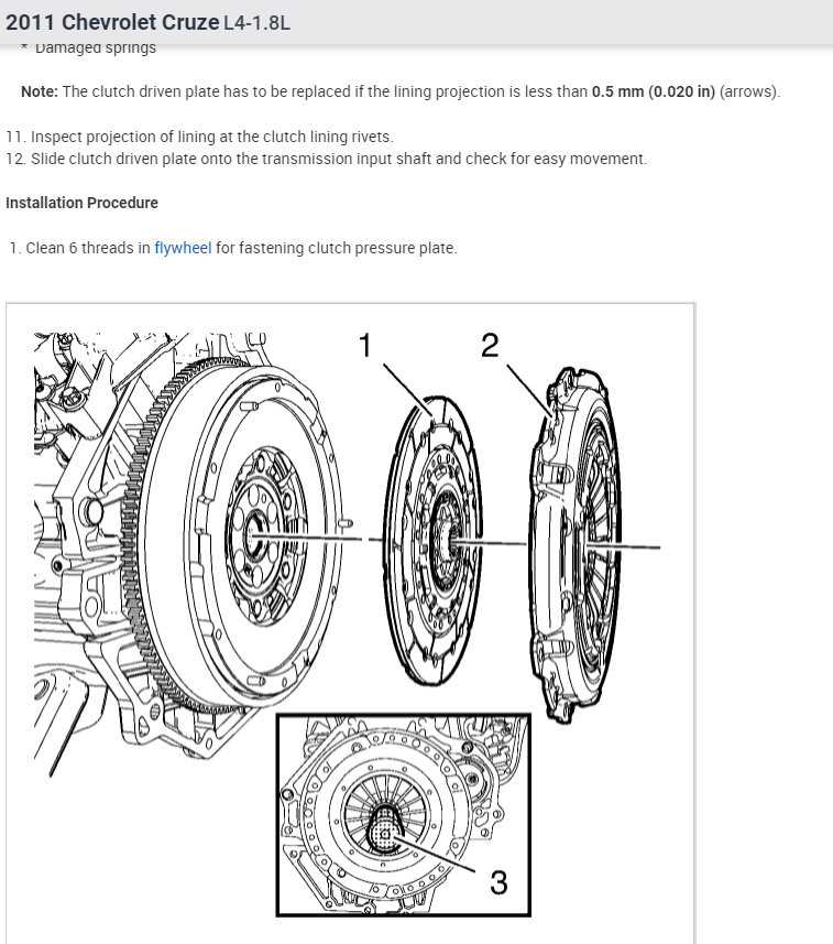

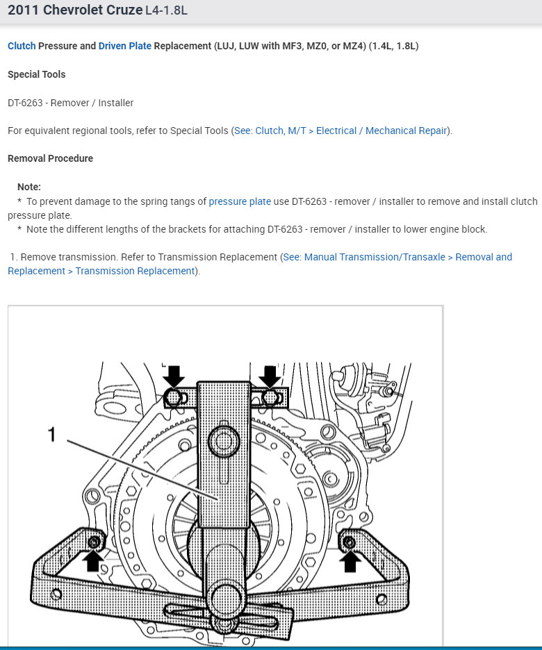

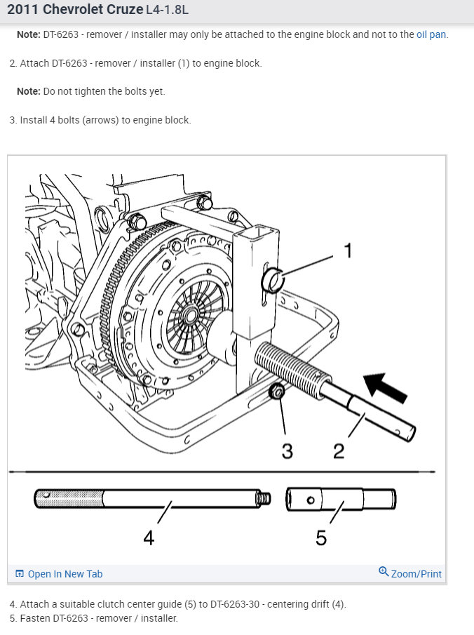

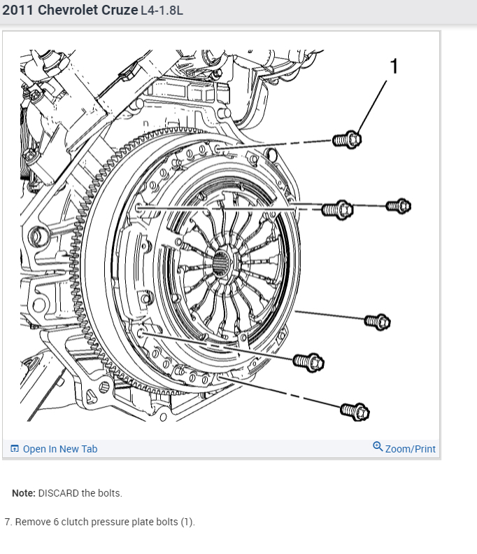

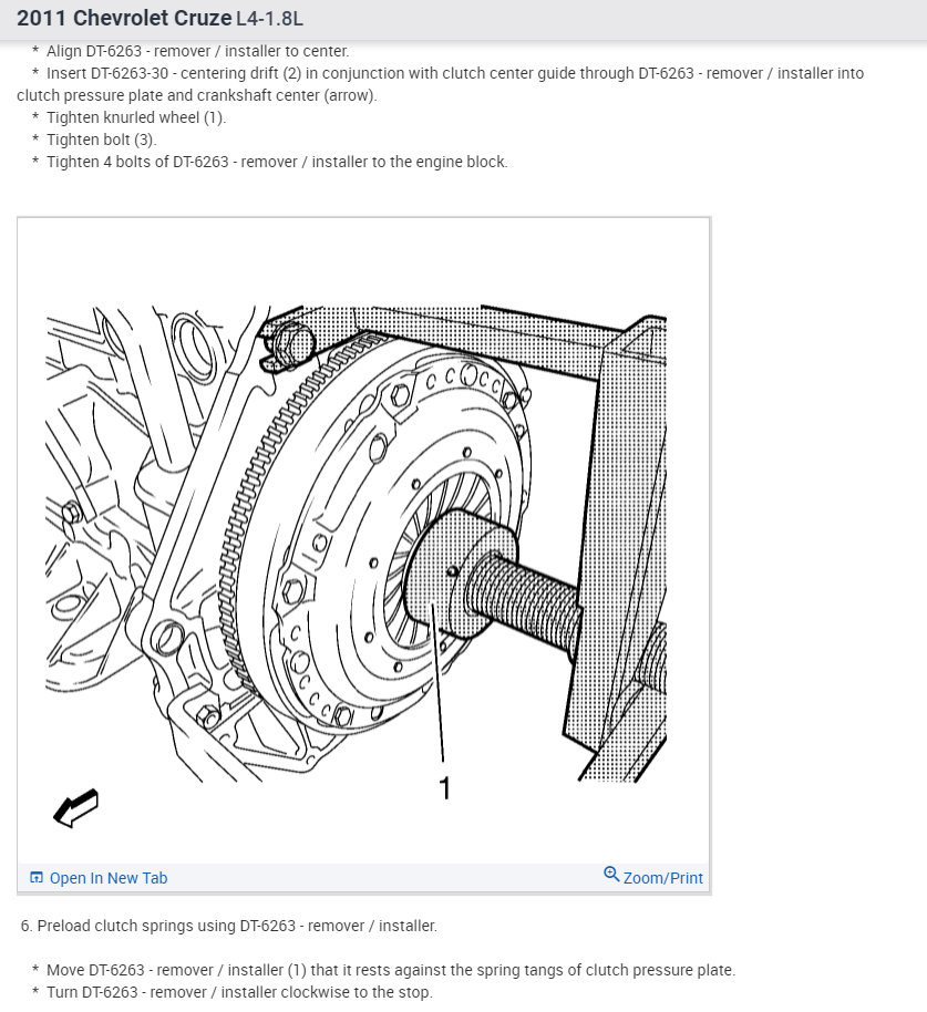

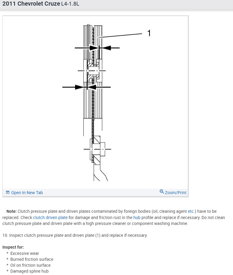

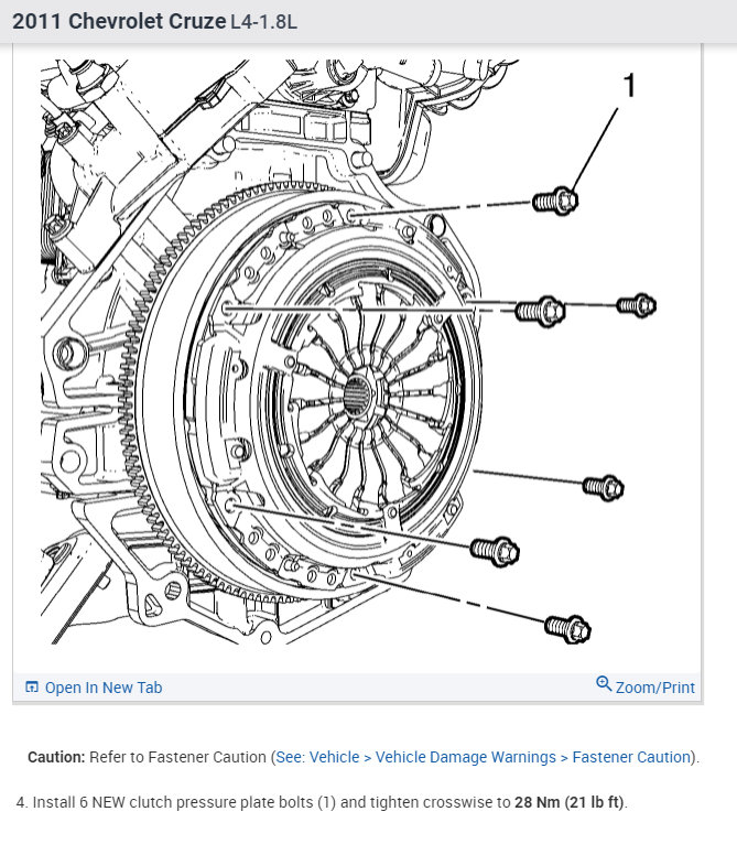

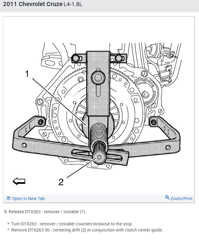

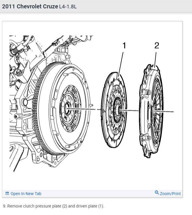

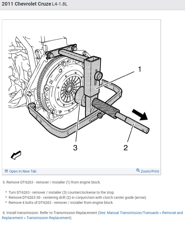

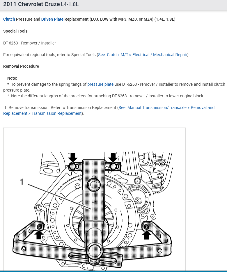

The overall process is similar for your Cruze.
I have attached the clutch removal and installing steps below.
Please note that you will need a special tool for the removal and install.
This instruction just covers the clutch and pressure plate replacement. If you need instructions on transmission removal, let me know.
