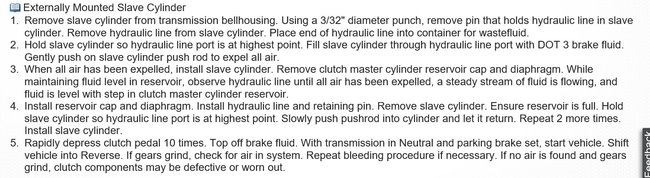

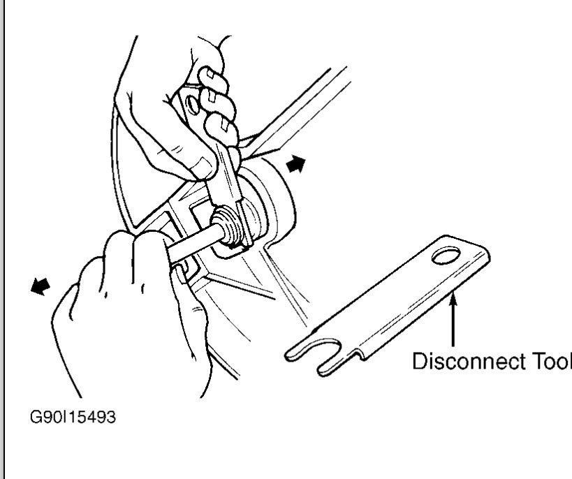

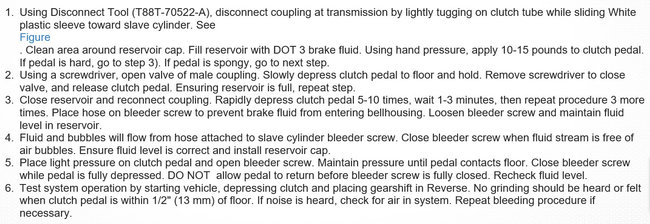

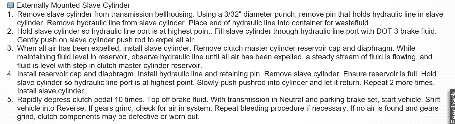

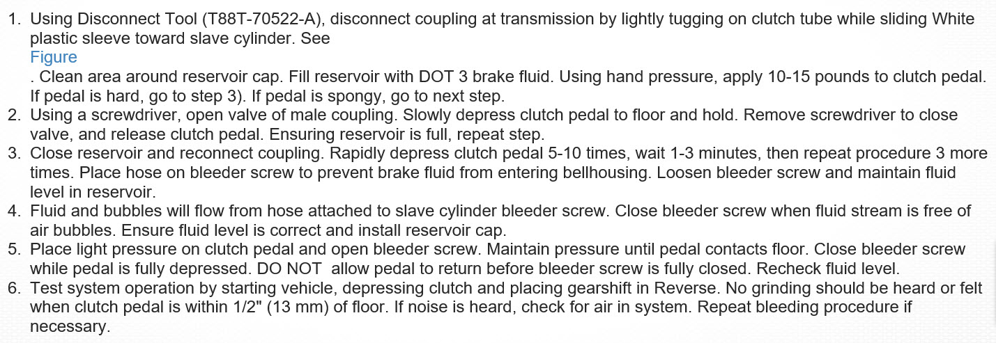

see pictures to bleed cylinder one slave is external one is internal I sent instructions for both.
