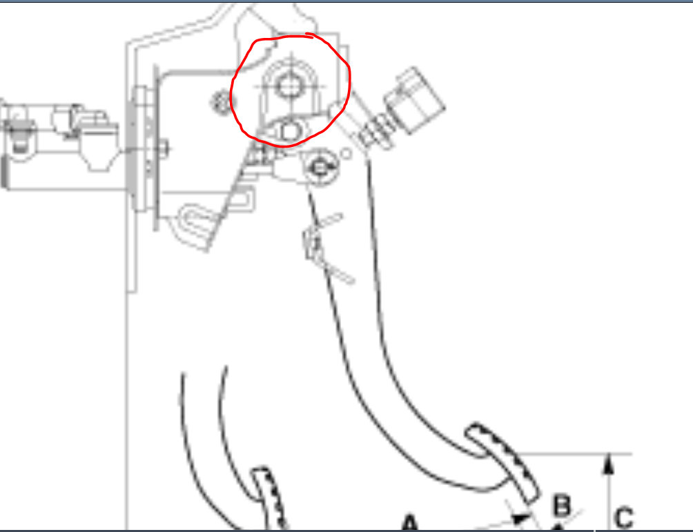

My car is just over 2 years old. I have noticed a squeaking noise coming from my clutch pedal every time the pedal is pressed down and released. As the noise is annoying. I brought it to our Hyundai garage, whereby they sprayed the "mechanism(s)" with WD40 and the noise disappeared for a while, but came back again. I have uploaded an audio recording of the noise.
Can you advise which mechanism should be lubricated so I may do it myself?

They most likely sprayed where the pedal mounts at the top. It is basically a hinge. See the attached pic. Try spraying it in the area of the circle. Also, they should be able to replace the bushing. Isn't the vehicle still under manufacturer's warranty?
Let me know if I can help.
