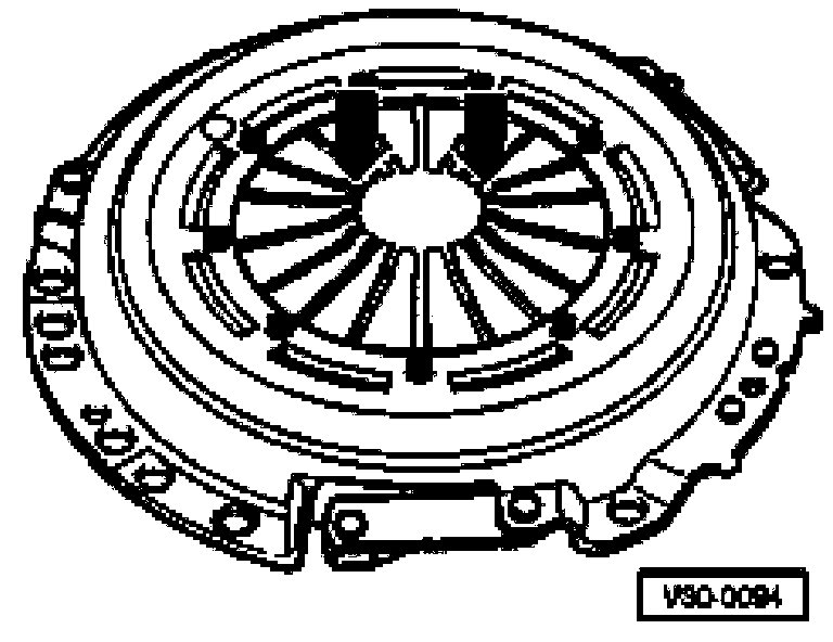

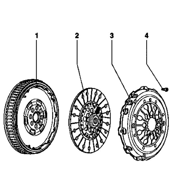

Currently looking into upgrading my stock assembly on my twentieth anniversary. Six speed Gti. I noticed wear on my current flywheel when replacing the starter. I'm fairly new to the mechanical world and don't know if it is necessary to replace the entire assembly or just the flywheel? I've had no issues with the clutch since purchasing 50,000 miles ago. Is it more beneficial to convert to a single mass flywheel or keep it dual mass? Will a kit include the assembly or do parts like the pilot/throw out bearing slave cylinder and pressure plate commonly included or require upgrading all at once? I am a bit of a led foot and drive the vehicle hard and had no issues until selling the car and buying it back a year later after it sat due to a diagnosed faulty starter.

If it is working properly, it isn't necessary to replace anything. As far as the flywheel, you will see marks on it, but that doesn't mean it's bad.
Now, if you want to replace the clutch, it's recommend to replace everything at once. To remove the transmission more than you have to isn't an easy job.
Here are the directions for clutch replacement. The attached pictures correlate with these directions.

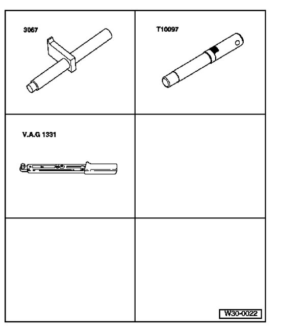

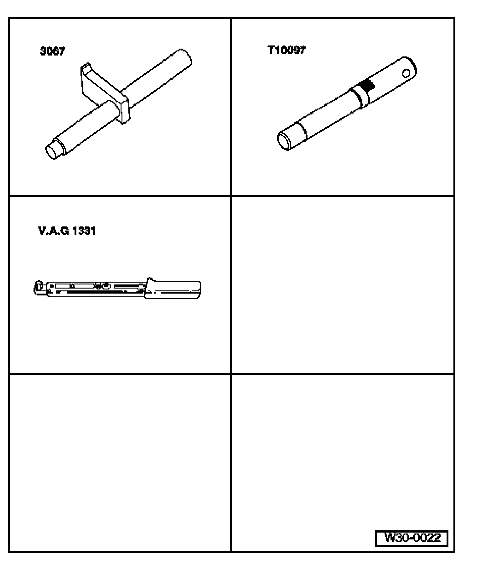

Special tools and equipment
^ 3067 Counter-hold
^ T10097 Centralizing mandrel
^ VAG1331 Torque wrench or equivalent

1 - Flywheel
2 - Clutch plate
^ Centering, Refer to Fig. 1
^ Lightly grease splines
Note: Clean input shaft splines and, on used clutch plates, the hub splines, remove corrosion and apply only a very thin coating of grease, Part No: G 000 100, to the input shaft splines. Then move clutch plate back and forth on the input shaft until the hub moves freely on the shaft. Excess grease must be removed.
3 - Pressure plate
^ Removing and installing, Refer to Fig. 1
^ Check ends of diaphragm spring, Refer to Fig. 2
Note: Pressure plates are protected against corrosion and greased. Only the contact surface may be cleaned, otherwise the service life of the clutch will be considerably reduced.
4 - Bolt Use Parts Supplier to check correct application
^ On two-part flywheel:
^ 22 Nm
^ Always replace
^ On single piece flywheel:
^ 20 Nm
^ Loosen and tighten gradually and diagonally

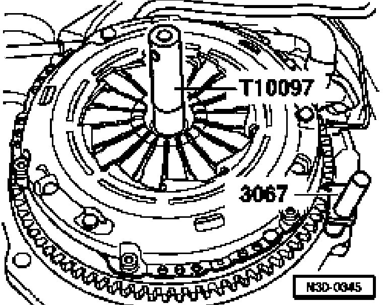

Fig. 1 Centering clutch plate with larger hub diameter and removing and installing pressure plate
^ Loosen and tighten bolts gradually and diagonally.
^ Reverse position of retainer 3067 when removing.
Note: Pressure plate contact surface and clutch plate must make full contact with flywheel. Tighten bolts diagonally and evenly to prevent damage to the centering holes in the pressure plate housing and the centering pins in the flywheel.
Fig. 2 Checking ends of diaphragm spring
Wear up to half the thickness of the diaphragm spring is permitted.
