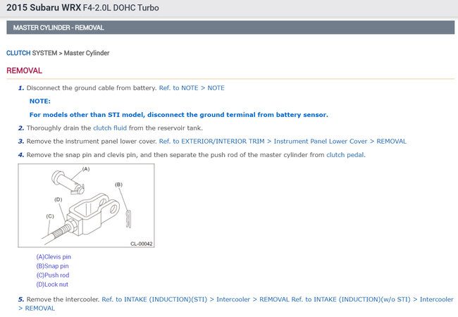

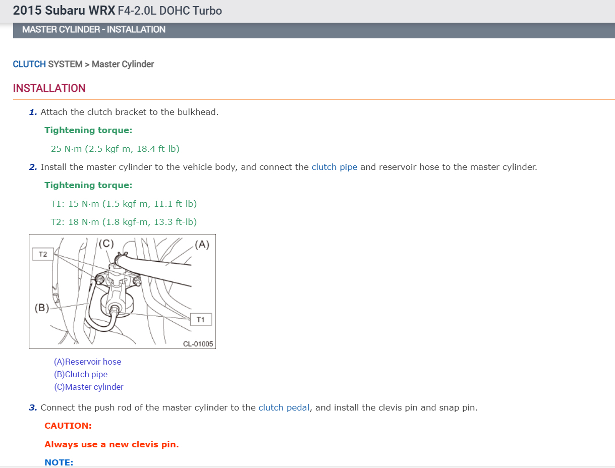

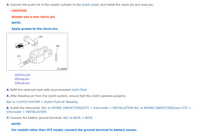

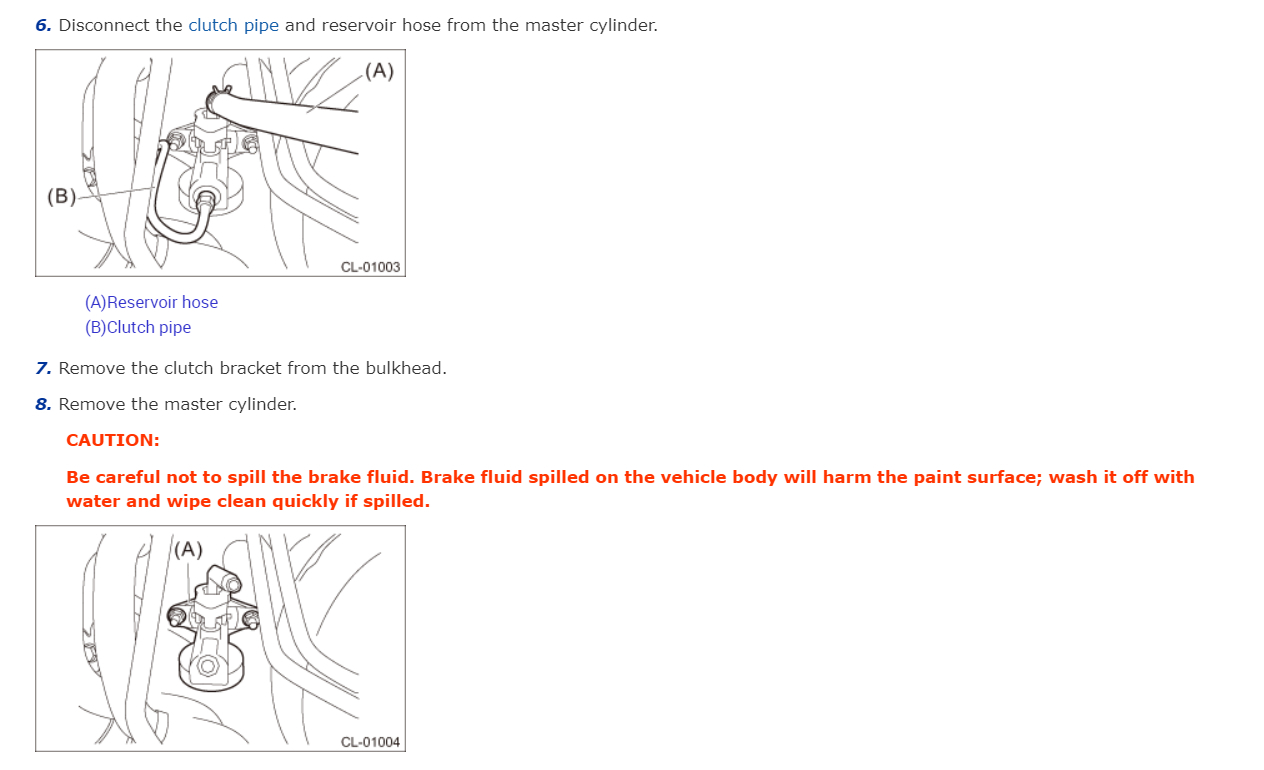

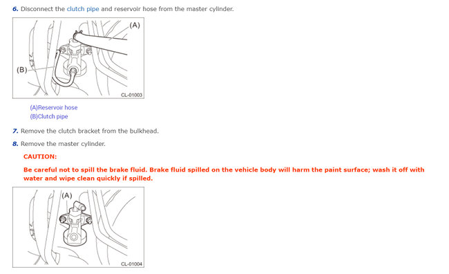

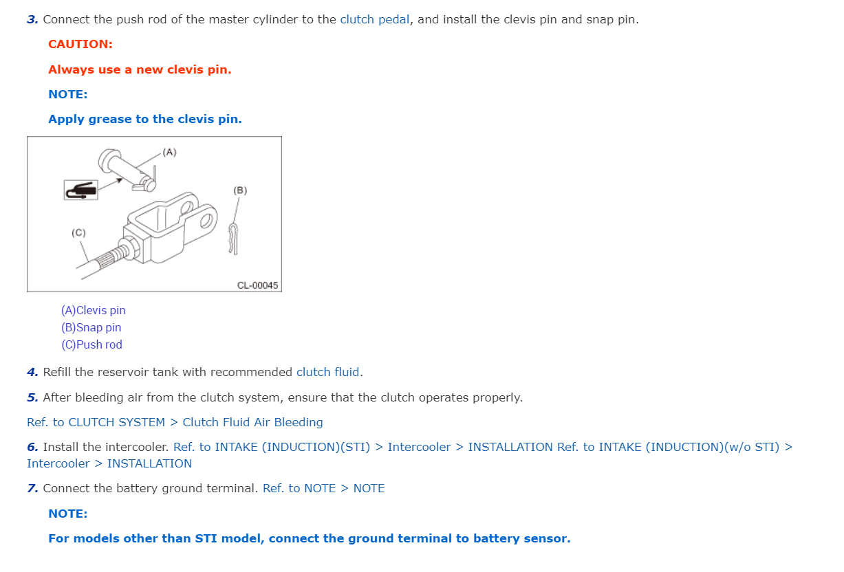

clutch sometimes sticking to the floor, and some halfway out?
2015 SUBARU WRX
80,000 MILES • 2.0L • 4 CYL • TURBO • 4WD • MANUAL
DENZELWRIGHT
Hey, I just replaced my clutch master and slave cylinder. It ran well for a few weeks but now i'm having intermittent problems with the clutch sometimes sticking to the floor, and some halfway out. It seems like the clutch still engages when this happens and i'm able to pull the pedal up with my foot and continue driving
Jul 31, 2022 at 12:50 PM
  • 55,273 POSTS
Do you have any leaks and is the fluid full? If so, the clutch slave has gone bad and needs to be replaced. here are the instructions to do so in the diagrams below. It is easy to bleed once installed because you just fill it with fluid and then pump the clutch pedal about fifty times or until no air bubbles are in the fluid reservoir. Check out the diagrams (below). Please let us know if you need anything else to get the problem fixed.
