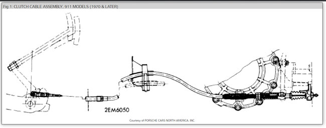

When I got the car listed above S model, it did not have a clutch cable installed.Therefore I have no idea how to hook it up (from pedal-clutch fork).Please show me (especially at the clutch fork) how all the parts go together. PS:I just rebuilt the entire pedal assembly with new springs and bronse bushings.Thank you guys for sharing your expert knowledge.

Here is what we have for the clutch cable, check the diagrams below.
CLUTCH CABLE
There are three types of clutch cables: In 356, 912 and 911 models prior to 1970, cable housing is fixed and does not move. Each end of clutch cable has a clevis and adjuster. On 911 models from 1970 onward, clutch cable is attached to clutch pedal and transmission housing. At clutch end of cable housing, an adjuster with a pair of dogs engages clutch release lever. Opposite end of housing is rigidly attached to center tunnel rear panel. When clutch is depressed, housing moves clutch release lever (see Figure). On 914 and 914/6 models, cable is attached to lever arm and clutch pedal. At clutch end, cable runs around a pulley to reverse direction of cable pull.

Removal 911 1970 & Later
Loosen lock and back off adjuster at clutch release lever. Pull clevis pin at clutch pedal.
Pull cable and housing out of cable guide brackets. Disengage cable housing from clutch release lever and disconnect cable from transmission. To install, reverse removal procedures.

Thank you for your expert advice. However, there are several nuts and a rubber boot etc., that have to connect at the fork. Could you please illustrate exactly how they hookup and if there is a return spring at the fork. Thank you.
