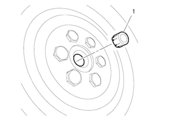

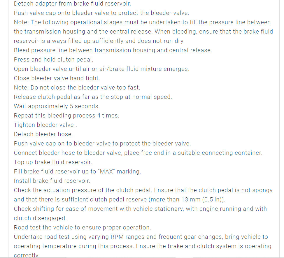

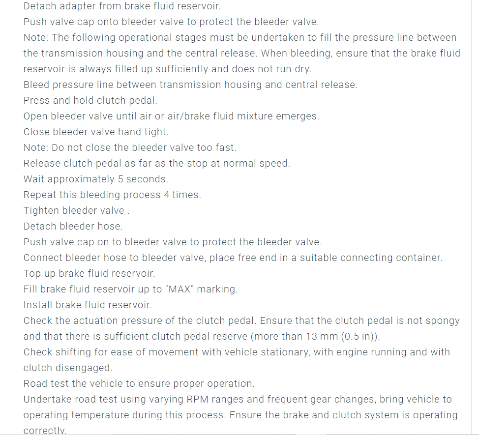

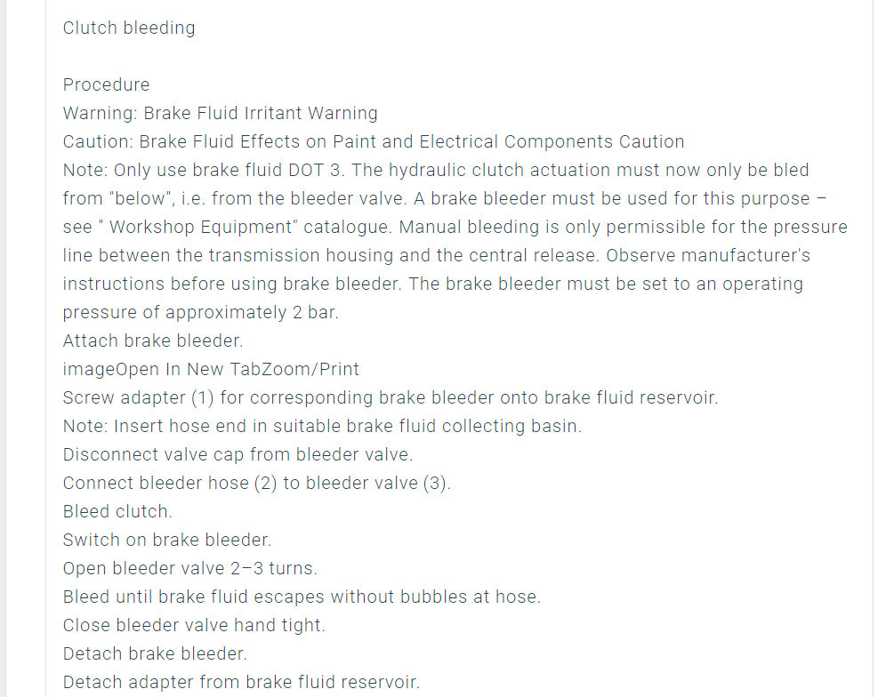

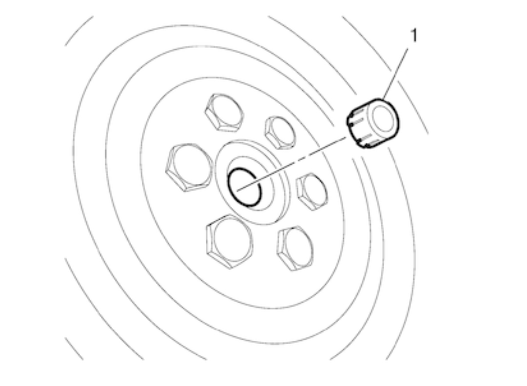

6. Air in the hydraulic line for the clutch. I attached the bleeding process for you to check for no air.
