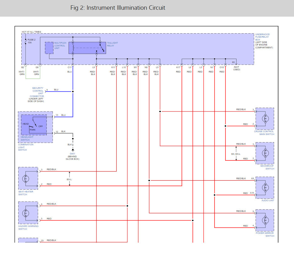

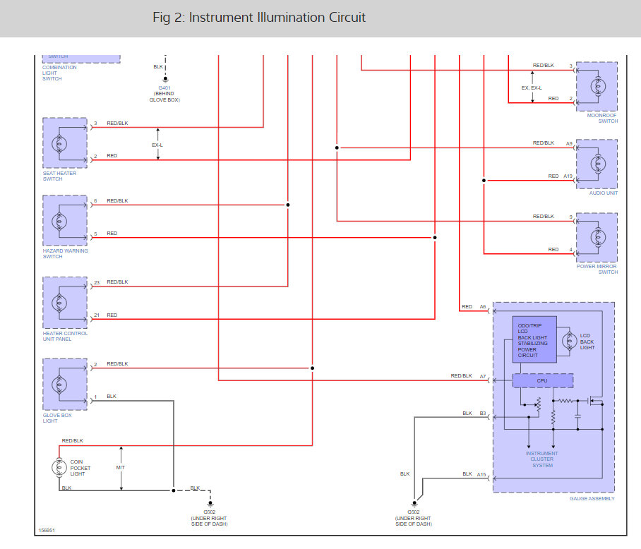

Hi Ken, thanks for responding. No, it’s not the adjust knob, also trip knob doesn’t do anything either. I’ve noticed the HVAC lamps are out too. I replaced the combination headlights controller because I could hear a relay click when turning the lights on, maybe a ground issue? I thought the cluster itself was bad, but I’m not sure. And something new showed up on my scanner, something about the gear selector being in between drive and another gear. Checked when park it’s in park and so on. Thanks

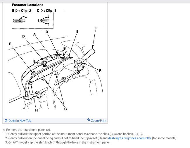

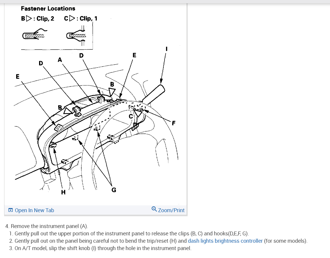

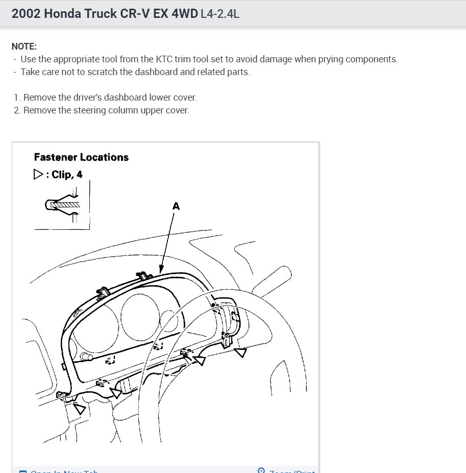

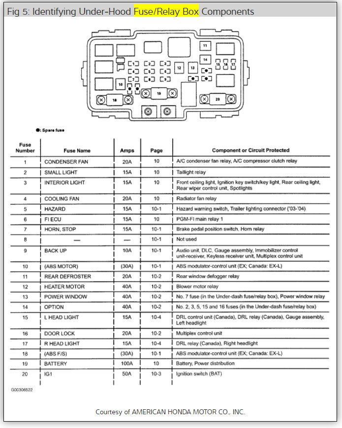

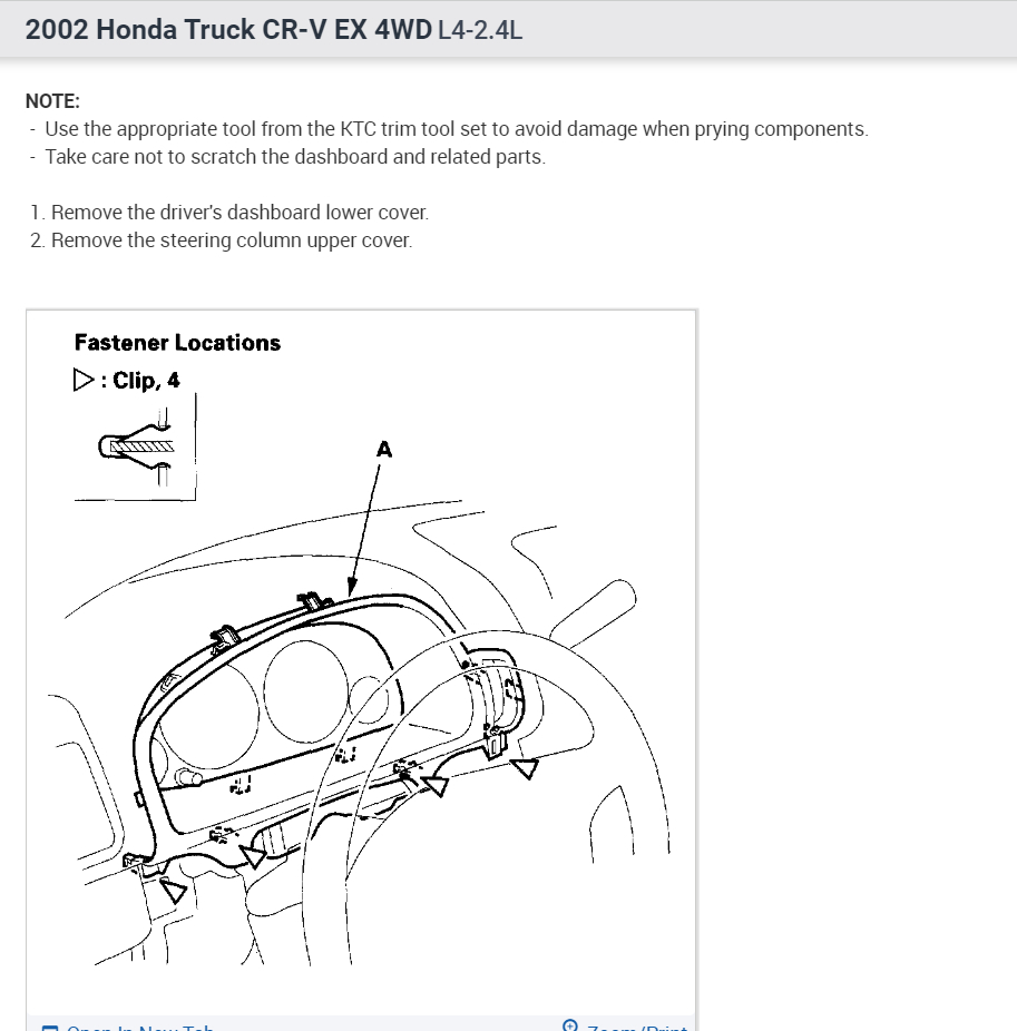

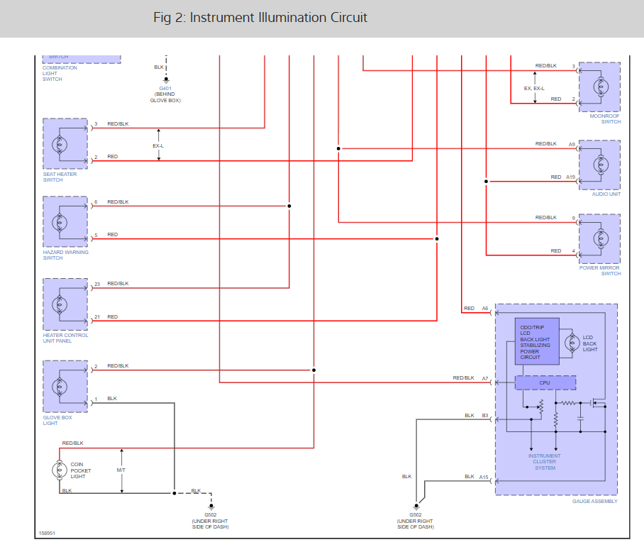

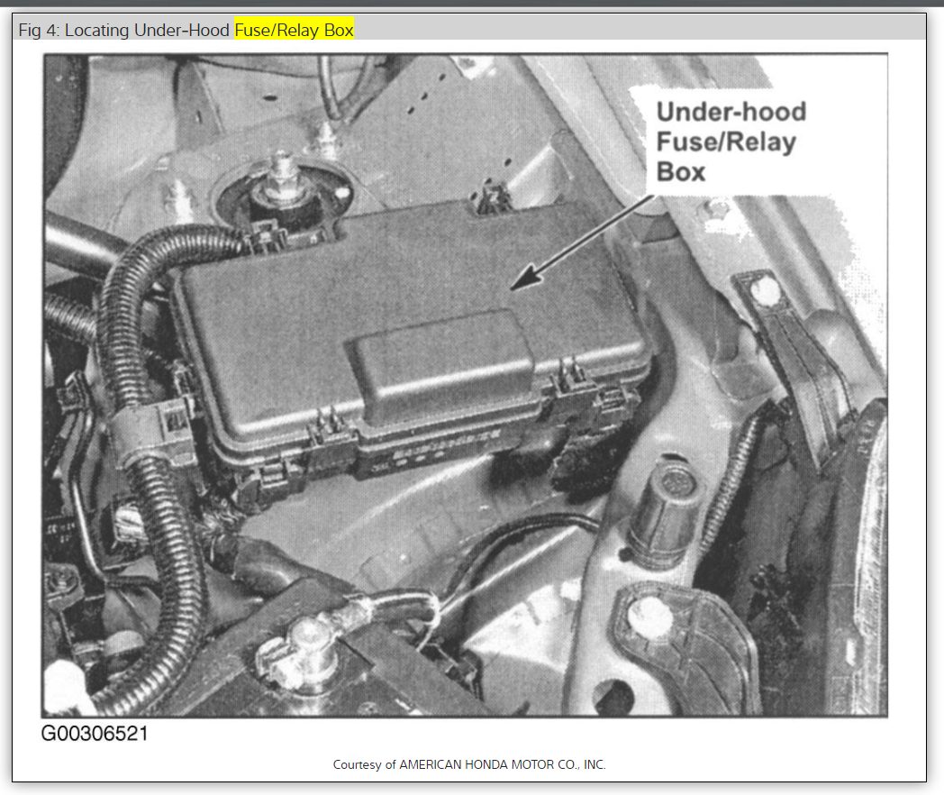

There is a CPU inside the instrument cluster that sounds like it is out, you can get a rebuilt cluster by searching google or eBay but I would check the fuse # 2 in the under hood fuse panel, here is a wiring diagram for the lighting system for the cluster in the images below and how to change out the cluster. Please let us know what you find.
