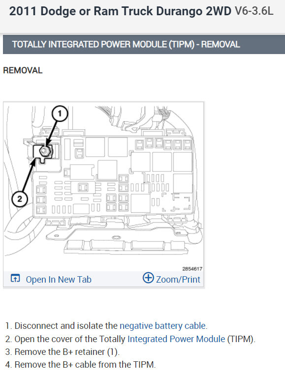

My vehicle listed above dash cluster goes out when I accelerate, and I lose ability to shift my windshield wipers turn on and pretty much nothing electrical works.

You could have an alternator that has a diode out which can then charge the system with AC voltage which can cause the issues you are describing.
Here is a guide to help you test for AC voltage, please read completely:
This will also help test the voltage output which if it is too high can cause electrical accessories to shut down. If everything is okay, I have seen the TIPM go out on these cars but to be sure let's run a CAN scan. You can get a CAN scanner (Controller Area Network) which will work on most cars from Amazon.
https://youtu.be/u-4syLc-ifQ

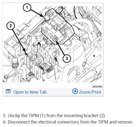

Here is how to change out the TIPM which is easy because it-self learns and there is no programming. Check out the images (below). Please upload pictures or videos in your response of any problems so we can see what to help you with.

After replacing the TIPM nothing changed. Windshield wipers still going crazy along with everything electrical and not allowing the car to shift.
