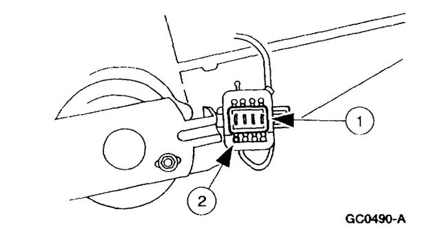

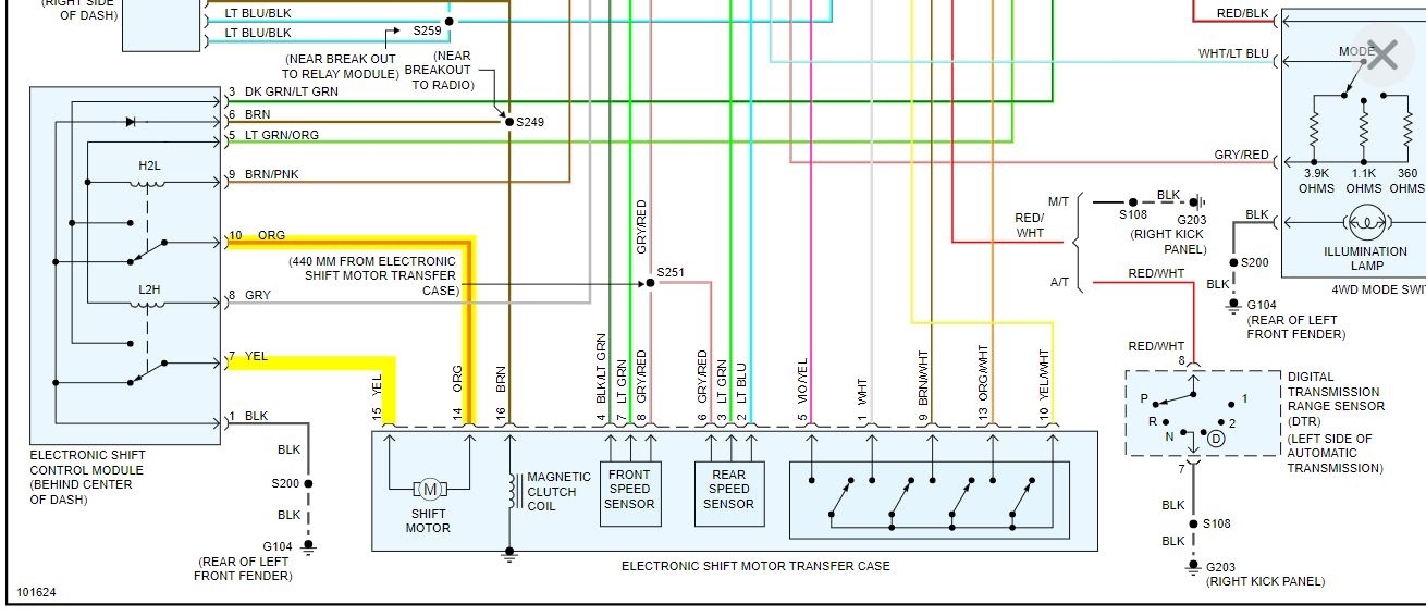

4 wheel drive was working great then all of a sudden went to back out put it in four wheel and it made a clunk and now it won't work so there is no four wheel drive now. We have about a foot or more of snow. do you know what could be the problem? it's a switch on the dash that puts it in four wheel drive.
Jan 18, 2020 at 7:07 AM
Good evening,
This could be the actuator motor on the transfer case but needs to be confirmed.

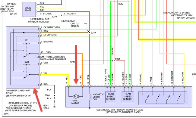

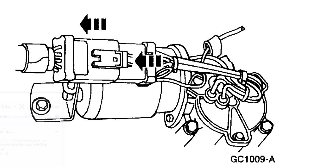

I attached a diagram and some other information for you. You need to test for voltage to the motor when commanding 2 or 4 wheel drive.

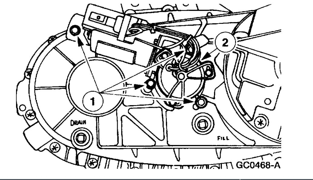

Removal
WARNING: The electrical power supply to the air suspension system must be shut off prior to hoisting, jacking or towing an air suspension vehicle. This can be accomplished by turning of the air suspension switch located in the rear jack storage area. Failure to do so can result in unexpected inflation or deflation of the air springs which can result in shifting of the vehicle during these operations.
1. Raise and support the vehicle.
2. Disconnect the electrical connector.
3. Remove the coil wire from the electrical connector.
1 Remove the connector interlock.
2 Remove the coil wire pin.
Use the proper electrical connector pin remover.
4. CAUTION: Note each sensor wire pin location for correct installation.
Remove the front and rear output shaft speed sensor wire pins from the electrical connector.
5. Remove the transfer case shift motor.
1 Remove the four bolts.

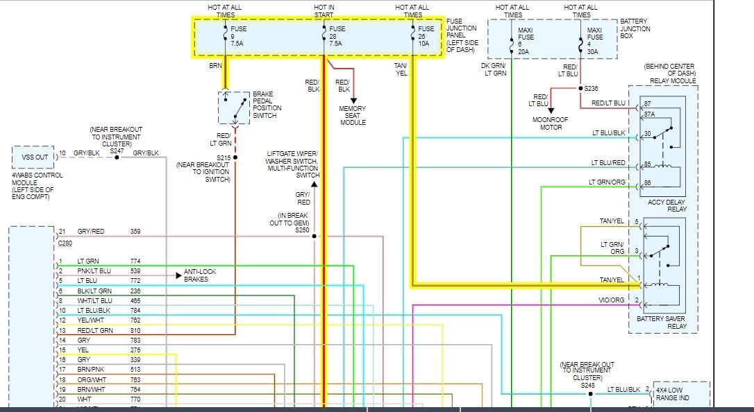

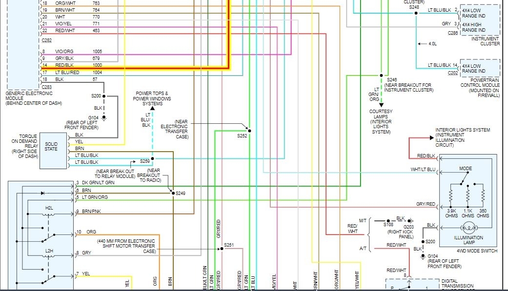

HMAC300
  • 48,601 POSTS
check the shift relay and see if motor gets power through both ways then scan for codes auto parts can for free if a code get back to us. It can also be the GEM module bad for that as well. See picture on location and what wires to check on motor on t-case.
