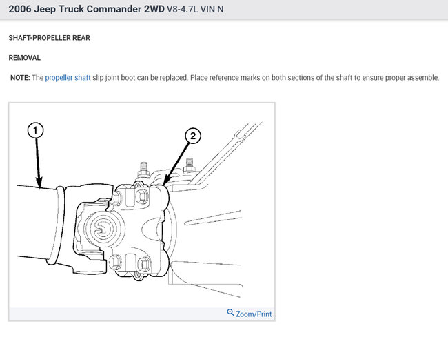

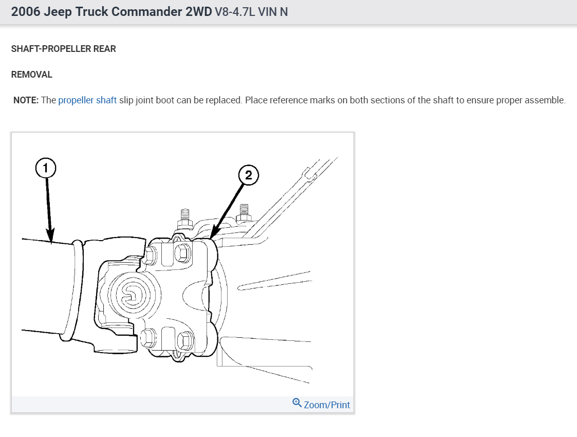

This sounds like a typical drive shaft U joint that has gone bad. Here is what they look like and do and diagrams below to show you how to fix the problem on your car. Look for rust colored dust around the joint a sign it has gone bad.
https://www.2carpros.com/articles/how-u-joints-work

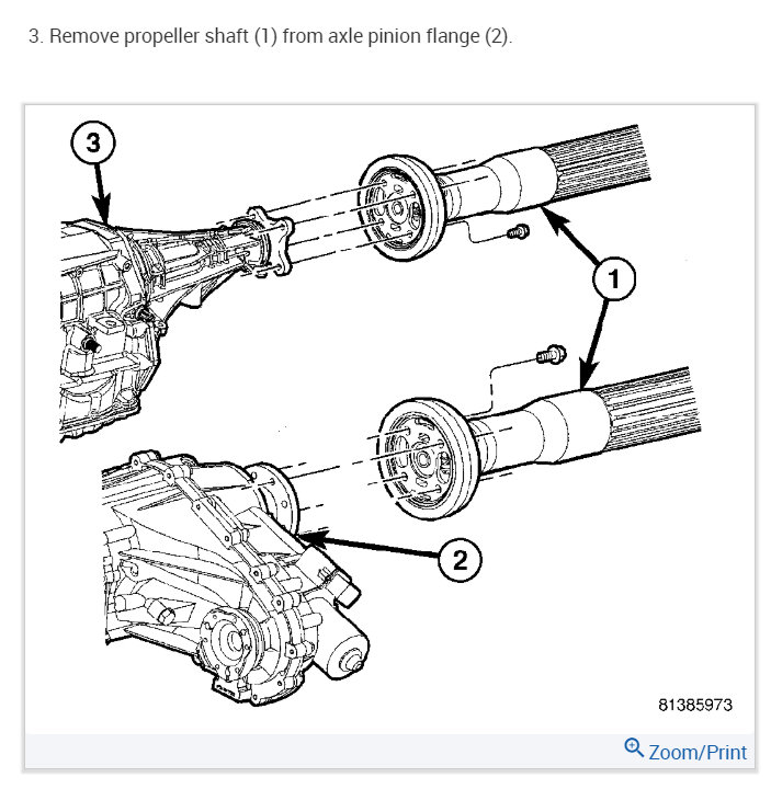

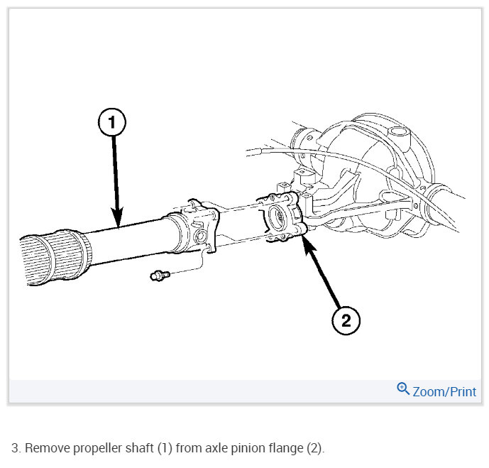

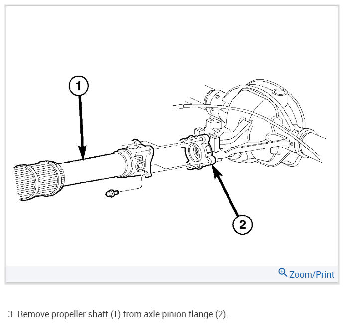

You will need to remove the drive shaft.
https://www.2carpros.com/articles/how-to-remove-a-drive-shaft
There is a flex coupler at the front of the shaft that needs to be looked at as well. If you see the rust colored dust take the shaft to an auto parts store there than can replace the U joint for you. You might need to jack the car up using jack stands.
