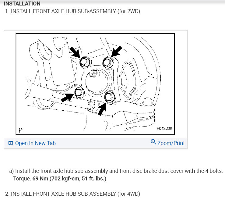

Recently I replaced two-wheel speed sensors in the front of my car after the ABS light came on. Afterwards, though, every time when I first start driving my car it makes this clunking noise and feeling that goes away after 2-3 seconds and doesn’t occur again while driving. It only happens when the car has been turned off and has stopped moving after a while. I know it’s not my tires as it did it with my old ones too and just replaced them. Also, my car is AWD.
Aug 18, 2023 at 2:26 PM
  • 55,433 POSTS

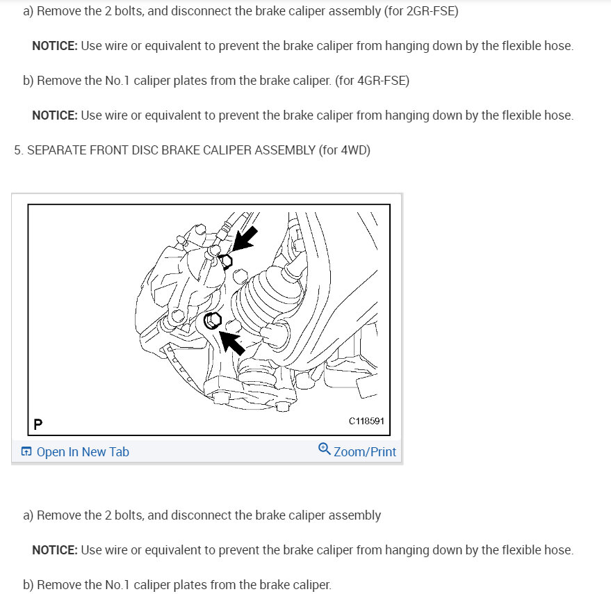

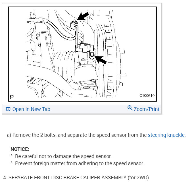

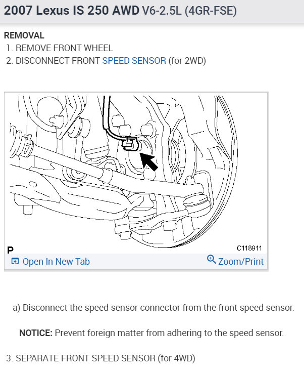

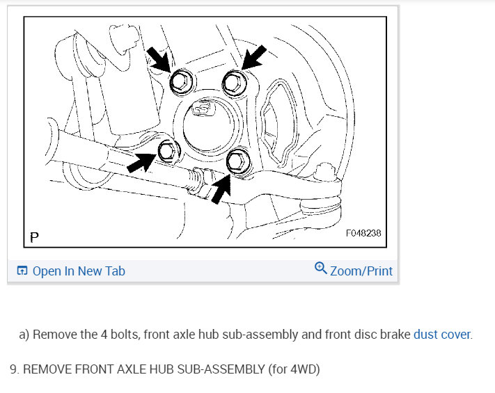

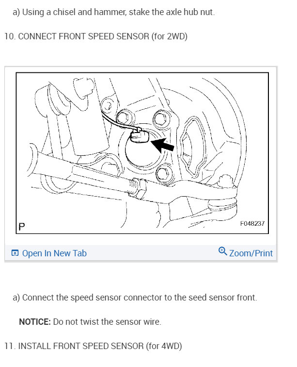

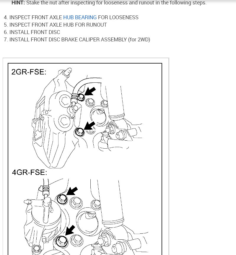

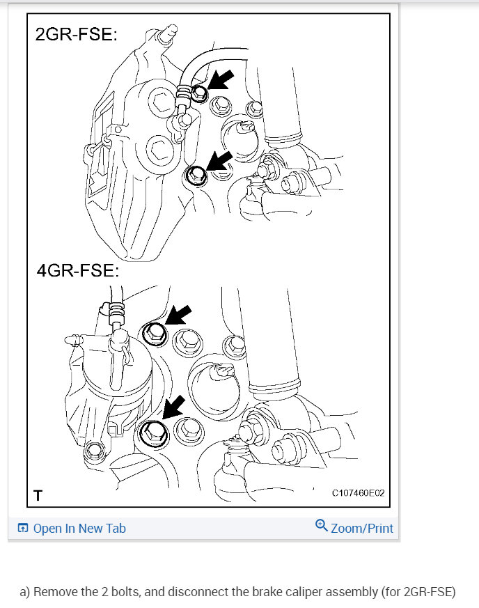

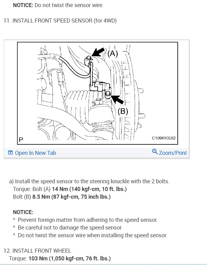

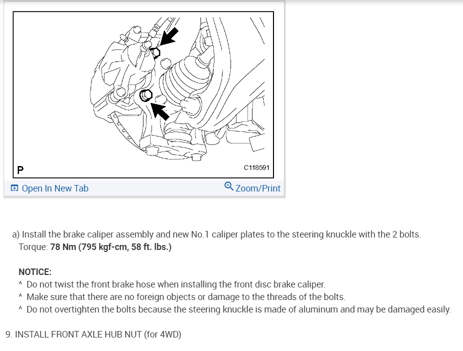

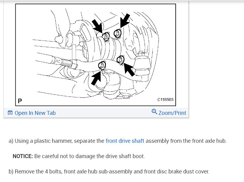

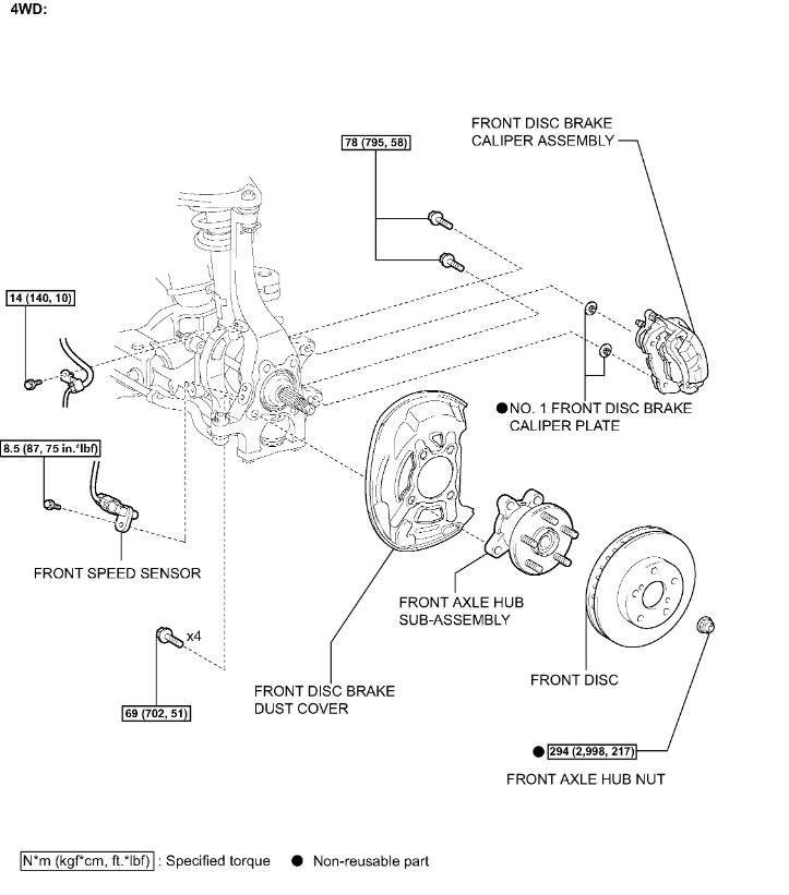

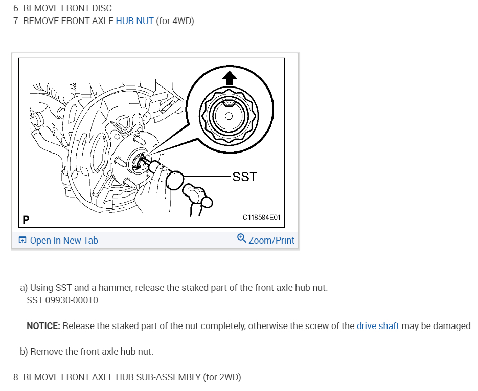

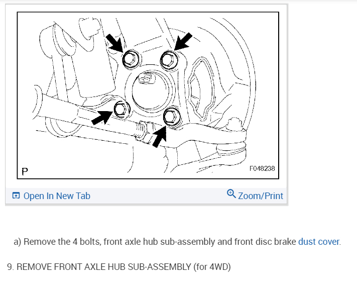

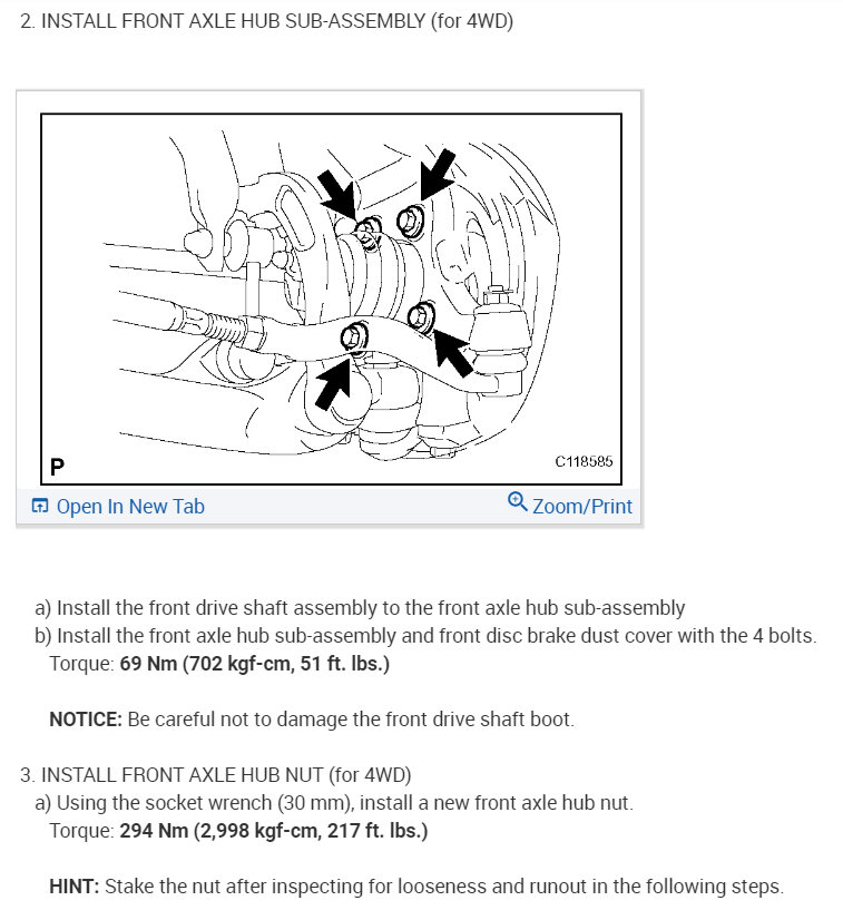

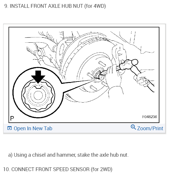

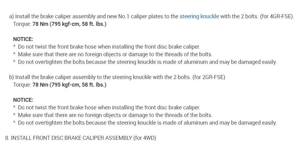

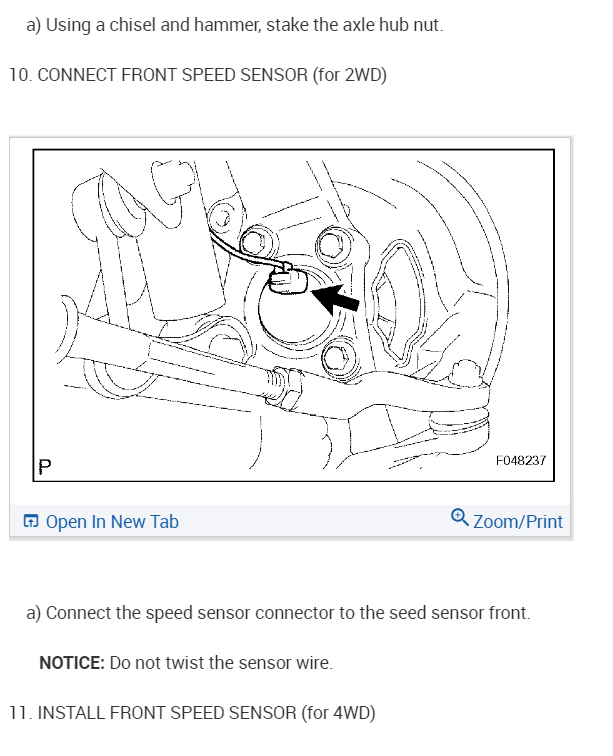

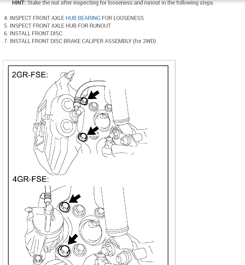

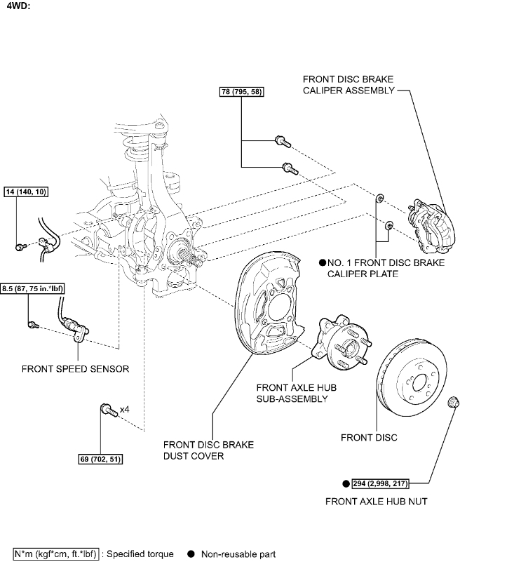

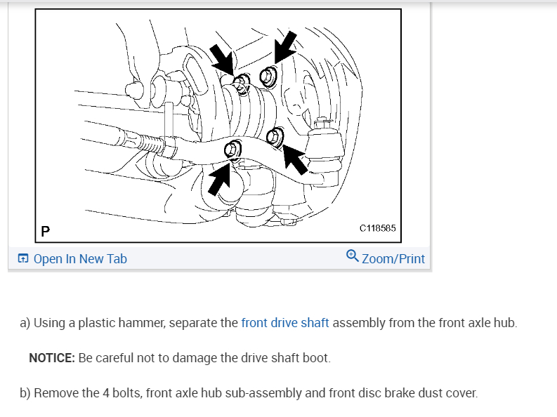

Chances are it is the front bearing hubs which is common. Can you please shoot a quick video with your phone so I can hear the noise? That way I can tell for sure what's going on. You can upload it here with your response. Here is how to change the front hubs out. Check out the images (below). Please let us know what happens.
