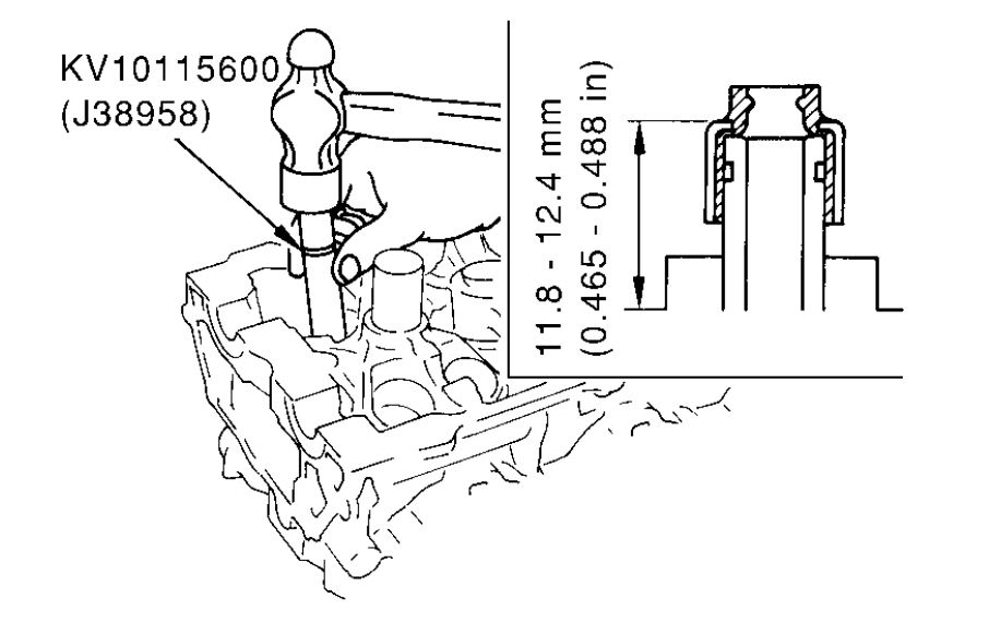

When I start my engine from long periods of rest (overnight mostly), it fills up the place with visible smoke and then ceases to do so after about a minute, two max of idling. This is rather troubling as it only did this twice or thrice a week but ever since I had a mechanic change my engine oil and leaky top engine seal, it's become an everyday issue. It can get rather embarrassing.

What color is the smoke?
White is burning coolant.
https://www.2carpros.com/articles/white-smoke-or-steam-coming-from-the-exhaust-pipe
Blue is oil.
https://www.2carpros.com/articles/blue-smoke-from-engines-exhaust
Black is excessive fuel.
https://www.2carpros.com/articles/engine-black-smoke

Hey. The smoke is blue in color from the examples you sent me. The engine oil dipstick shows my oil change is actually on the high point. Could this be the problem?
Jun 9, 2020 at 6:55 AM
No, most likely it is valve seals. When they are bad, oil goes down the stem of the intake valve and settles into the cylinder on an overnight sit.
When you start it up, the oil burns off and does not smoke again until the next start with a long sit time.

Okay, I would have the oil changed and install a heavier grade oil installed. That could very well stop smoking.
If you do not use any oil between changes, I would not do anything unless you start using oil.
Any shop can do this for you.
