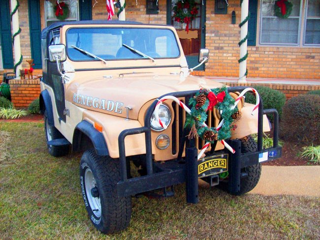

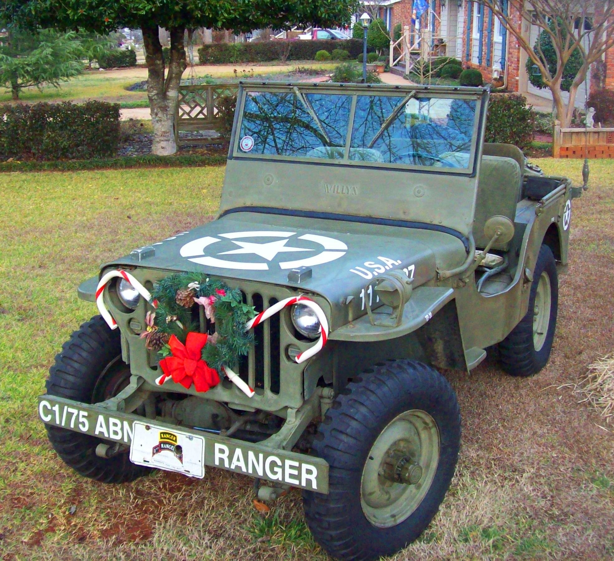

I have two Jeeps. Kind of the same problems as yours.
I have two chloroplast signs (corrugated cardboard looking plastic). One is half the size of my radiator (for twenty to thirty degrees), the other is three quarter the size (for the "teens"). I simply shove the "needed" one between the grill and against my radiator. This keeps the radiator water kinda warm to circulate back in. Thank goodness that it is never that cold very long here.
