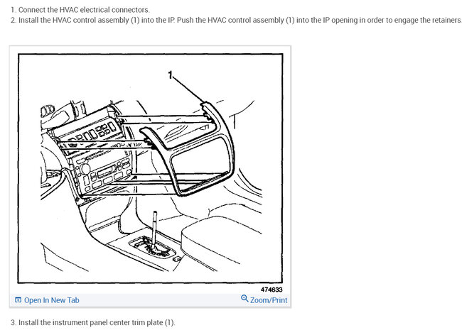

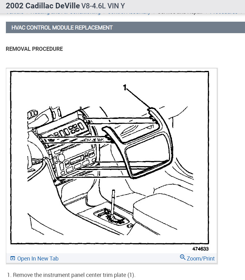

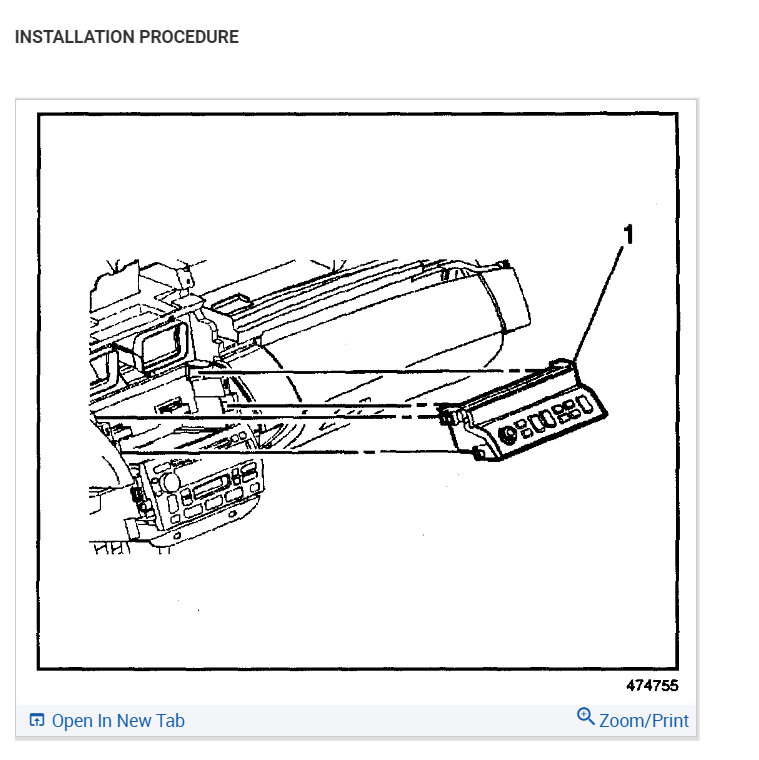

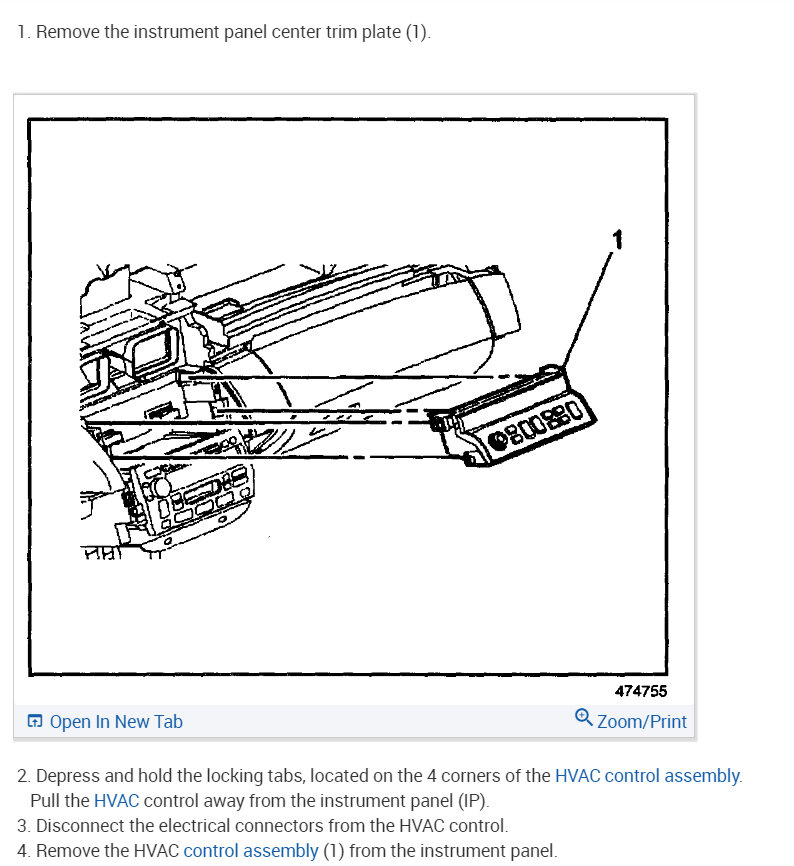

It sounds like the HVAC controller needs to be replaced here are instructions on how to do the repair. Check out the images (Below). Please let us know if you need anything else to get the problem fixed.
Apr 4, 2023 at 10:27 AM (Merged)
