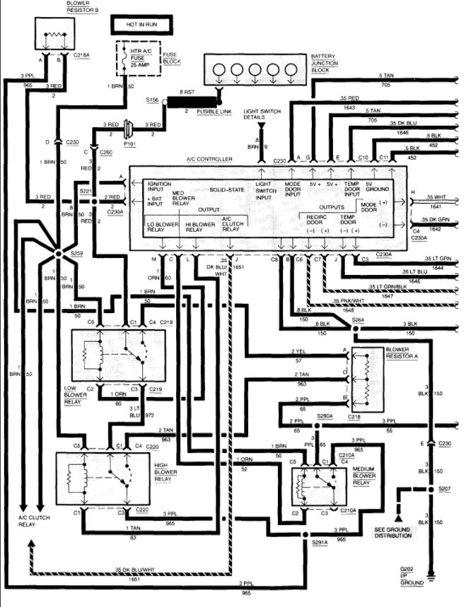

Hi, the AC/heater control went out. No display or power. I checked the 25 amp fuse and that was fine. I then tried two different used modules (from junk yard) and still did not work. I know they both could be bad but one should be good. How do I identify power and ground contacts for cleaning? Anything else that could make entire control go bad? Can PWB in control module be repaired? Thanks

It is powered by a fusible link, probably at the starter or a power distribution block on the firewall.
+1
Sunday, July 23rd, 2017 AT 7:52 PM
WRENCHTECH
  • 20,761 POSTS
Here is the wiring diagram.
Sunday, July 23rd, 2017 AT 7:55 PM

Usually you will find the ends of them where they are bonded into the main harness covered with thick silicone seals. The one you want will be rust colored and comes out of the battery junction box.

No, use a test light or voltmeter. You are looking for voltage beyond the link.

I checked the voltages at the connector at pin 12 and A(Battery and Ignition) and had 12V on both. I assumed the 2 used control units were good but I'm thinking maybe they are bad.
Attention Kmart shoppers, I still need help.I have tried 5 used modules. We have verified ignition and battery power and that we have a good ground to connector. But still no display or operation.

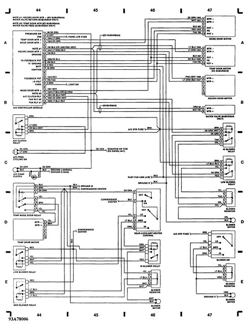

You must have a wiring issue, here is a guide and a wiring diagram so you can do some testing.
Monday, July 31st, 2017 AT 11:16 AM
OPPER79
  • 7 POSTS
I thought the ground at the connector was good, but it wasn't. I tapped into the ground wire and ran another so I have the display lit up on module. I try different buttons on control unit and I can hear the relays clicking but I have no fan or air. Any ideas?
