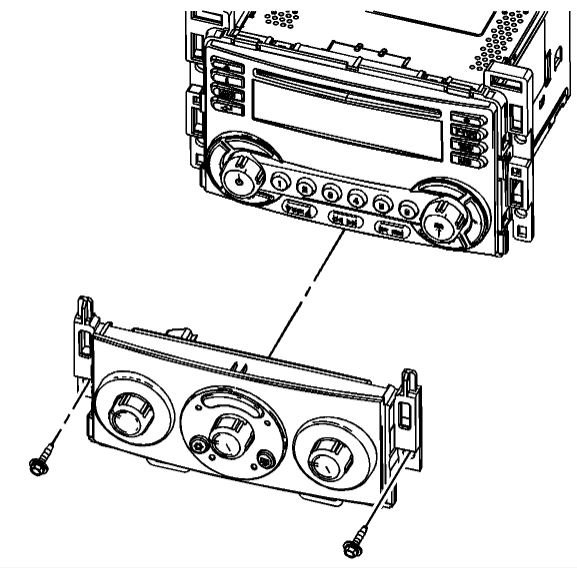

My blower works fine on all four levels I get no heat no A/C and cannot change from floor to defrost to dash vents. The lights on the climate module are off when this happens. I can play around with the blower motor setting and sometimes get the lights to come on on the climate control module and everything works fine at that point but lights will go out seconds or minutes later and nothing works again except blower motor. Could this be a bad Climate Control Module? if so how can I test to make sure?

It could be a bad module, but it sounds more like a bad connection either the connector itself or more common a bad solder joint on the connector in the module. Especially when you can move the controls and it wakes up. Try a couple gentle taps around it when it isn't working, if you see it flicker or it comes on that would confirm the loose connection.
To determine which you can easily remove the controller. You remove the center trim from the stack and the two screws for the control. Then pull it out and check the wire connection on the back. If it is loose you can try putting it back on. If you remove the connector and find a loose pin or similar there are a few things that can be done, they are not hard to re-solder or just hit a salvage yard and get a replacement. Or you could send it out for repair.

Already have module out connections were not loose, unplugged and checked pins. inside connectors they looked fine. When it's not working I will move the fan speed selector very slowly from high to low and when I go from 0 to 1 slowly occasionally the lights on climate module will come on and it works properly. It might take 15 to 20 times doing that to get it to work, but again I might try 30 minutes or more and get nothing. Very strange.

That still sounds like a bad connection, but at board level. It can be very hard to see them unless you have a lot of practice looking at bad soldering on automotive items. However if it is confined to the blower speed area that is where I would look first. Bad solder joints can look perfect but have cracks that are microscopic and cause failures. Something you might try would be to spray some contact cleaner into the potentiometer and then see if anything changes. If not then it's going to take some soldering and for that you need to have practice as it's very easy to damage the copper traces on those boards. There are multiple YouTube videos showing how to reflow the solder on them but some of the better ones are from
