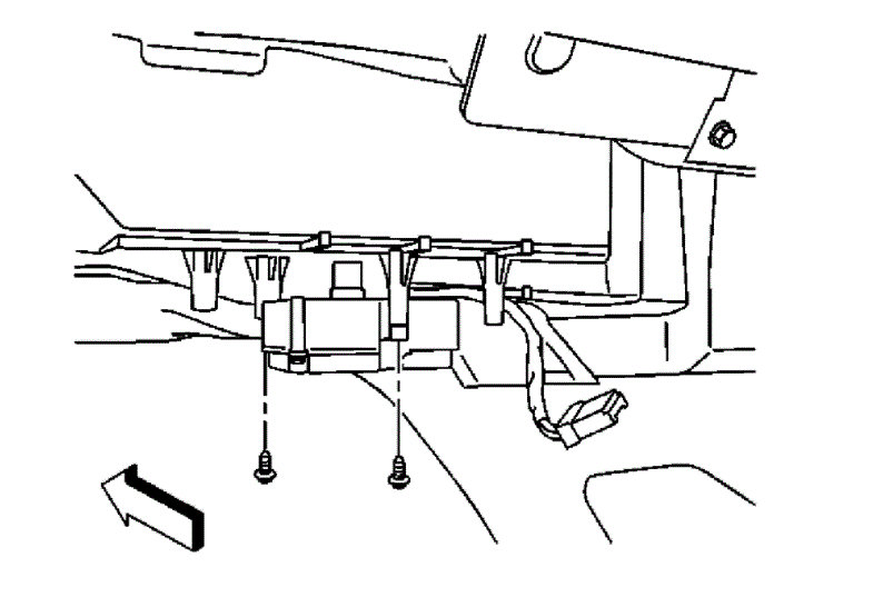

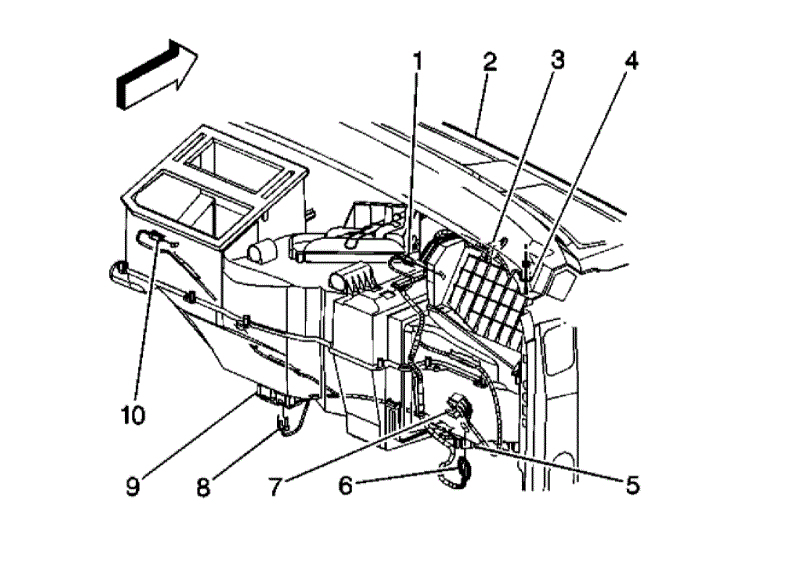

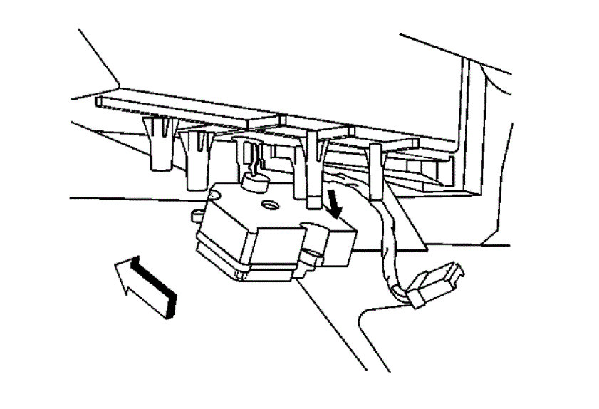

Another possibility for no heat is a blend door actuator. If it is not moving the door to give full heat, this will result. It is also tied to the A/C operation as well.
REMOVAL PROCEDURE
1. Remove the IP insulator.
2. Disconnect the electrical connector (8) from the air temperature actuator (9).
3. Remove the air temperature actuator retaining screws.
4. Remove the air temperature actuator.
