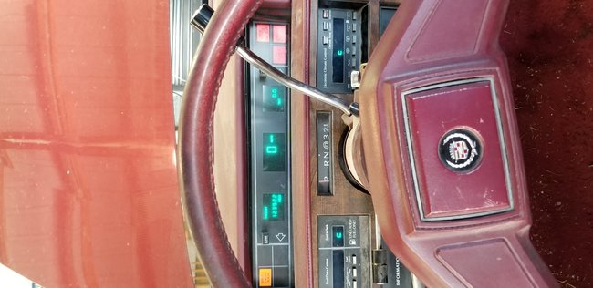

Recently purchased this car. Yesterday we ended up putting a new battery in it because the old one, which was supposedly "new-ish", only tested out at nine volts. This solved the problem of the car not starting regularly but the next problem is the big issue. When you start it up, the climate control center and fuel data center readouts only display a small "c" on them. I tried a little research on the old internet and found the diagnostic testing by holding down the "off" and "warmer" buttons on the climate control center for three to five seconds which did not work for me. However, after pushing and holding different combinations of buttons for the three to five seconds I was able to get the displays to work on both the climate control center and fuel data center. However, it did not last and the small "c" returned after the very next start-up. Here is a little more information, the blower comes on automatically at start-up and air can be felt coming out the front floor vent but there is no way to control it as the buttons do nothing when pressed and there is still no display on the climate control center, other than the small "c" that is.

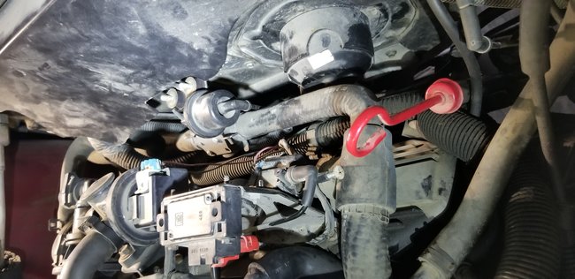

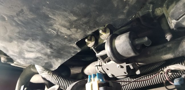

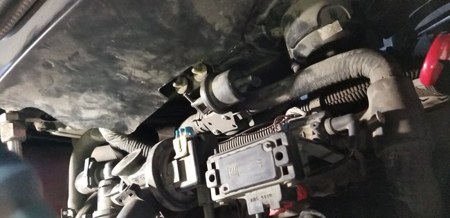

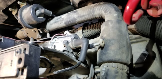

After checking under the hood, we noticed there is an 8" vacuum hose with a screw stuck in it because it is not attached to anything else and there appears to be something missing behind the MAP sensor up by the firewall as there are two threaded studs with rubber spacers and nothing attached or connected there. We have looked for pictures to clue us in on what should be attached but have had no luck yet.

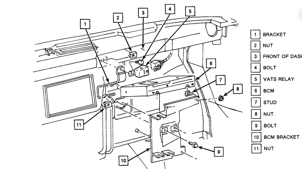

The most common failure for this is the body control module. It controls both displays and is a common failure.
Try tapping on the unit with the key on and see if the display comes back.

I was talking about the body control module I sent you are the picture of. Not the display unit at all. They very rarely fail.
Three of the four pictures are under the hood and have nothing to do with your current issue.

Got to the BCM behind the glove box.The pictures under the hood were meant to be included with the original problem that detailed issues with vacuum lines. We are currently chasing multiples problems. Changing out spark plugs now and will check the climate control display when we reconnect the battery.

Turned it to run and heard some clicks coming from the BCM and the displays still showed the small "c" so probably going to have to get a new BCM.
May 27, 2018 at 5:26 AM
Yep, sounds about right.
