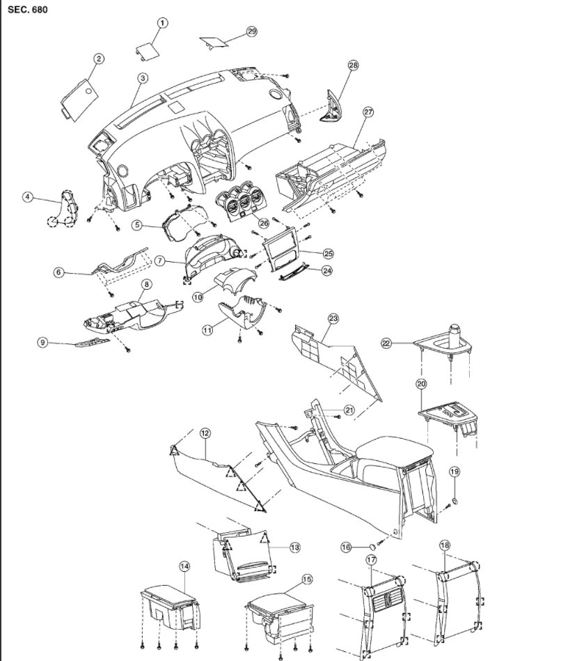

temperature control passenger side will not stay at sixty degrees. the button is stuck in the up position. WD40 did not help.
Feb 23, 2018 at 1:25 AM
  • 55,694 POSTS

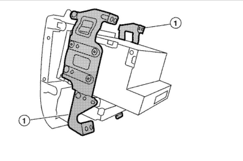

I would remove the unit to take it apart to help unstuck the button. If the button is broken you will need a new unit which I would try to get one used. You will need to have the HVAC module programmed tot he car to have it though $130.00 at most shops.
