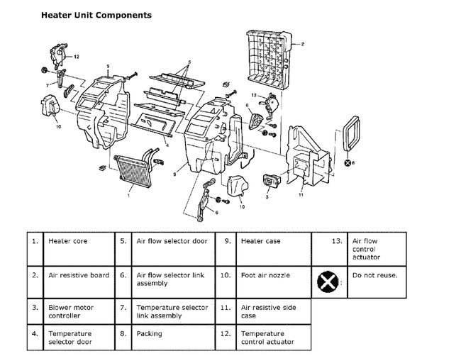

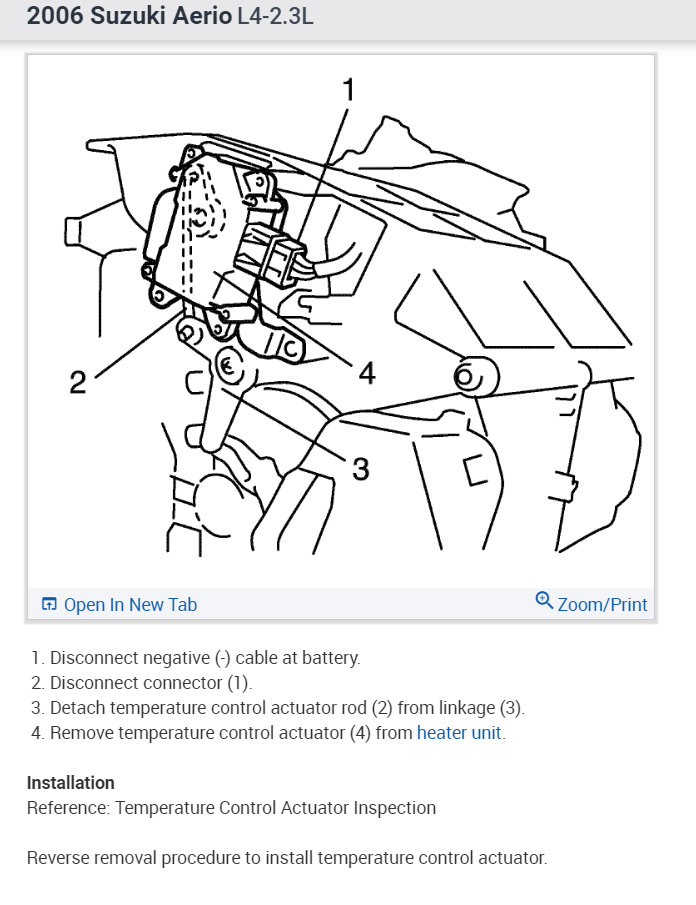

It does sounds like the drivers side actuator is not working. here is a guide to help walk you through the repairs with diagrams for your car below. Do you have dual climate control?
Check out the diagrams (below). Please let us know what you find.

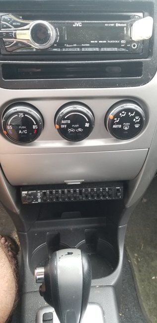

Can you take a picture of your climate controls so I can see them? If it is just one side not working it is either a blend door actuator or inside the heater plenum a door has broken which means the plenum will need to be replaced. You can upload the picture in your response.

This is the climate control.
Jun 24, 2019 at 8:17 AM
  • 55,433 POSTS

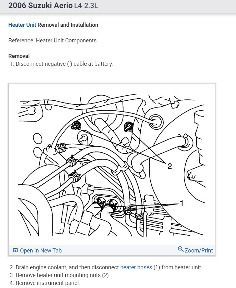

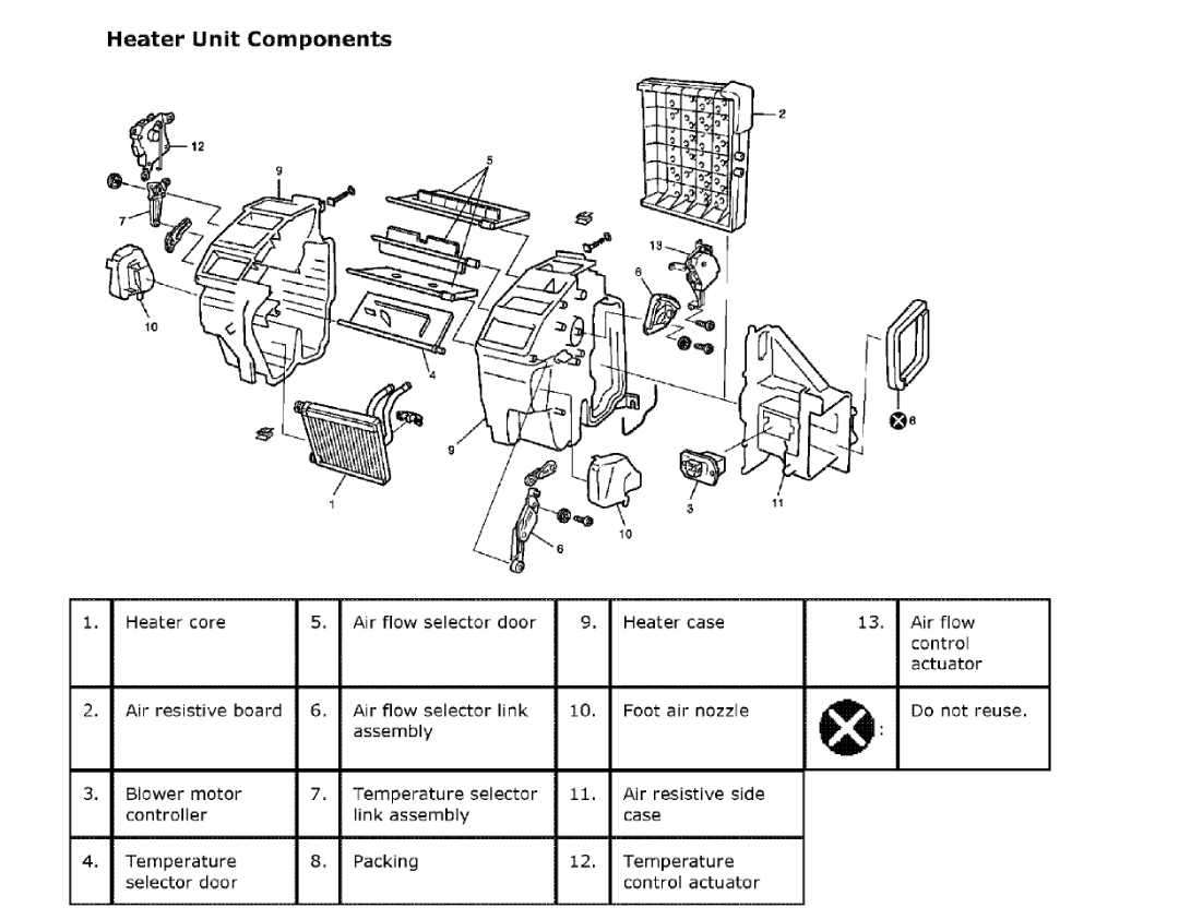

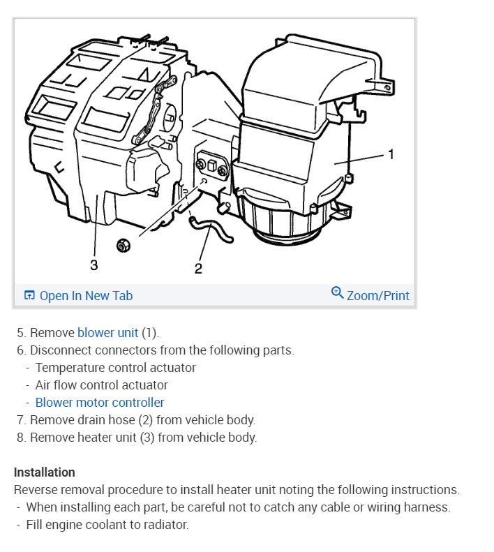

Yep, signal control. It looks like you have a broken blend door. you will need to remove the heater plenum. here are instructions and diagrams to help you get the job done. Start by draining the coolant and disconnecting the battery. Also you will need to discharge the AC system. here are guides to help check out the diagrams below.

Did you try removing the blend door actuator and moving the pivot to see if the temp changes? It sounds like you have a blend door that has broken internally.
