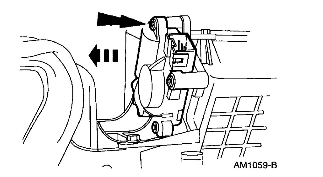

My climate control seems to blow warm/hot air after the car is warmed up and it sometimes seems like the air intake is restricted. The A/C compressor works and cycles on and off but does not blow cold air. Even in the vent position with the temperature set to 60 degrees, warm air comes out of the vents.
May 11, 2020 at 7:50 AM

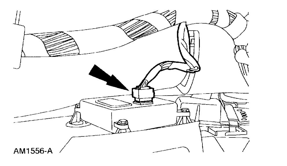

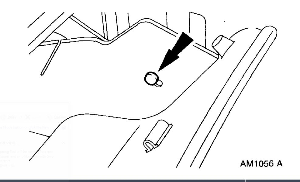

Good evening,

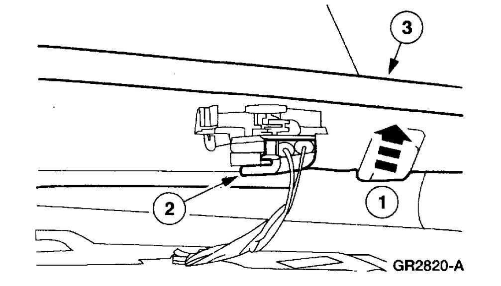

This sounds like the fresh air door is stuck open. The actuator is right behind the glove box.
I attached the pictures and the procedure is below for this procedure.
REMOVAL
1. Disconnect the glove compartment door damper cable.
2. Release the stops and lower the glove compartment door to the floor.
3. Disconnect the wire harness connector.
4. Remove the four screws and remove the electronic recirc door actuator.
INSTALLATION
1. Follow the removal procedure in reverse order

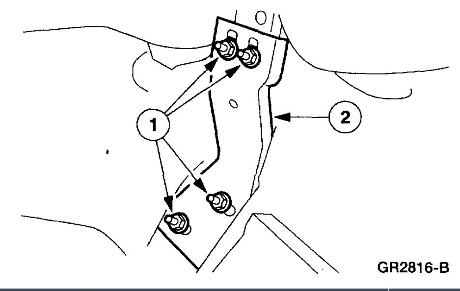

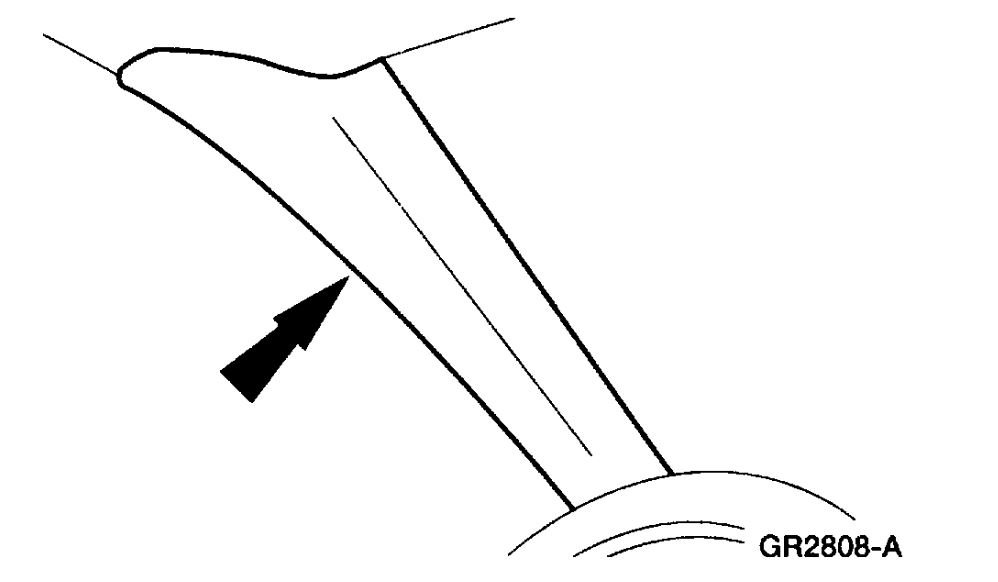

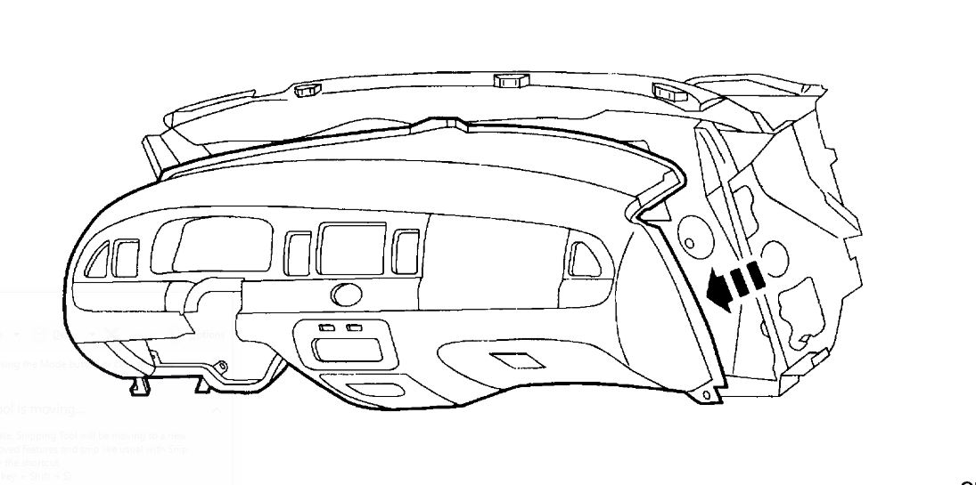

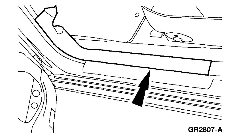

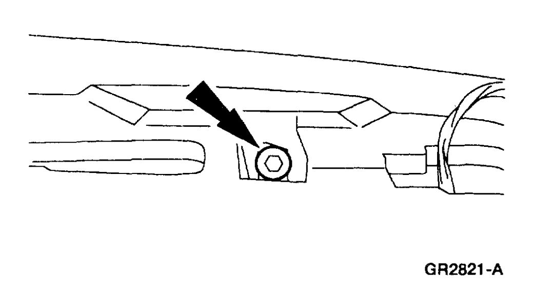

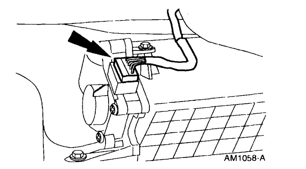

Okay, the volume issue could be either a blower motor issue with the cage on the end or a leak in the duct work in the vent system.
https://www.2carpros.com/articles/blower-fan-motor-works-on-high-speed-only

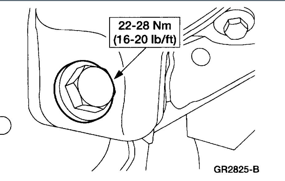

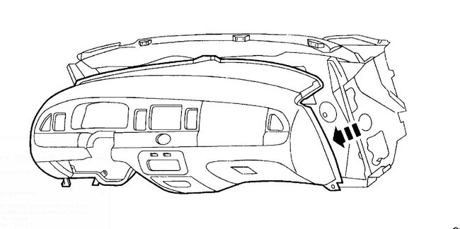

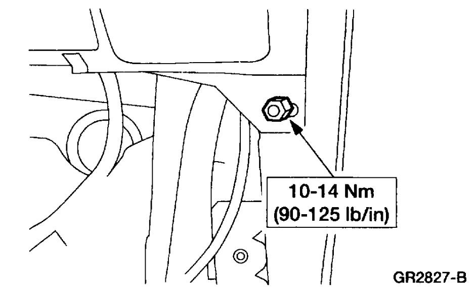

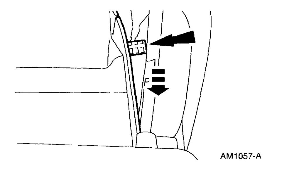

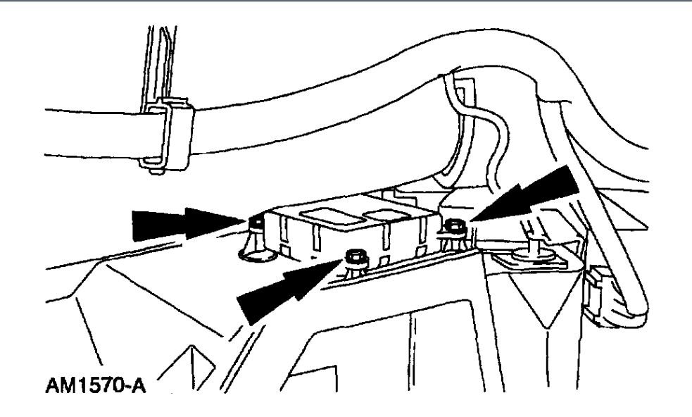

As far as the warm air, there is a blend door motor on the A/C unit. It is at the top of the dash requiring the dash board to be remove to access it. That is a common failure for this and the code you got from the A/C control head.
I attached the procedure below and pictures for you as well.
REMOVAL
1. Disconnect the battery.
2. Remove the instrument panel steering column cover.
3. Remove the RH and LH instrument panel lower insulator panels.
4. Remove the steering column opening brace.
5. Disconnect the steering shaft universal joint.
6. Remove the RH and LH cowl side trim panels.
7. Release the glove box door, and remove the two screws from the center instrument panel support.
8. Remove the instrument panel defroster grille.
1. Unclip the instrument panel defroster opening grille.
2. Disconnect the connectors.
3. Remove the instrument panel defroster opening grille.
9. Remove the RH and LH upper moldings.
10. Remove the three instrument panel cowl top screws.
11. Remove the RH instrument panel cowl slide nut.
12. Remove the upper LH instrument panel cowl side nut.
13. Remove the lower LH instrument cowl side bolt
14. Reposition the instrument panel rearwards.
NOTE: Repositioning the instrument panel requires two technicians.
15. Cut the insulator and position away from the actuator.
16. Disconnect the connector.
17. Remove the screws and remove the electronic blend door actuator.
