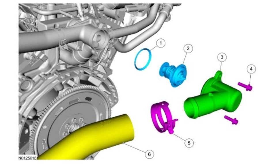

Car has both hot and cold air blowing out. No noise from dash. Fan speed does adjust. The climate control does not control. Heat has to stay on high setting to blow heat. (Hot) and A/C needs to be on lowest setting and blows out cold. All vents blow out same temperature. I don’t believe it’s the blend door. Any help would be great. Thank you.
Jan 27, 2021 at 8:08 PM
Good morning,
I would start by replacing the thermostat as the coolant may not be getting hot enough for heat at all times.
The other possibility is the heater core may be clogged. I would remove both hoses from the core under the hood and flush the core with a garden hose back and forth several times to get all the dirt and debris out of the core.

1. Drain the cooling system. Refer to Cooling System Draining, Filling and Bleeding .
2. Remove the ACL (Air Cleaner) outlet pipe. REFER to Fuel Delivery and Air Induction, Intake Air System Components - Exploded View .
3. Remove the 2 bolts and position the coolant inlet connection aside.
4. Remove the thermostat and the O-ring seal.
Discard the O-ring seal.

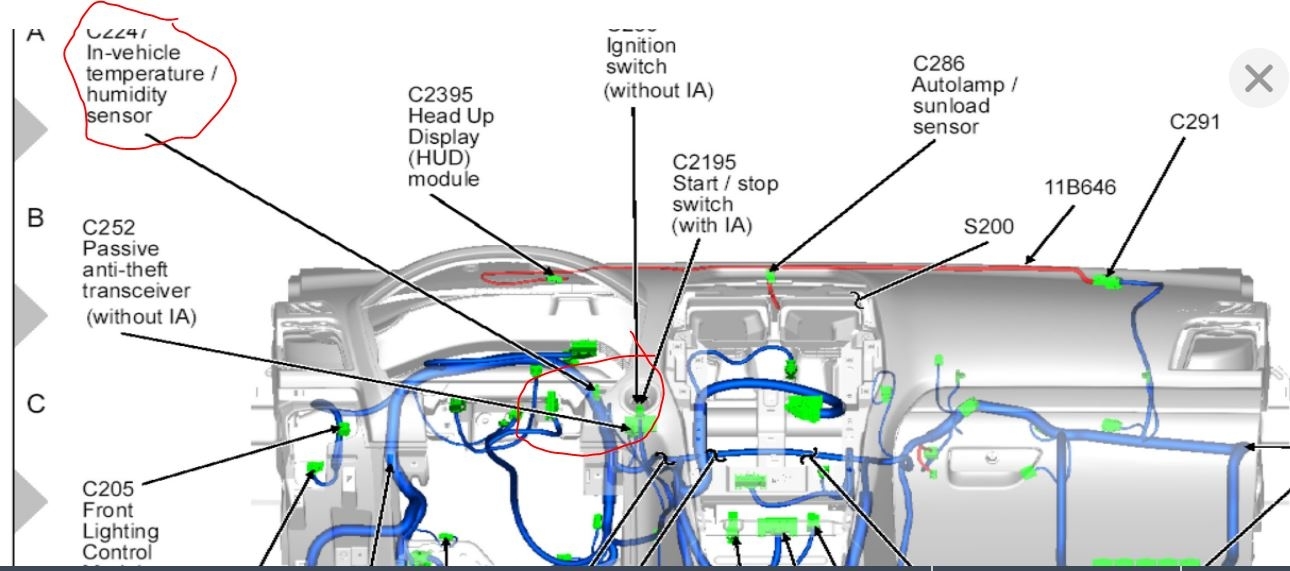

Thank you. Someone did tell me to replace the thermostat and I did. The hot air is hot and cold is cold. The climate control settings just don’t adjust the temperature, stays at extremes.
Jan 29, 2021 at 9:14 PM

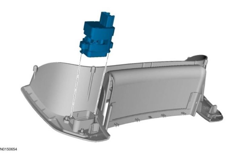

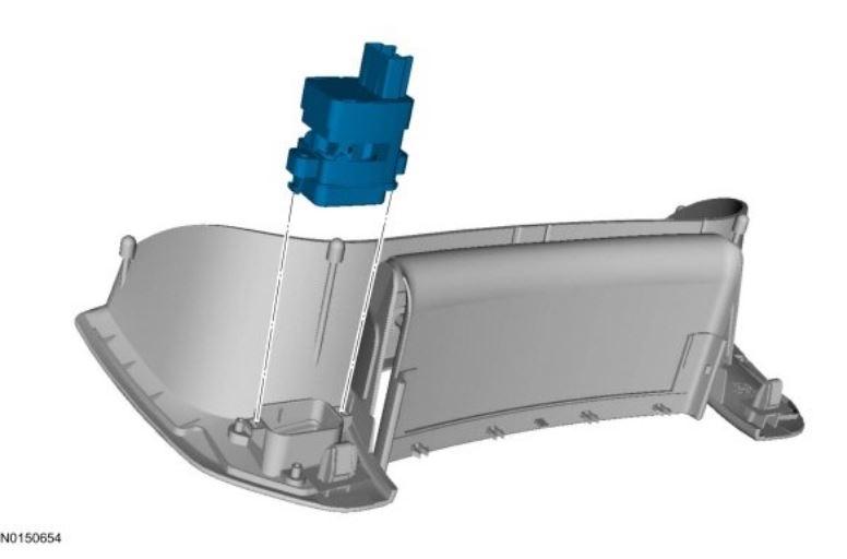

There is an in-car temperature sensor that sends a signal to the climate control module to adjust the temperature to the settings you request and maintain that temperature.
I attached the procedure and location for you below.
Removal
1. Remove the instrument cluster finish panel. Refer to Instrument Cluster/Carrier and/or Interior Moulding / Trim, Instrument Cluster Finish Panel .
2. Detach the in-vehicle temperature sensor from the instrument cluster finish panel and remove the in-vehicle temperature sensor.
