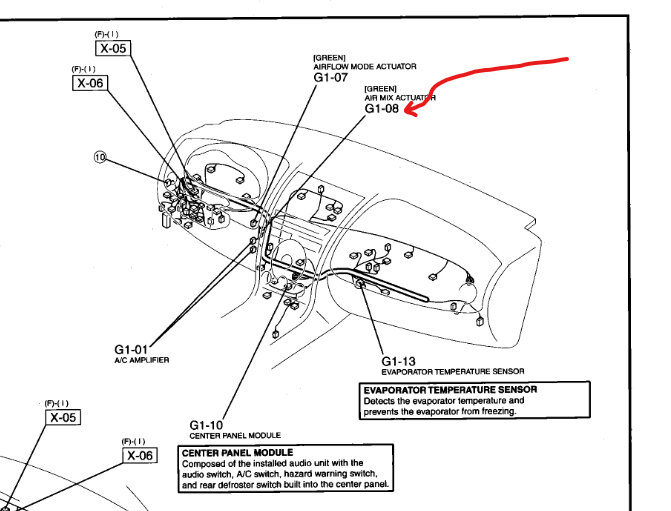

I try to use my A/C and heat and the fan blows but only blows in the temperature that’s outside. It’s like it doesn’t want to blow heat in winter and doesn’t want to blow air in the summer. It gets annoying and my glass stays fogged up because I get no heat in the winter.

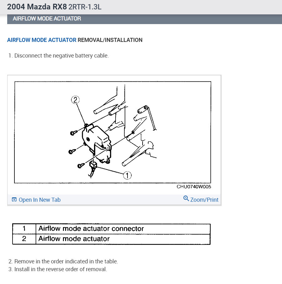

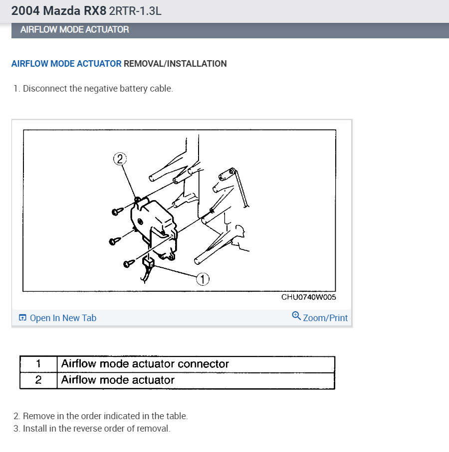

This happens when the air mix door actuator stops working. here is the location and how to replace it in the images below. Check out the images (below). Please let us know if you need anything else to get the problem fixed.
