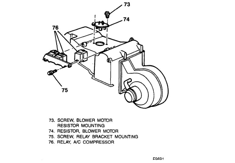

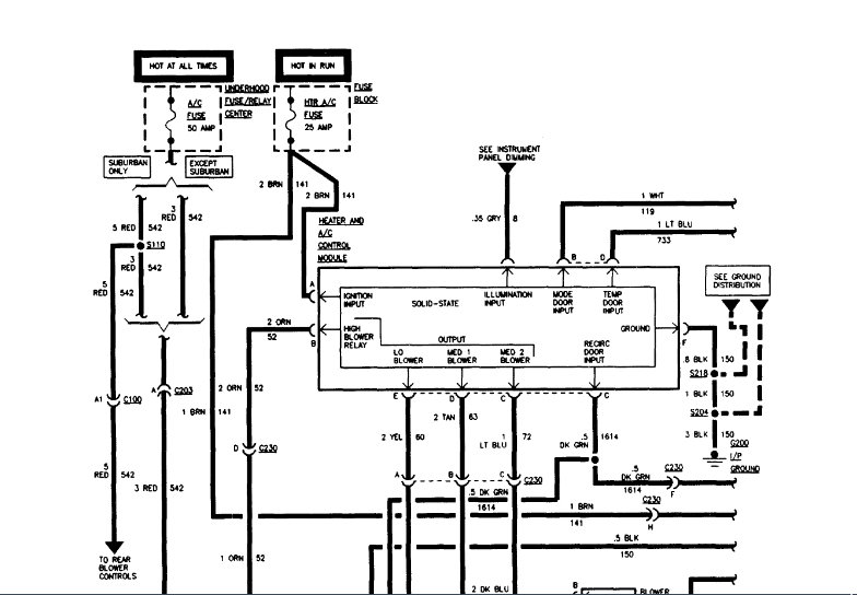

Blower quit working.
Dec 25, 2018 at 11:39 PM
Good morning,
I would suspect a couple of things. The blower motor and the blower resistor are common failures for this but must be confirmed.
I would start by checking all the fuses for power on both sides with the key on. I attached a wire diagram for you to view and the fuses that need to be checked.
Beyond that, either the blower motor or the resistor may be the failure. check for power to the blower in the high position.

Thanks for information. Will be a couple of hours before I can look at it again.
Dec 27, 2018 at 9:04 AM
DANNY SENKOFF
Thanks installed new resistor working good.
