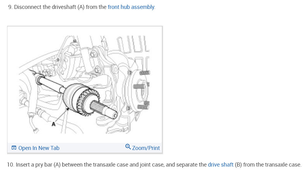

Hi, What could that be? I've read that it can be CV axle, but which one? It doesn't make the noise when I turn left, only when I turn right. If it is a CV axle problem, how much should that cost to replace, and can I replace it myself or do I need to have it professionally done?
Jun 27, 2022 at 1:20 AM
  • 55,402 POSTS

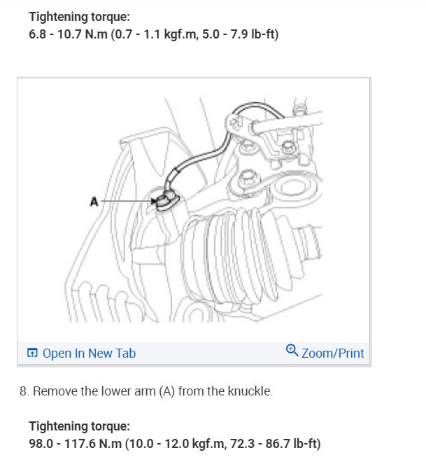

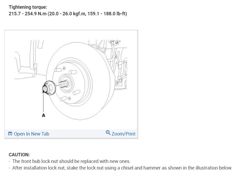

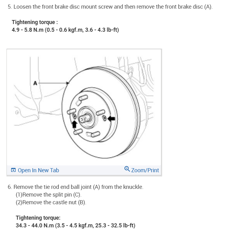

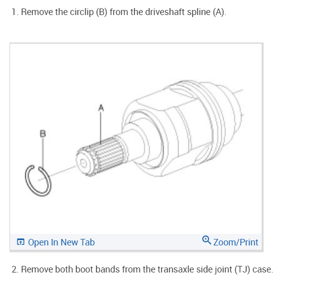

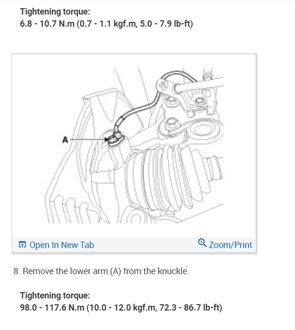

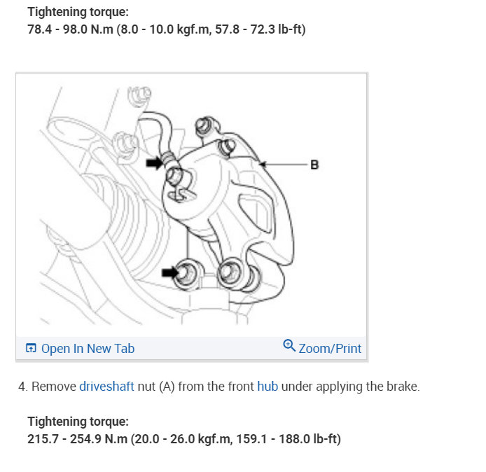

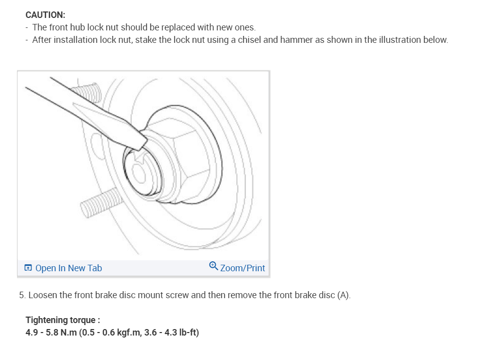

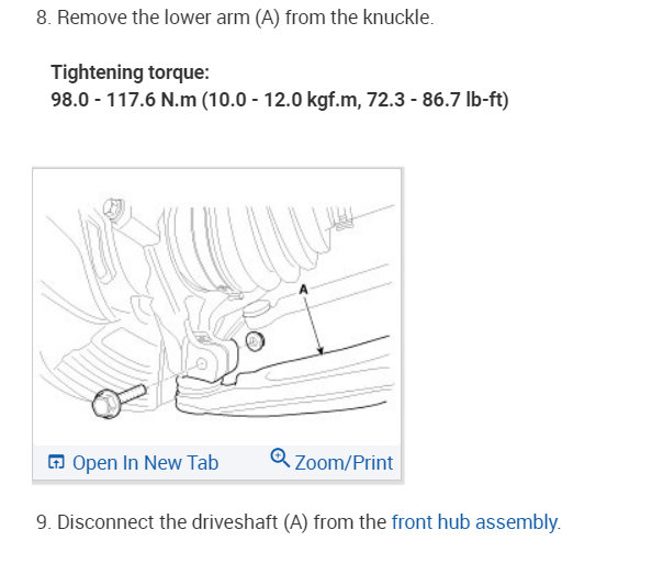

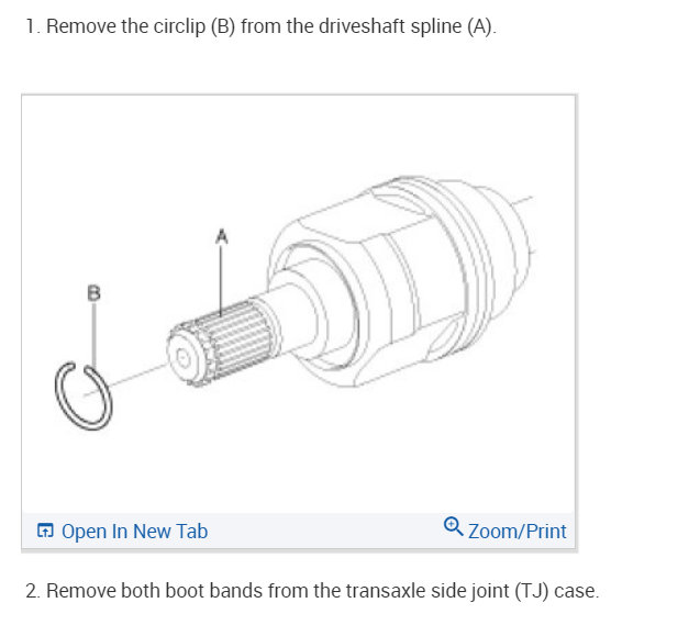

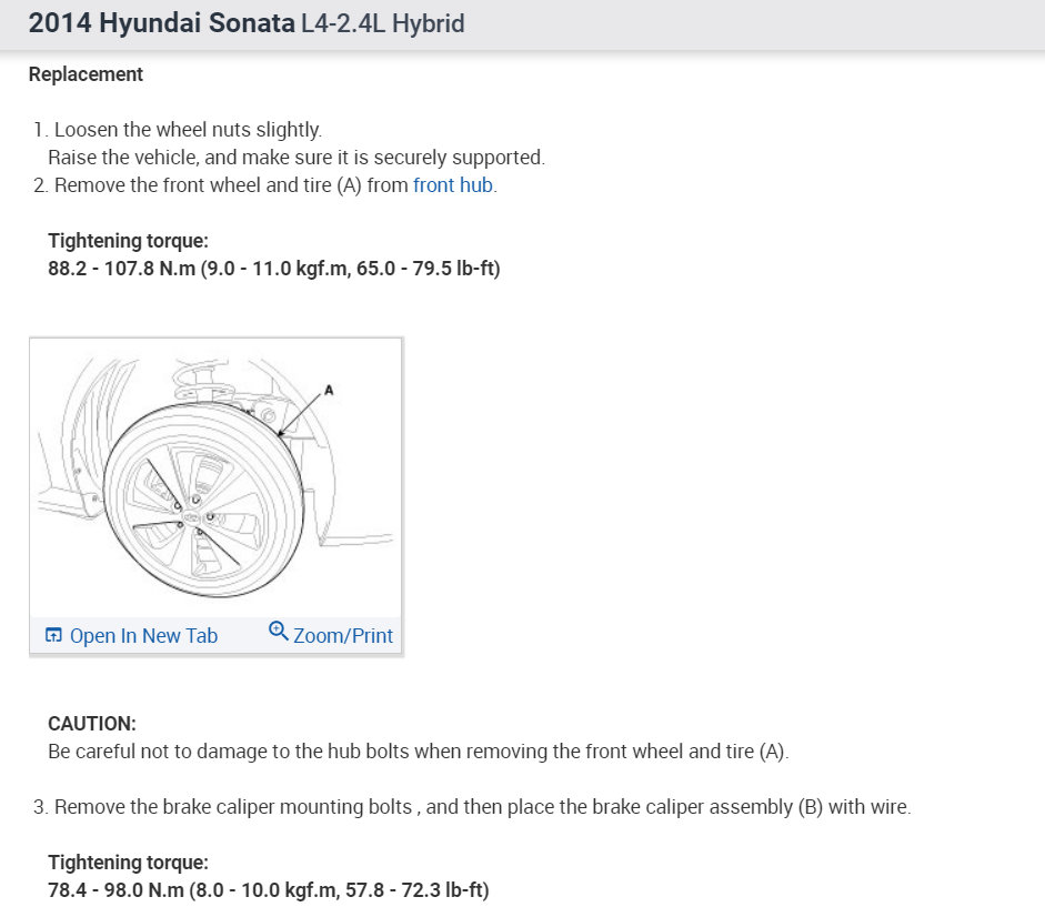

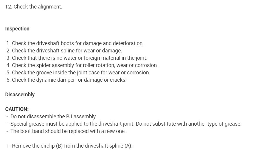

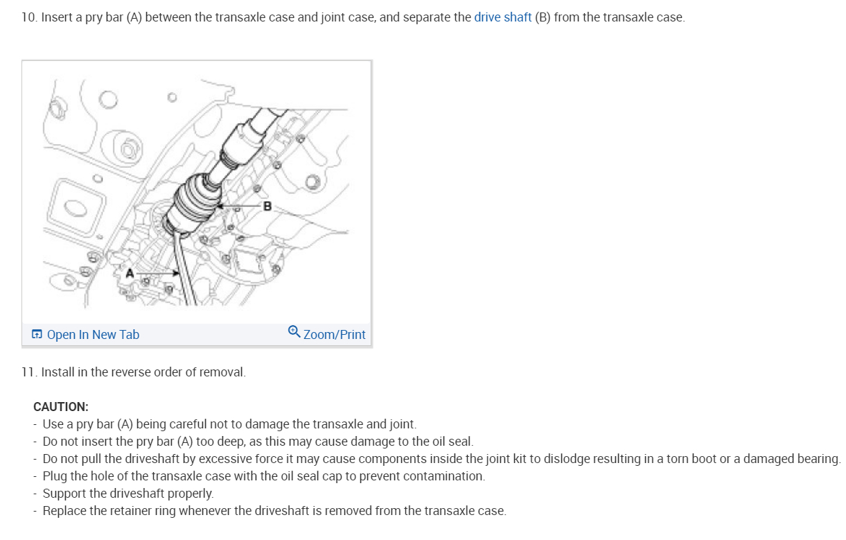

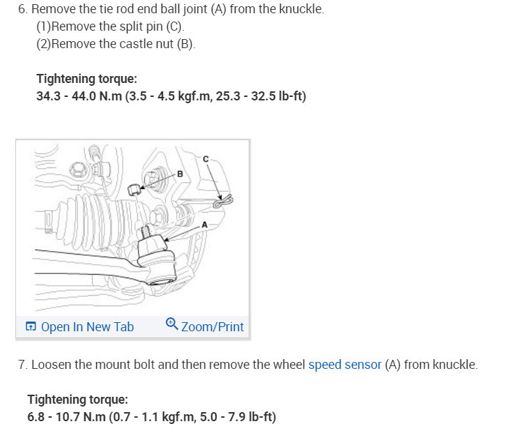

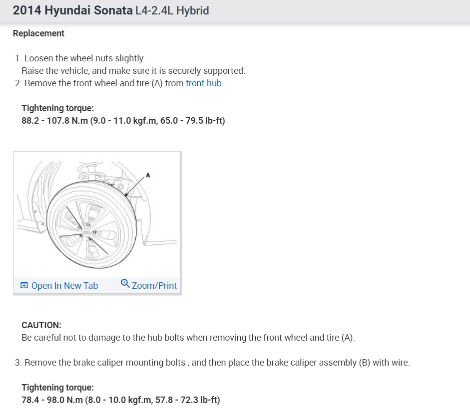

It does sound like the right CV axle is bad because it has to turn the most when in a right turn. Here is a generic guide on how to change out the CV axle with specific instructions in the diagrams below to show you how on your car:
https://www.2carpros.com/articles/replace-cv-axle
