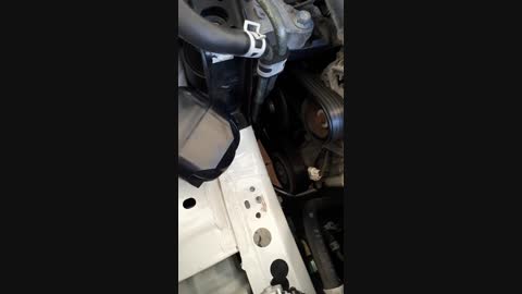

What I need you to do is locate the AC compressor. It is one of the belt driven accessories. I added a picture of one so you can see what it looks like. Now, here is what you need to pay attention to. With the engine running, locate the compressor and pay attention to the center portion of the pulley which is driven by the belt. When you hear the click, see if the center starts spinning or if it stops spinning. I know that sounds crazy, but there is an electric clutch that locks the center portion so it turns the compressor. When it is disengages, the outside will continue spinning and the center will stop.
Try to do that using a flash light to see. Just keep away from the moving parts.

The centre stops spinning and then starts again when the click happens. I've included a video.

Okay, that is the compressor for sure making the noise. When it engages, it does put a load on the engine. However, there is a thing called a stepper motor that should increase the idle speed so you don't notice the change very much. If the engine isn't stalling but the RPM's are lowering, that is normal. However, it should not stall the engine.
Don't be alarmed by the clicking sound. That is normal. There is an electromagnet that receives power and quickly engages the compressor. Because the magnet is both strong and quick, you hear the click. Also, if you hear it with the defroster on, don't be alarmed. The system is designed to engage the AC compressor to help dehumidify the air entering the vehicle to defrost the glass quicker, so it will turn on and off then, too.
I didn't see your other link. If you can, copy and paste the link for me and I'll look at it for you.
For this issue, if the RPM are slightly dropping, it's normal. If that changes and the engine begins to stall or you hear a loud squealing noise when the compressor engages, let me know and I help you get it fixed.
