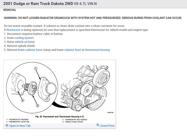

Good evening, and to start I appreciate your help in this matter. So, this is going to be a lengthy and most likely confusing explanation of what's going on, but I will more than happily clarify any confusion if you ask, I have the vehicle listed above that I recently just did a full tune up on as well as the thermostat and the radiator on. The problem started right after doing the thermostat in the radiator which led me to do the tune-up thinking maybe it was just a bad spark plug or coil pack. Neither of those turned out to be the case. So, the noise happened after doing the radiator and the thermostat but before doing the tune-up just to be clear. So, I have a chug that occurs and climbs to a ticking or clicking as I accelerate keeping up with the rate of acceleration at idle it's more of a consistent low chug that grows worse when I turn on the A/C. The problem was not there before I did the radiator, but man is driving me nuts now. I guess to not essentially what I'm asking is if I did something wrong and installing that thermostat could it possibly be making a clicking noise under acceleration.

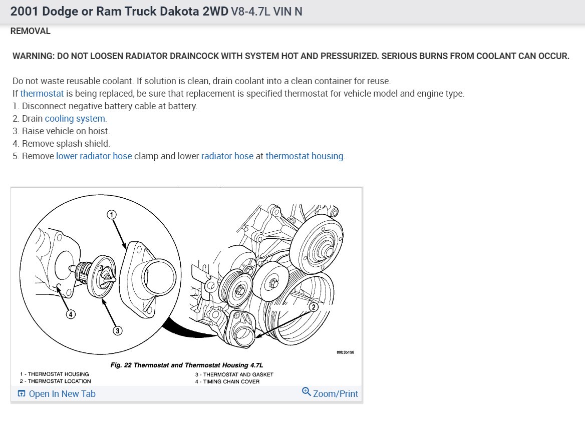

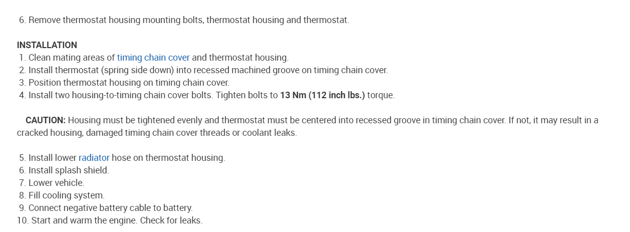

It sounds like it could be the radiator cooling fan barely touching the fan shroud. Can you please shoot a quick video with your phone so I can hear the noise? That way I can tell for sure what's going on. You can upload it here with your response. Please make sure nothing is hitting the cooling fan. The thermostat itself can make noise unless it is installed backwards, then the engine will pop and tick due to excessive heat. Here is a guide to show you the direction the thermostat should be installed:

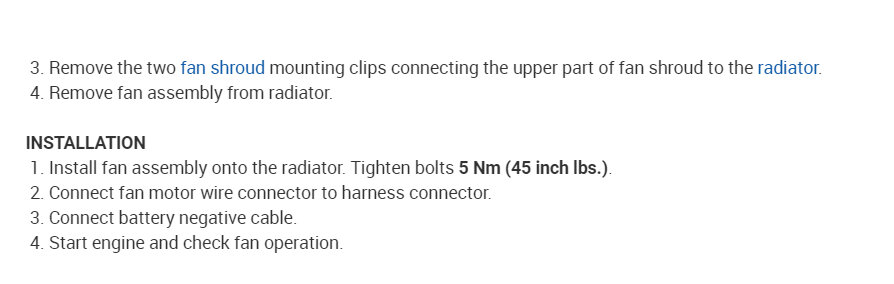

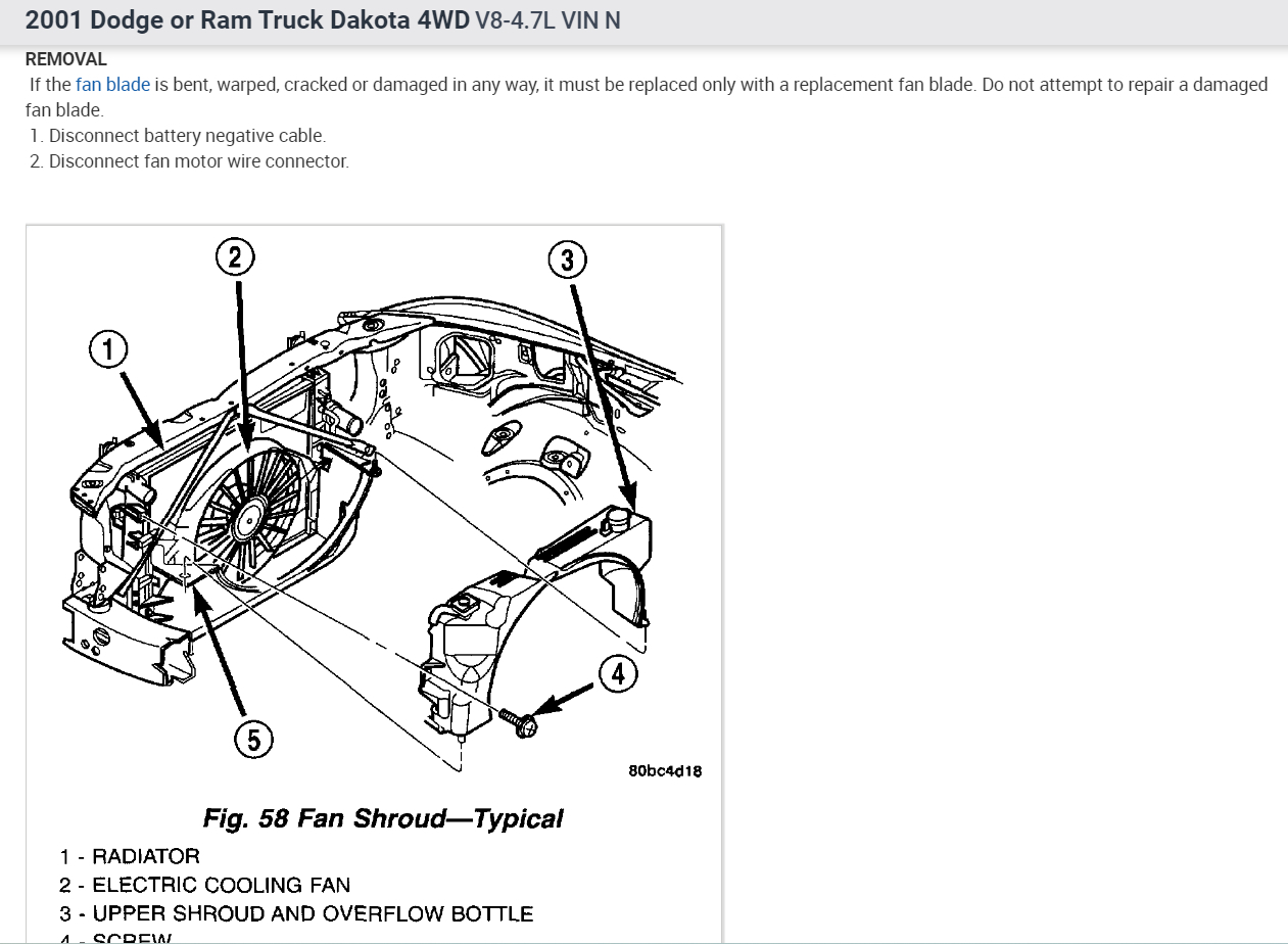

This truck has an electric cooling fan, correct? I have seen them make a clicking noise when they go bad, and this can make the engine overheat. Here is how to change it out in case you need it. Check out the images (below). Please let us know how it goes.
Jul 13, 2023 at 2:34 AM
