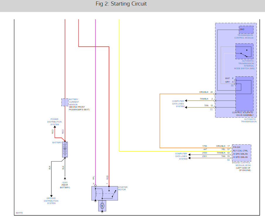

New battery, starter tested good two different stores, power to big bolt no power to small connector when key turn to run position.
Nov 7, 2022 at 11:13 PM
  • 55,433 POSTS

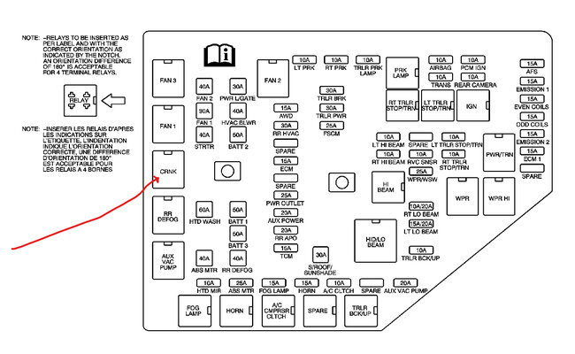

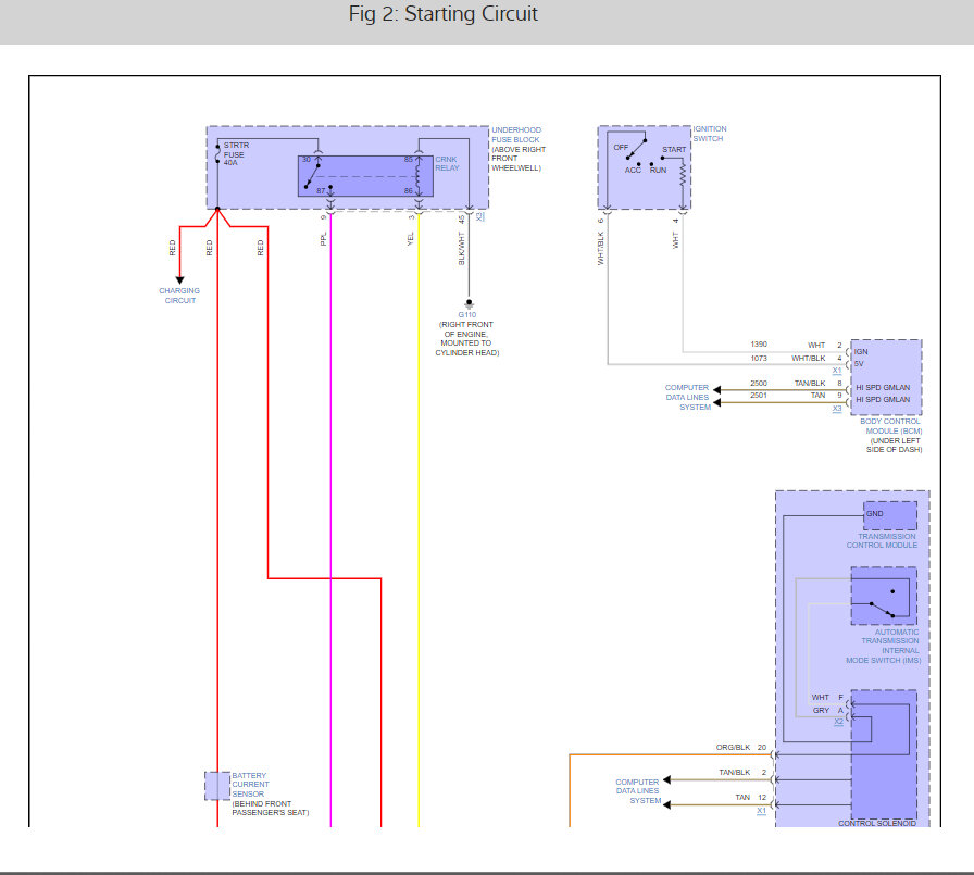

Thank you for letting us know what you have tests it helps, here is the wiring diagram for the starter and it looks like there is a relay that needs to be tested or swapped out.
Here is the location of the relay and a guide to help test it:
Also try the starter when the car is in neutral, this will rule out the gear range sensor. Check out the images (below). Please let us know what happens.
Nov 8, 2022 at 12:58 AM
JROC1298
Hey, thanks for the response. It was ground wire off. Now it crank but won't start, check to see if it's fuel it was I think it's the spark.
