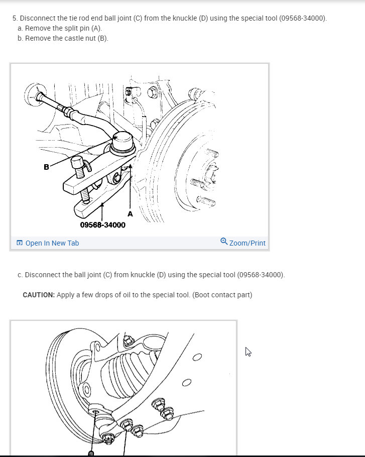

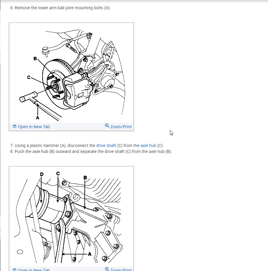

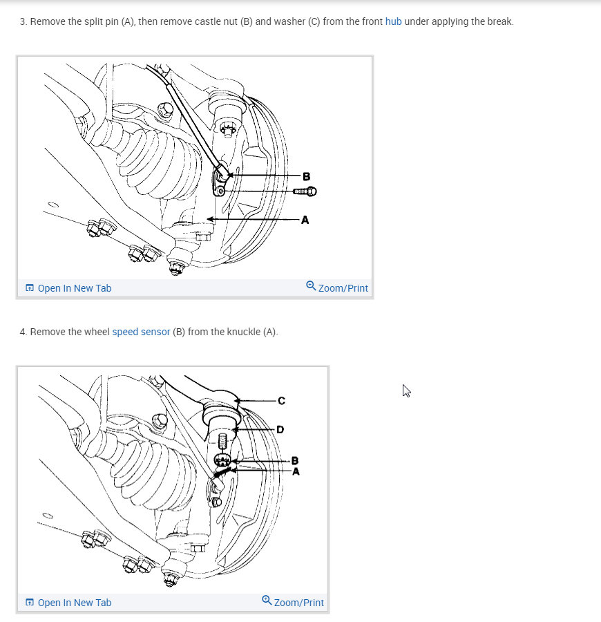

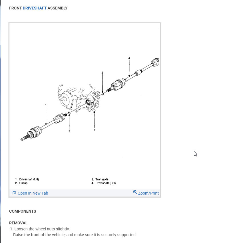

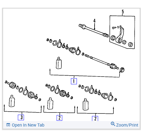

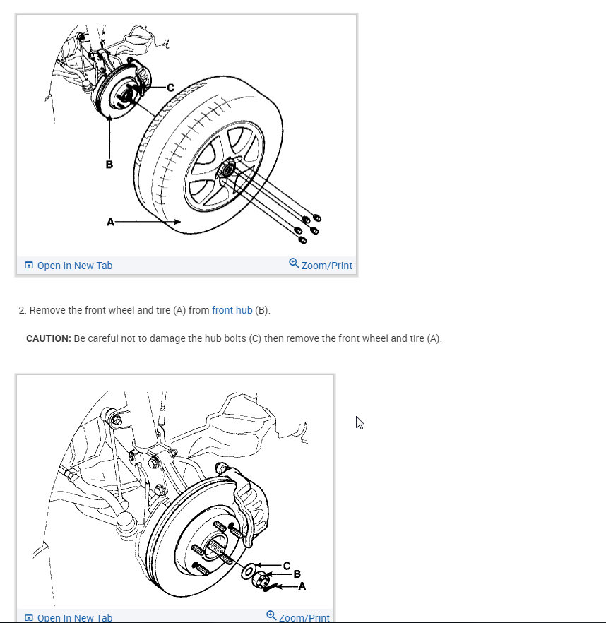

When taking off from stop or turning a metal clanking sound in front by tire happens.
Nov 1, 2019 at 4:48 AM

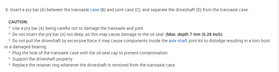

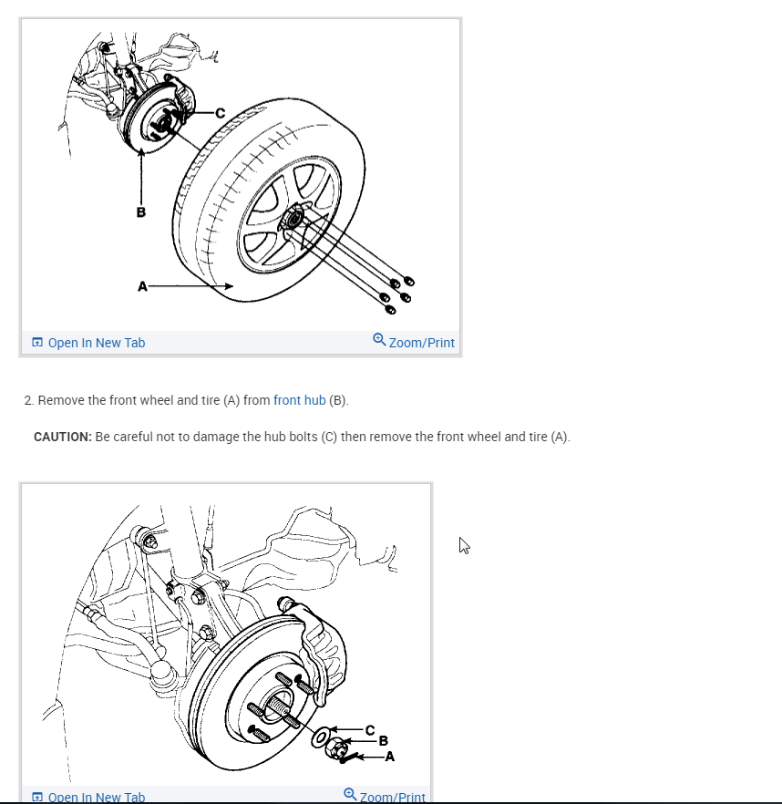

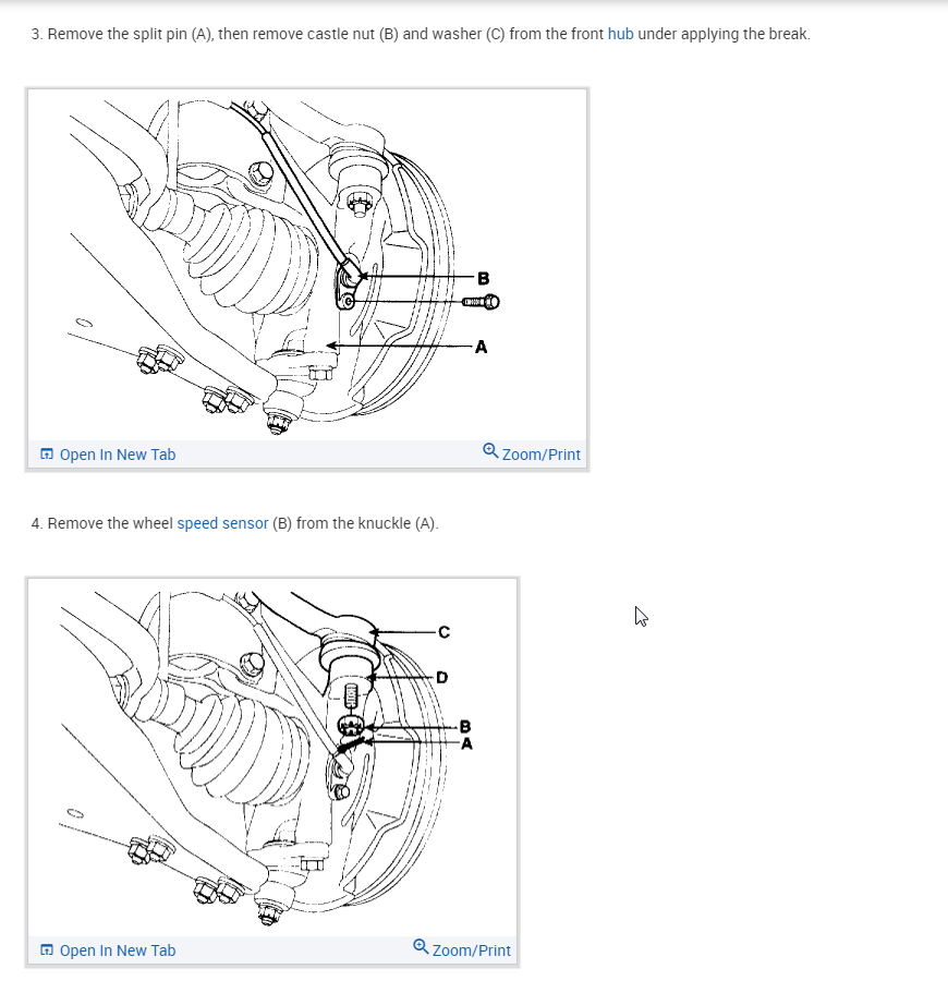

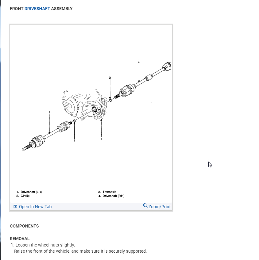

This could be a number of things. Does this happen when turning either direction or only one? Also, can you hear it from both sides? Can you get a recording of the noise because that can help us identify it.
Do you feel it in the steering wheel or do you feel it anywhere?
Based on this information, I suspect this issue is the axle shafts but again this additional information will help.
If I am correct the procedure to replace them is attached. Thanks
