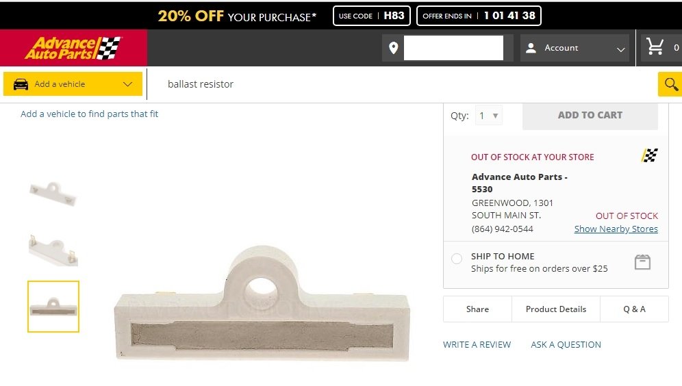

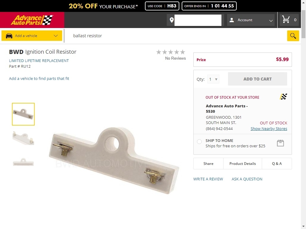

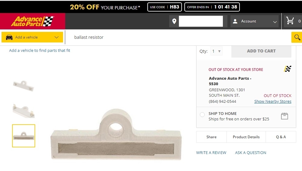

Many are open in the back and the coil is exposed, water dirt, and bouncing around will shock the little coil and cause it to break or burn in half.
Below are two screenshots of the same ballast resistor (front and rear views). Notice how on this particular one they have filled the trough with ceramic material. This really helps out on the life of the device.
As another "Get me back in" trick if you experience Ballast resistor failure is to "temporarily" Jump the terminals with a jumper wire, lay and tape a metal object over the terminals, or simply snatch both wires off of it and tape the "females" together. This will get you "in", replace it as soon as you can to avoid other ignition problems.
