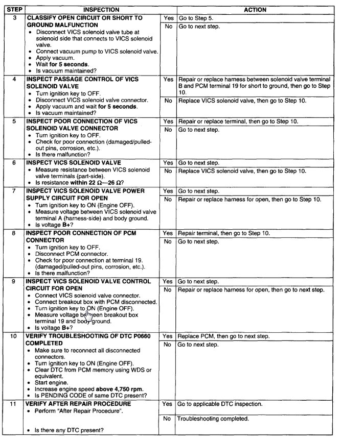

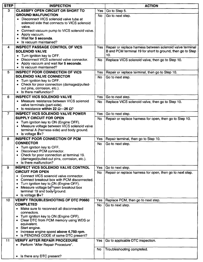

Here is the test that you need to run through in order to determine what the issue is. Do you know what wire was broken? IF we can relate it to this system then just fixing that may resolve the issue.

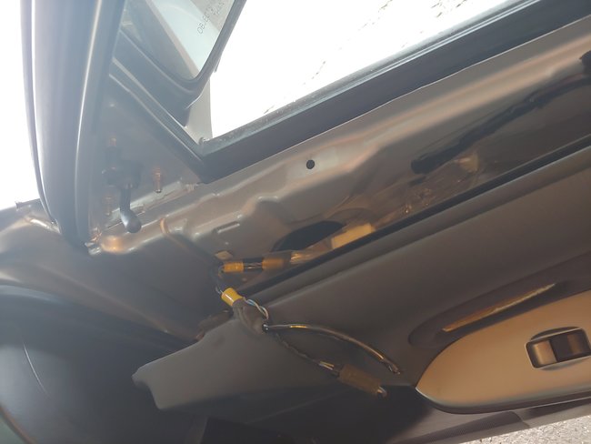

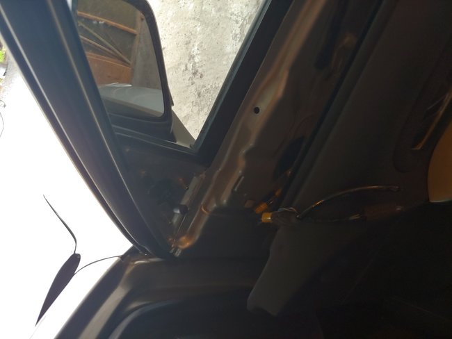

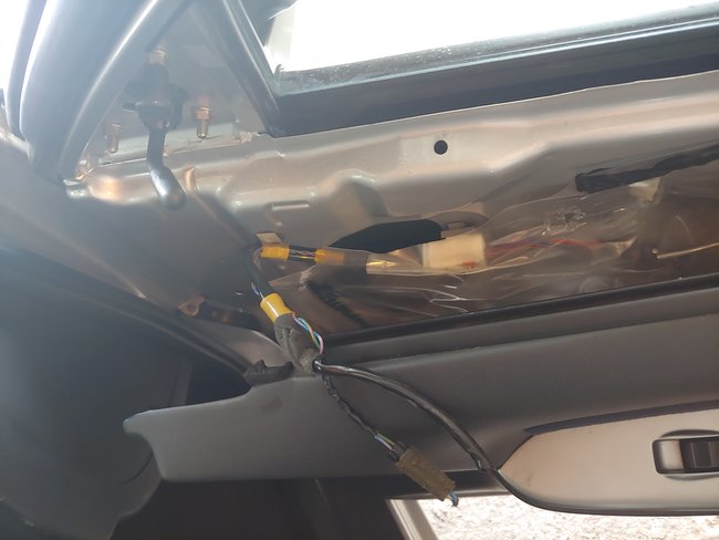

So I removed the passenger door panel again. I took a picture of the wiring that is right below the passenger side mirror. It has been clearly cut but not sure if this is the issue. Please let me know if you need further pictures.

Can you take the VIN and go to a dealer and ask them to run the options on it? This looks like it went to the mirror like you had power mirrors and someone got rid of them by just cutting the wires.

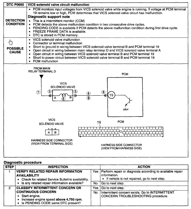

However, based on this I would not think this is related to your check engine light. That code was for the VICS solenoid. Basically, this route intake air through the intake to better manage fuel ratio.
