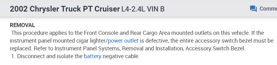

Fuse good. Need to know how to remove lighter/outlet to then repair/replace it.

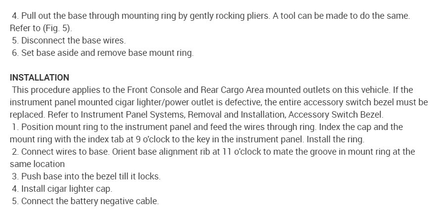

Here is the information you requested.Here is a tutorial showing how to test wiring:
I've attached picture directions for you PT Cruiser below.Hope this helps and thanks for using 2CarPros.

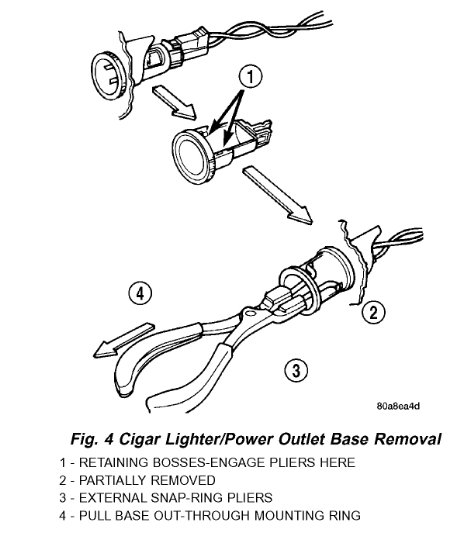

The picture instructions were for the removal of the cigarette lighter outlets for your PT Cruiser in the above post.If you have any further questions when attempting the repair let me know.Hope this helps and thanks again for using 2CarPros.

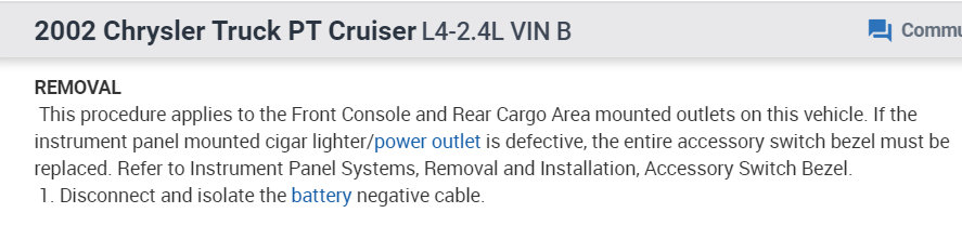

The first thing to do is make sure the battery negative terminal is disconnected. There is power to this component at all times and placing anything metal (tool) in it will cause a short.

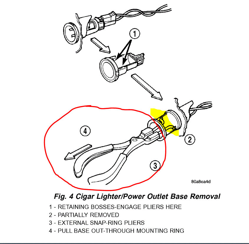

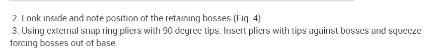

Okay, if you look at pic 1, I circled what are called snap ring pliers. They are very inexpensive and often times a parts store will lend them to you. What you need to do is look inside and locate what the pic refers to as retaining bosses. With the snap ring pliers, gently depress the bosses and wiggle the power outlet out of the instrument panel.
At the end of the outlet will be a wire and connector. Simply disconnect that wire from the outlet and attach it to the new outlet and reverse the procedure. Just make sure when you install the outlet that it will align with the bosses again and reattach.

Okay, I got the pliers all ready but there's another problem. The gear shift is in the way of getting the pliers in there. Now what?

Are you able to shift it to drive and have access?
