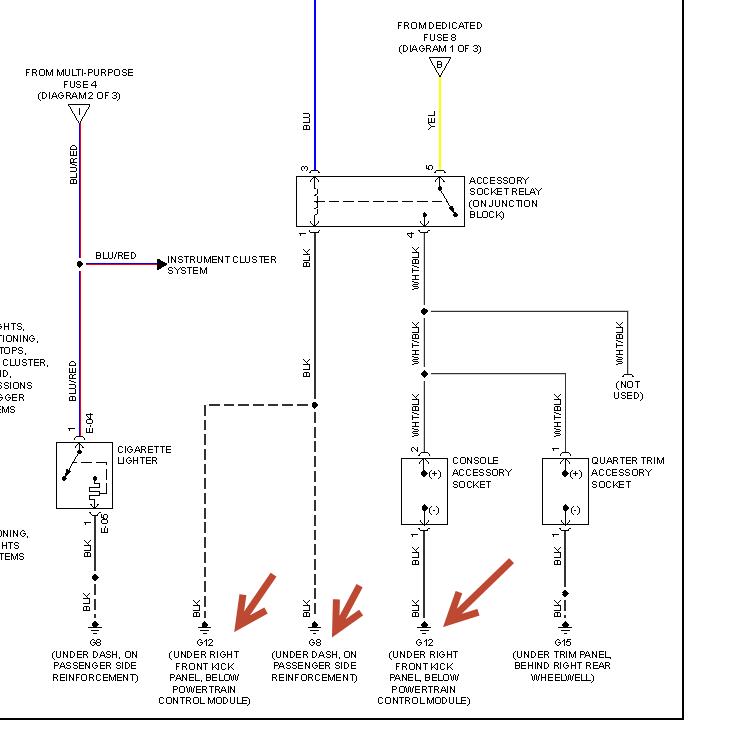

All 3 of my electrical sockets (cigar lighter, centre console and rear luggage compartment) have stopped working. I have checked all the fuses under the bonnet and the ones partly hidden behind the right hand plastic trim in the drivers foot well and they all seem okay.
Are there any other hidden fuses or could this be a relay issue?
In either case I would appreciate some guidance to correct the fault.
I do not have a handbook as this was a secondhand sale purchase. I have looked on the web and haven't managed to locate an online copy or even one to purchase by surface mail ( I relocated to Cyprus after buying the car).

check the grounds first as I hav epointed out as the relay for the two ground there this is off a a mit Montero which is same as a shogun in uk. see pic. it is fuse 4 under dash for one and fuse 8 underhood for other sockets.
